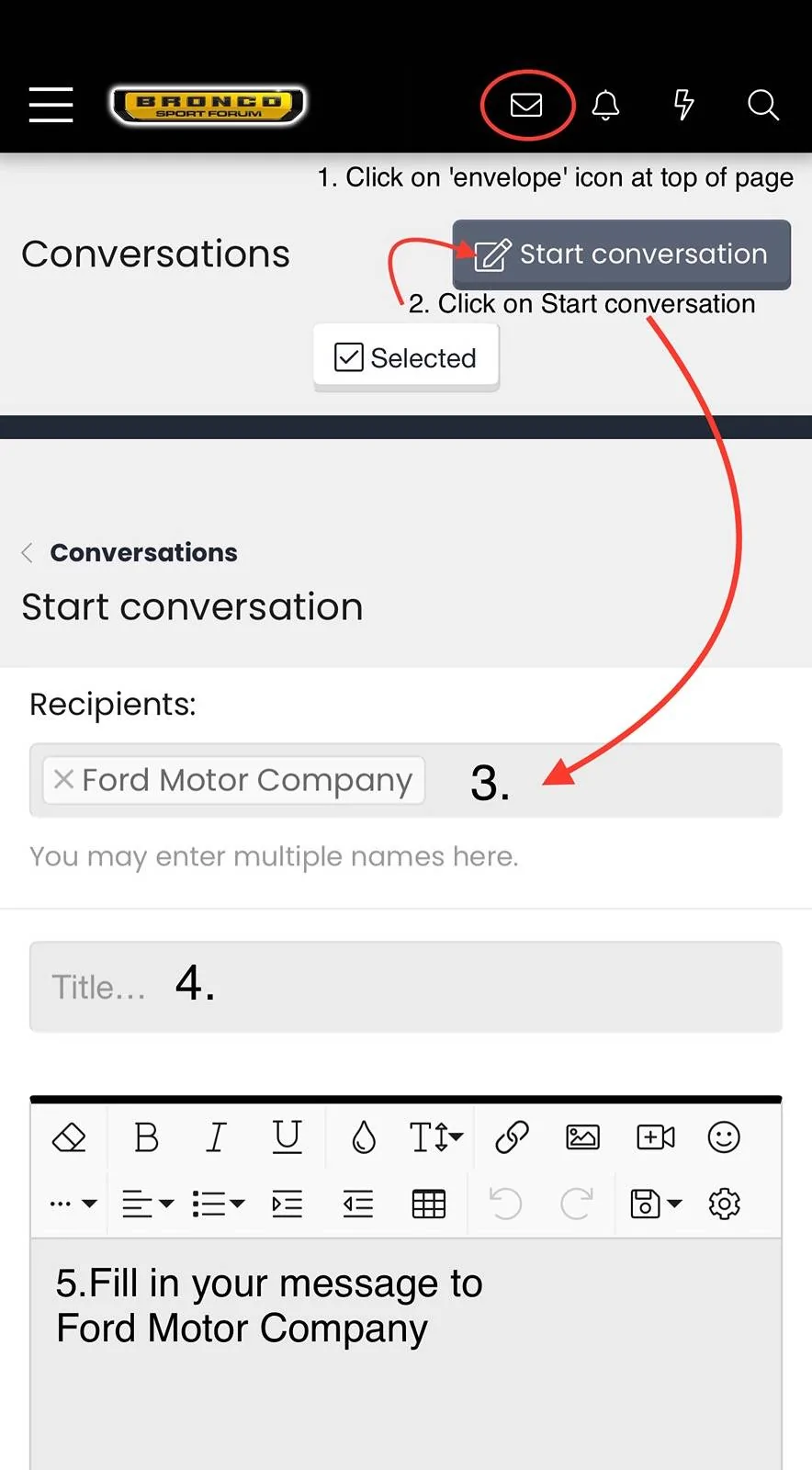

@RRit50 .. Recommend you delete your post with your VIN and send the same message via a private message (to Ford Motor Company.. do you know how to send a private message on this Forum?)
RRit50
Ron
Apr 20, 2024
Allegan Mi
Bronco
No, could use some help
