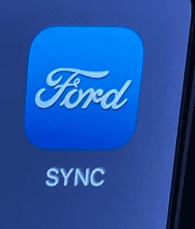

on AA find the button that looks like this and it will return you to Sync

Thanks. That helps although takes a few clicks just to get to the icons list to find it. Kinda wish they just had a small button right on the main screen, or one of the physical buttons would just act as a toggle. But better than nothing.

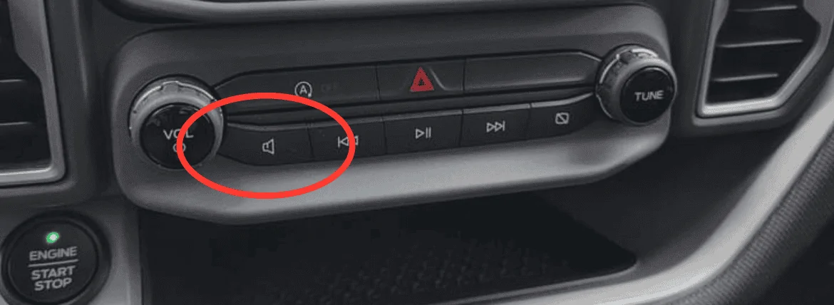

Try this and see if it works for AA (I use CarPlay)…
Bring up AA.
Launch Google maps using AA and navigate someplace.
Press the “speaker” button below the 8” Display:
Ford Bronco Sport Sync 3 1687724495833
That will take you to Settings on the 8” Display then press Audio button and tune to your favorite station

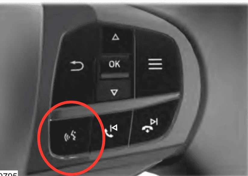

Now to temporarily get back to Google maps, press this button in the controls on the right side of steering wheel assuming your vehicle has this button:
Ford Bronco Sport Sync 3 1687724870753
That will bring up google maps (or whatever navigation app you launched in the step earlier) for a few seconds to check your navigation, then reverts back to Sync automatically. Works well for CarPlay but you may need to adjust steps abit for AA.

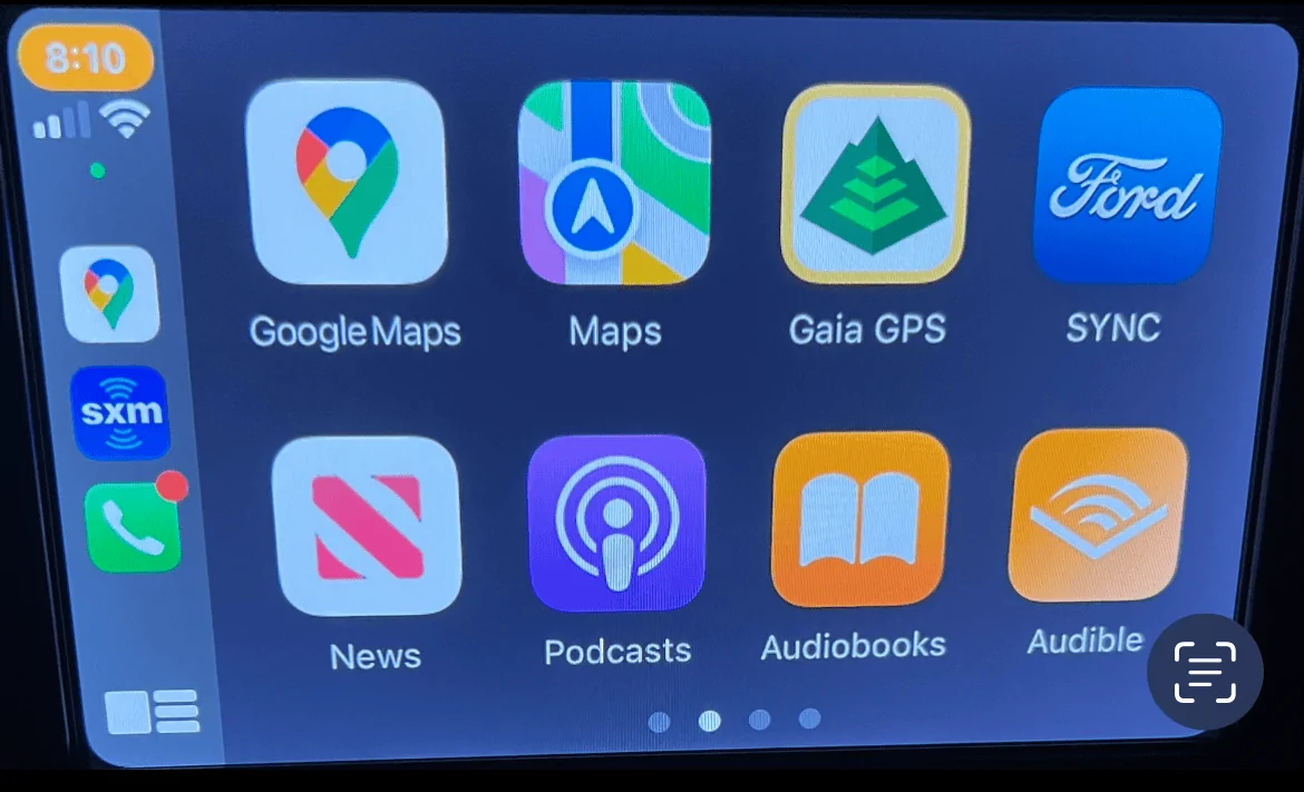

You can rearrange the order of buttons on AA.
My Ford icon is already upper-left so it's as convenient as it can get on that app launcher screen. But I like running AA with full screen maps, and I can't get the Ford icon onto the bottom footer section below that so it's always there. Not sure if that's possible. Looks like AA just puts the last few used AA icons there but not the Ford icon.
To get to the app launcher screen (icon list) I have to hit the lower-left menu icon twice, then the Ford icon. Not a huge deal, but frankly that's a bit more cumbersome than just turning the TUNE knob (can click up one channel them back down to same station real quick) then touching the channel changed message that drops down from the top. That's probably about as easy as it's gonna get unless they allow the Ford button to become one of the those few buttons underneath the map screen.
