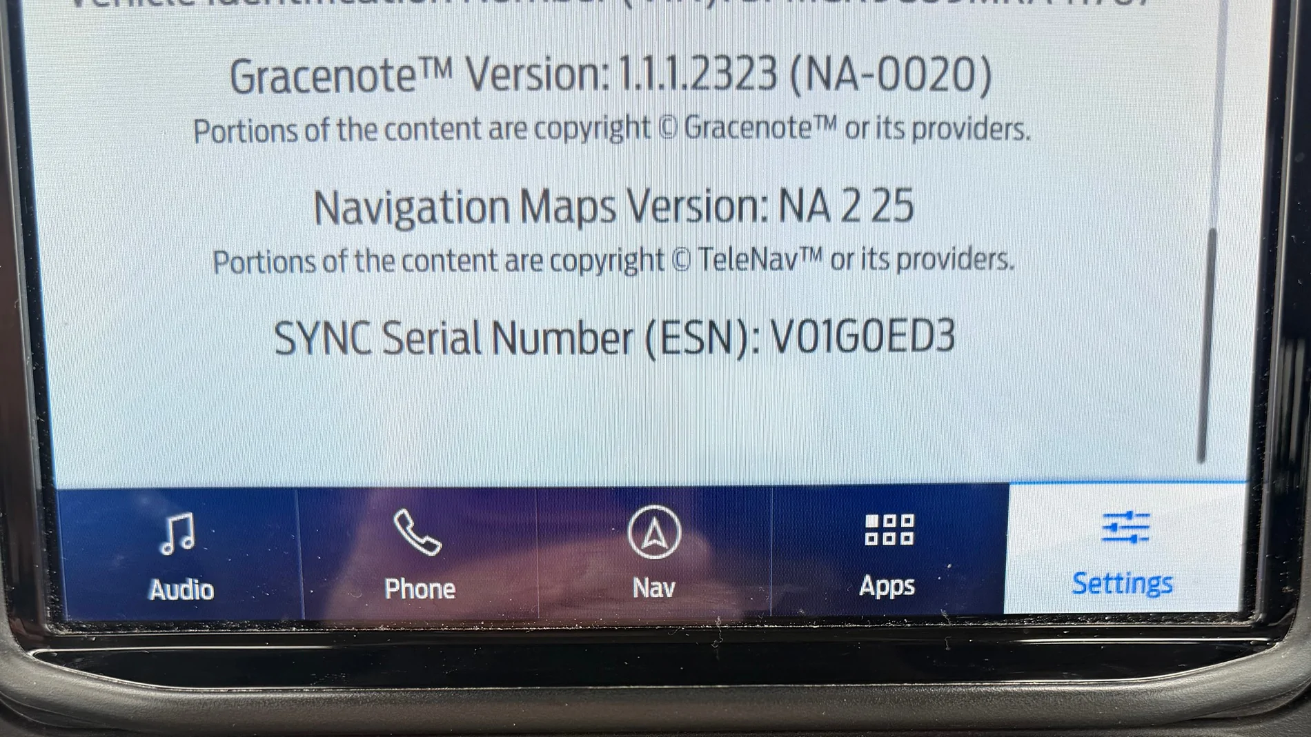

Before updating, make sure you are running Sync 3.4 Build 23188 or higher.
To check:
On center screen
Tap Settings
Scroll left or right to General
Tap General
Scroll down to About SYNC
Tap on About SYNC

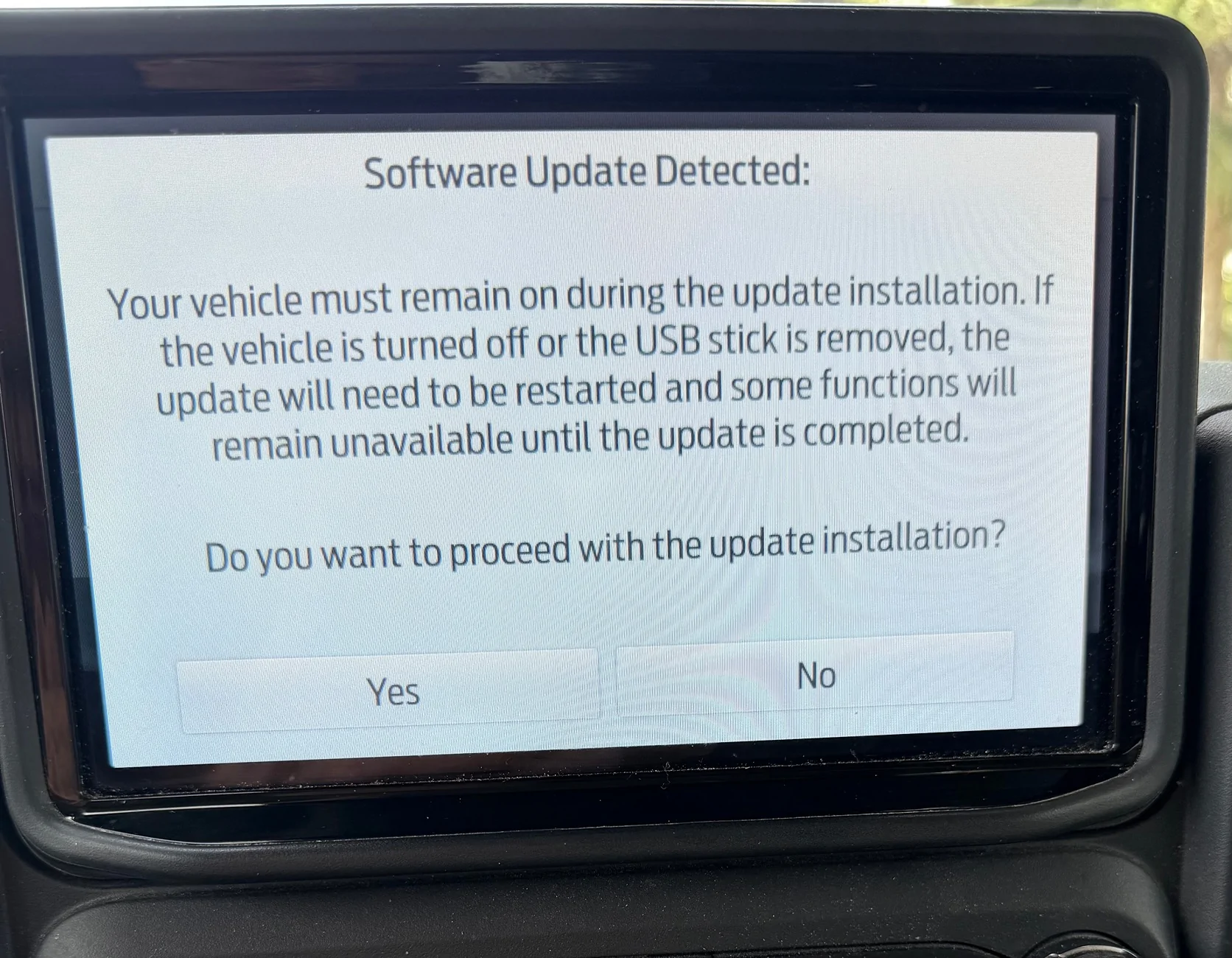

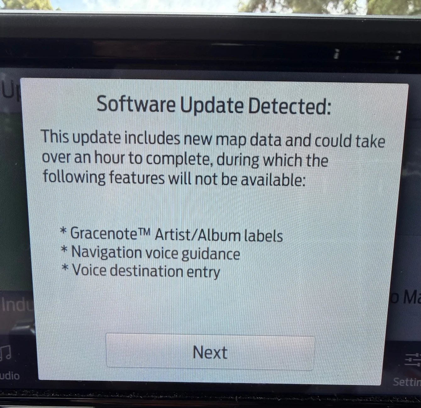

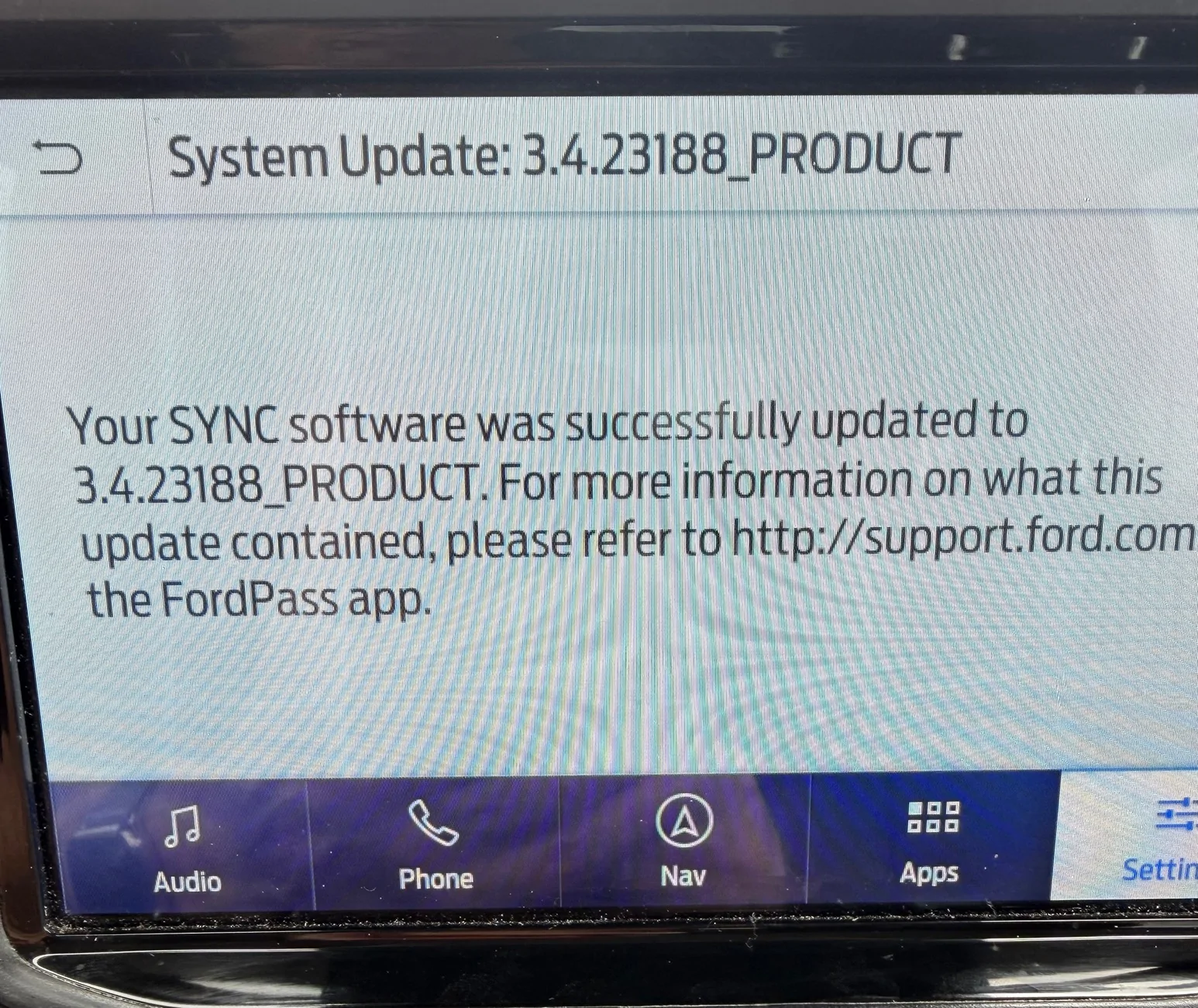

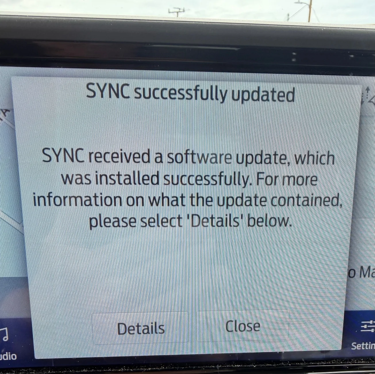

Time to update the vehicle. This may take an additional hour. Mine took 40 minutes. Plan when taking a long drive. The vehicle must be running the entire time.
Remove any USB cables from the ports.

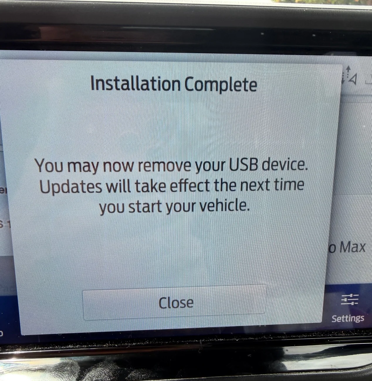

Insert the flash drive in the ports under the climate controls. FOLLOW ON-SCREEN INSTRUCTIONS
Do not remove the flash drive. Do not turn off the engine. Follow on screen instructions.
This may take around an hour to complete. Your vehicle’s screen will restart multiple times. Do not remove the USB flash drive. FOLLOW INSTRUCTIONS.

My Nav Maps are now NA 2 25
