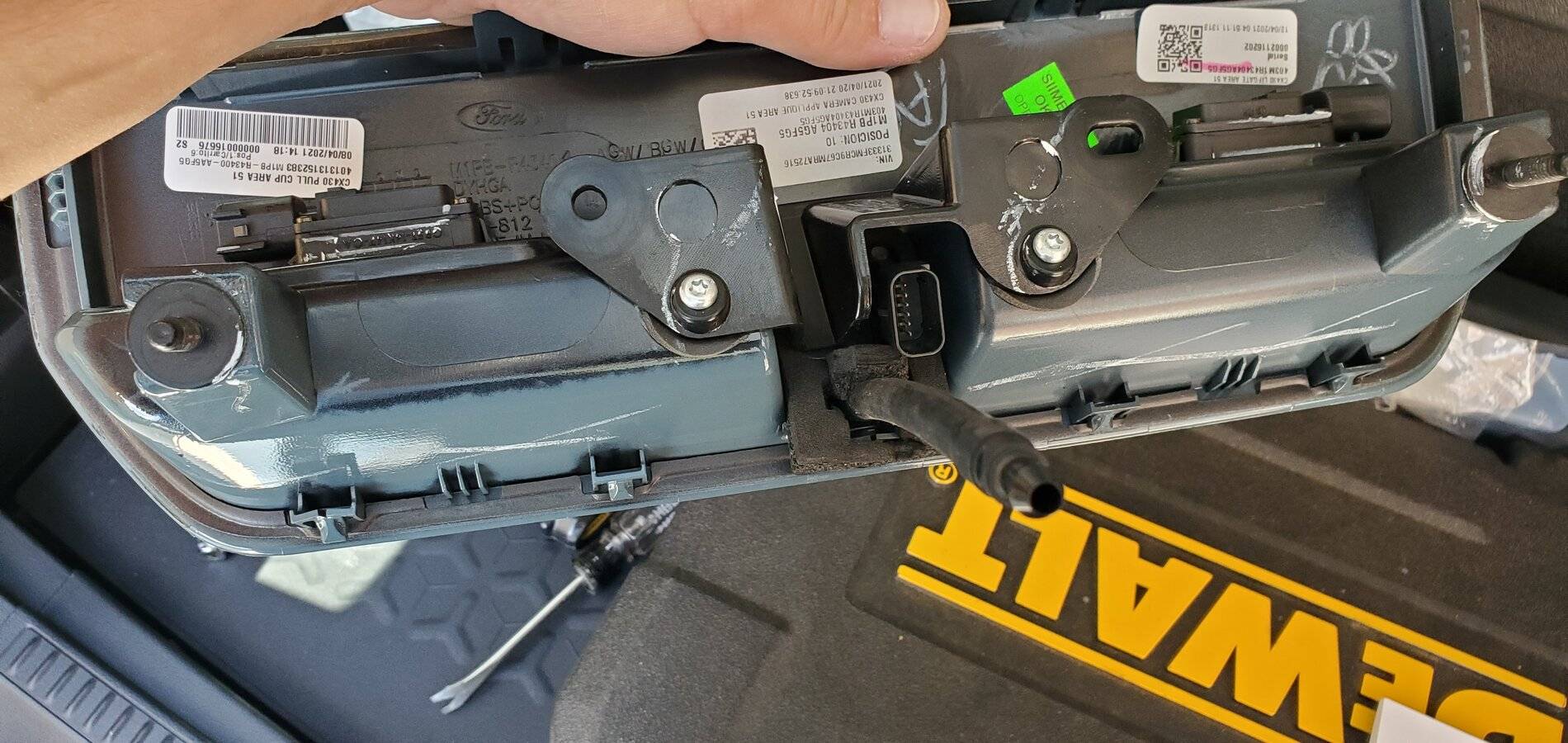

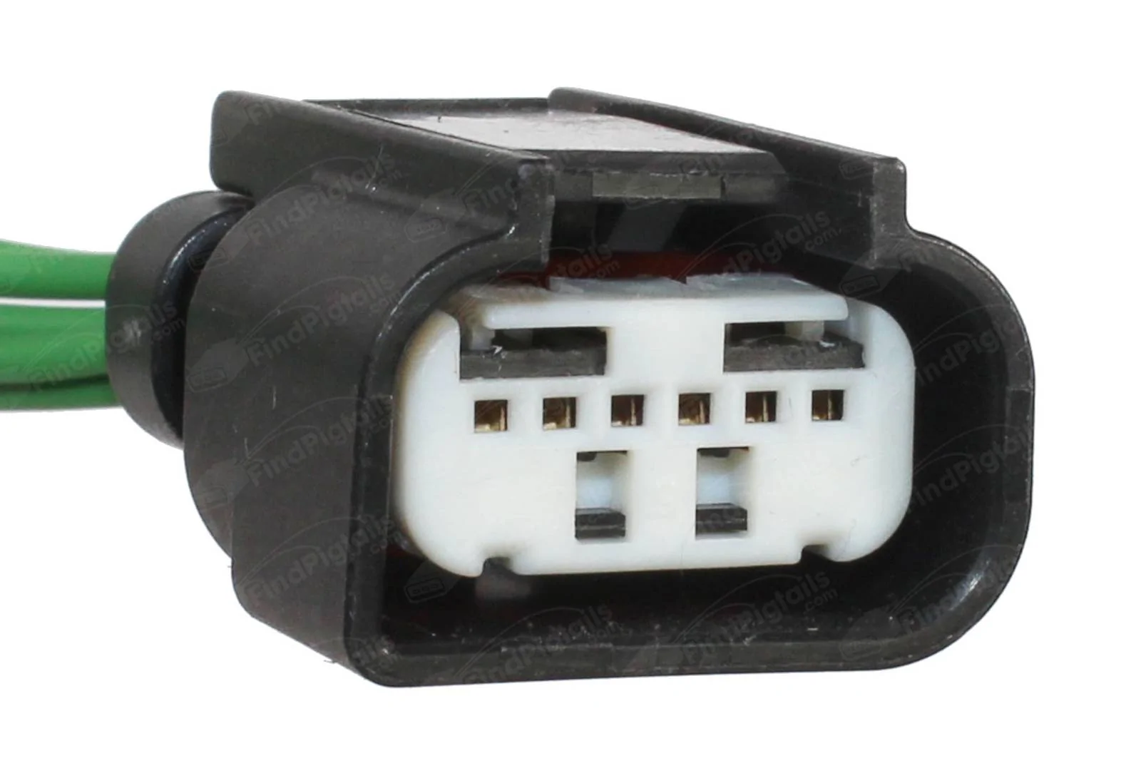

There's a photo in the rear camera washer DIY thread that shows the rear camera connector. It's a single row, six pin connector. You'd need a harness that matches the connector on the camera. All of the Rig'd harness connectors appear to be female, but the camera is male.
Ford Bronco Sport Swing Away Spare: Relocating The Rear Camera 20210730_143923
Image credit: @HugeGuyTheory (from his linked thread, above)
This appears to be the connector that mates with camera, so this is what the relocated camera harness would need to plug in to.
Ford Bronco Sport Swing Away Spare: Relocating The Rear Camera FindPigtails-Connector-SKU-R65B6
I didn’t see it mentioned yet so I thought I would for future reference. That would seem to be wpt1280. Can be found on eBay with and without pre crimped wires for $15.
