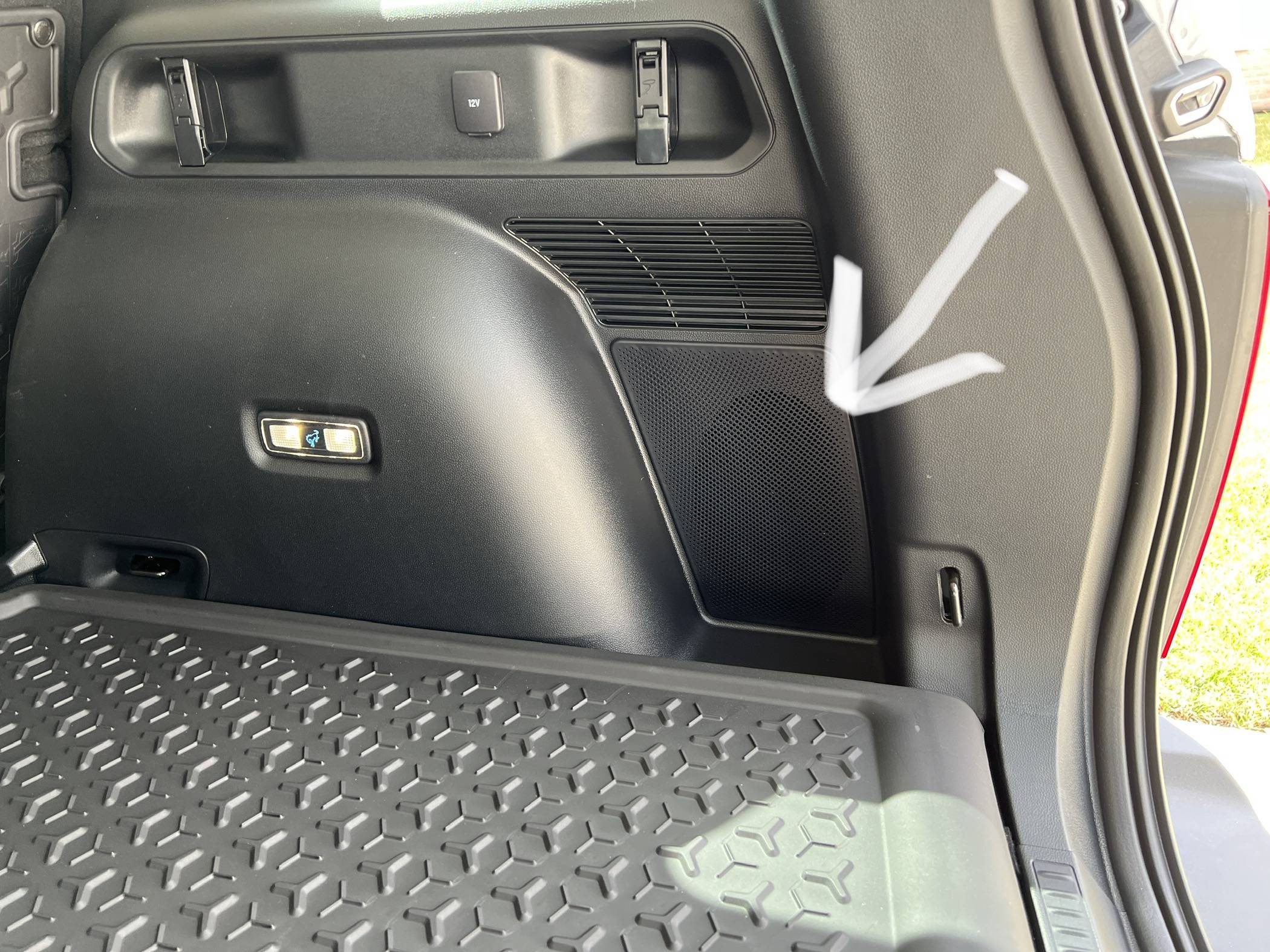

Where is the subwoofer located in the BS? Under the right side passenger seat? I've been trying to figure this out but haven't found much on it. I have the Sony Premium Sound System in my 2014 F150 and love it. When I test drove a base model BS, non premium it was horrible when I tried to turn it up and listen to some tunes. I'm seriously hoping for a better improvement with the B&O system over the base non B&O. But not sure how this would stack up against my Sony Premium sound system.

Even the grill is in the shape of a 6x9. I bet the door speakers aren’t that much different from the “sub”. Is also not a sealed box. It’s basically mounted open air to a speaker mount. So you’re losing bass response since the whole rear quarter is an open air sub box.
Once mine comes in, I’ll pull it and check the ohms, etc it’s using and see if I can put a shallow mount 8” sub in, or glass a spot.
I’ve never seen a manufacturer use something like that for a sub. Like a door sized speaker and or a door speaker. Be a month probs until I can tear into one, but I’ll update this board with what I find.
Also a guess but that’s probs why there’s no bass. The cutoff is probably 60hz if that. Plus whatever the amp crossover is set at. Others have said switching it to surround helps increase the sound, volume, bass etc. Just going on what I’ve read on here with the different sound settings others have mentioned.
I’d also try playing good music off a thumb drive and a smartphone in a lossless format if the BS will play it. Don’t use radio and def not xm since the bitrate is basically drive thru. You guys should try that and post back

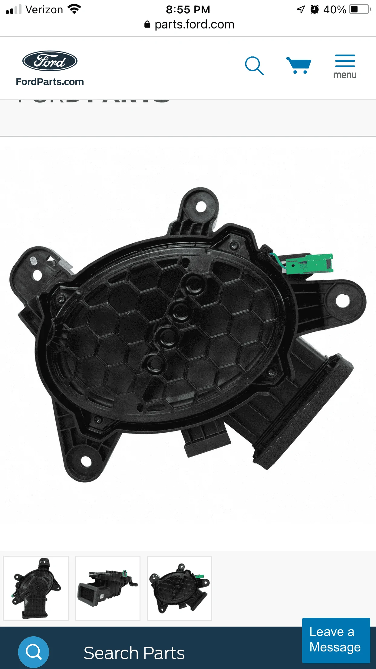

Ford’s literature on the sub says it’s a 6x9. 160x236mm. That’s a mid. There’s no actual sub. Hence the dsp cutoff
Here is a picture of it. Bummer

I am going to try to tap into the high level outputs of the rear sub and hook up a LOC. Does anyone know if they set the sub to roll off at some lower frequencies for the subwoofer's protection?

OMG! This is pretty unacceptable.
I hunted all over for a Badlands edition largely to get one with this upgraded stereo in it. And a 6x9 for a sub??
B&O shouldn’t even allow their name on something like this.

Should be possible replace this sub for some better one…using the same space?
I would assume. Deminsions are listed as 13.81L x 7.31W x 14.44H. You would think you could shoehorn at least an 8” sub in there. I replaced the factory Sony 8” sub in my truck for a JL 8w3v3, I’d be happy if I could get one of those in there with a 150-200 watt amp.
I’m sure my curiosity will get the better of me sooner or later and I’ll pull the side panel out to see, but I’d really like to wait until the “new” has worn off before I start pulling it apart.
