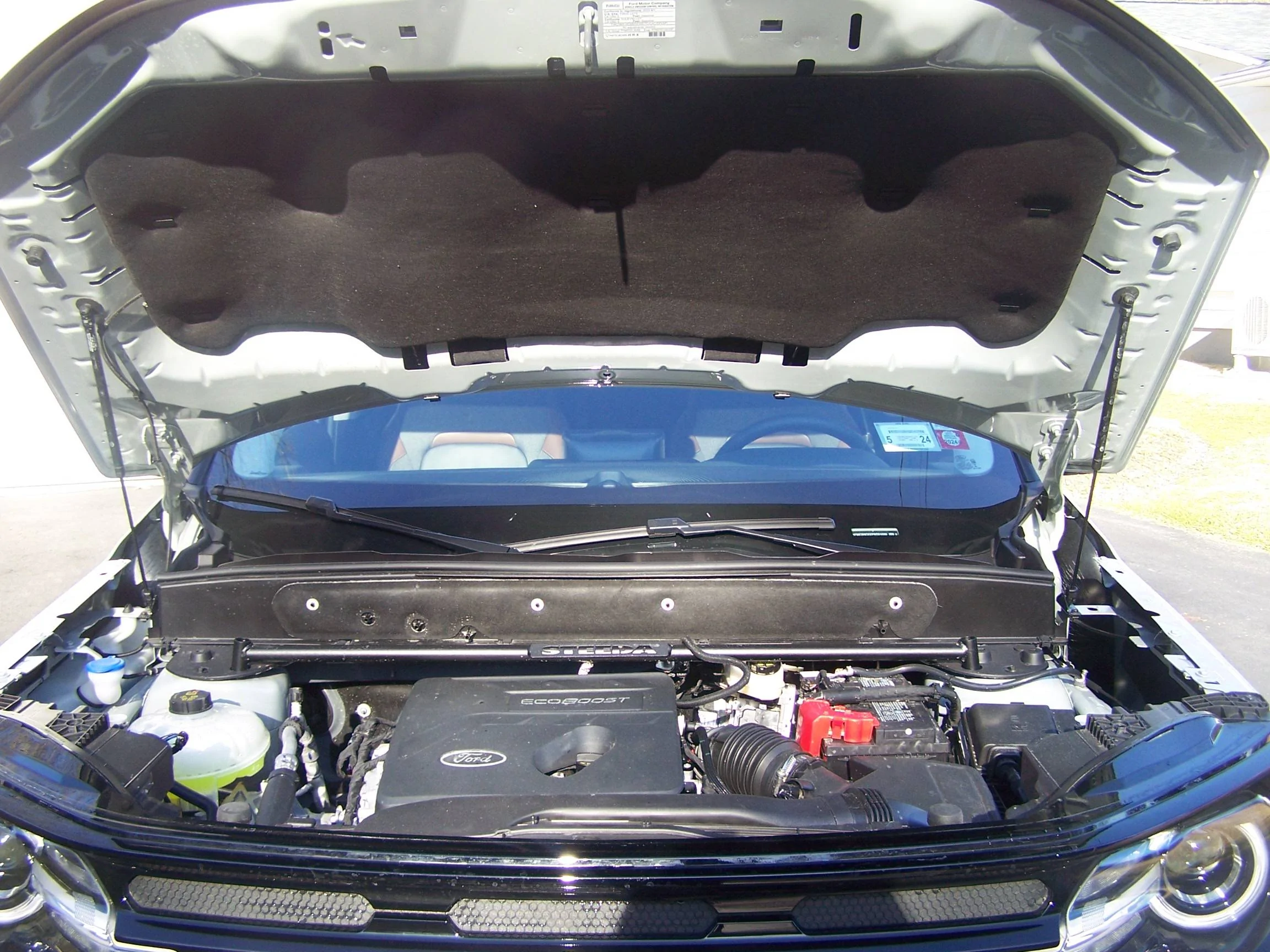

When I installed the strut tower bar on my '23 OBX (no lift), I had to put one line over the bar rather than bending it.

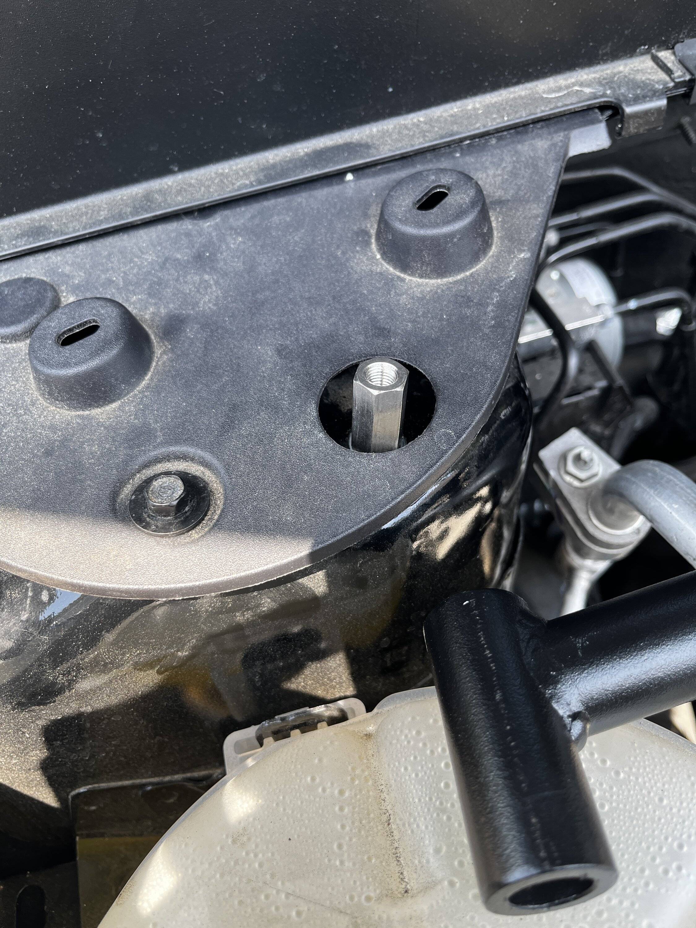

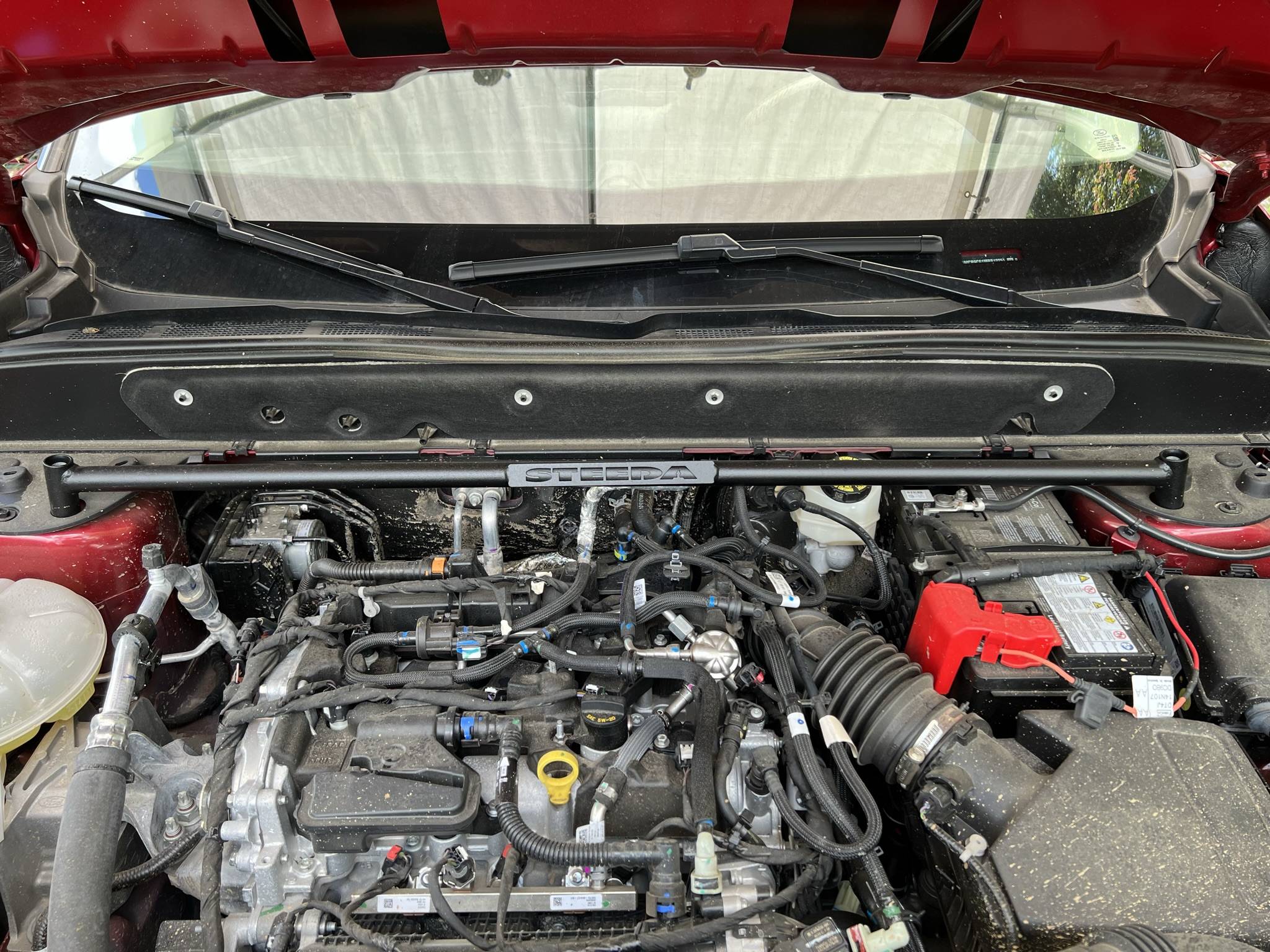

Thanks I finally got it installed. Just got the coupling nuts today and still took a little work to get it to fit. Had to use a step bit on both side to widen it out so it would slide on.

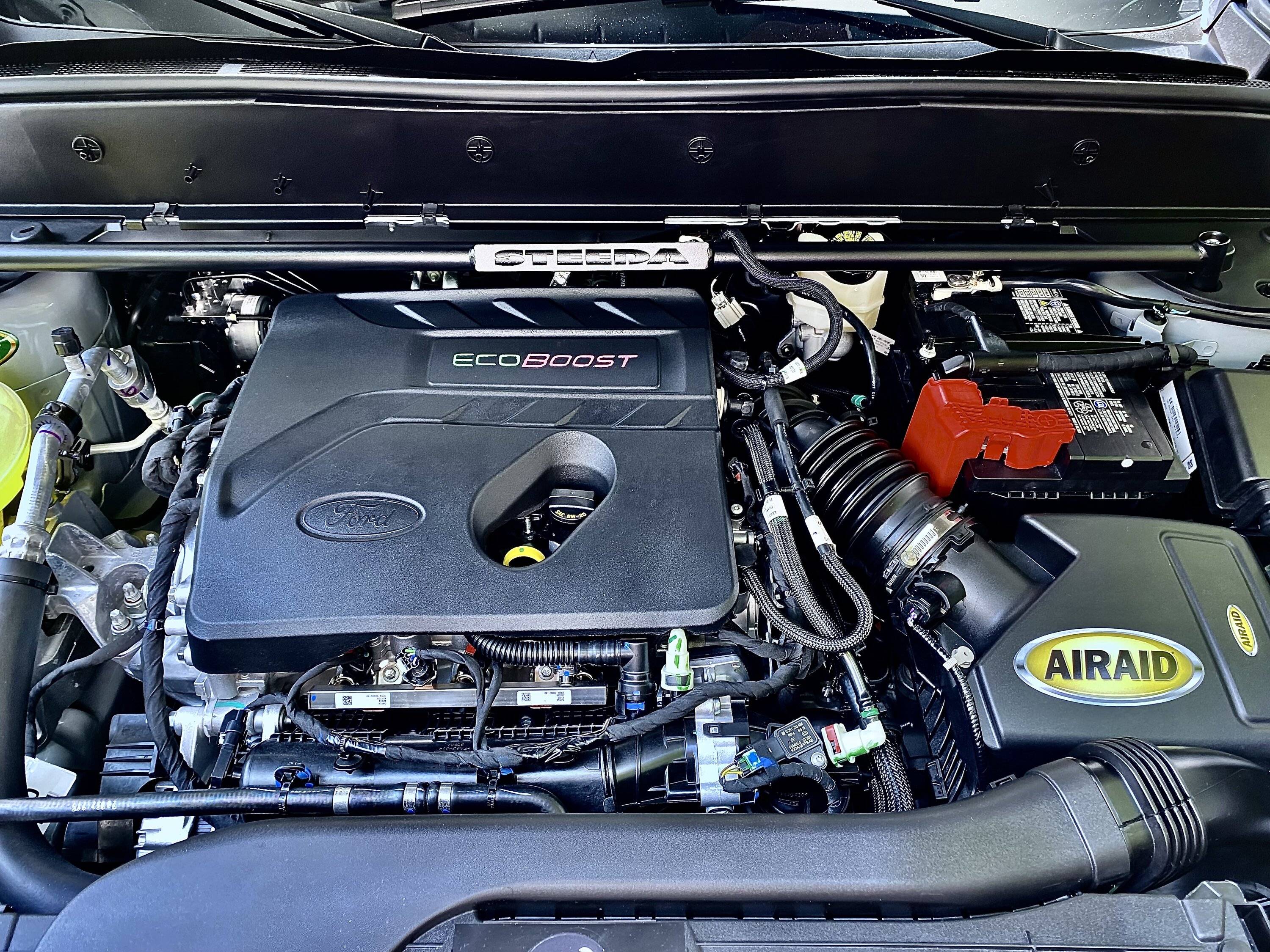

Same here.
