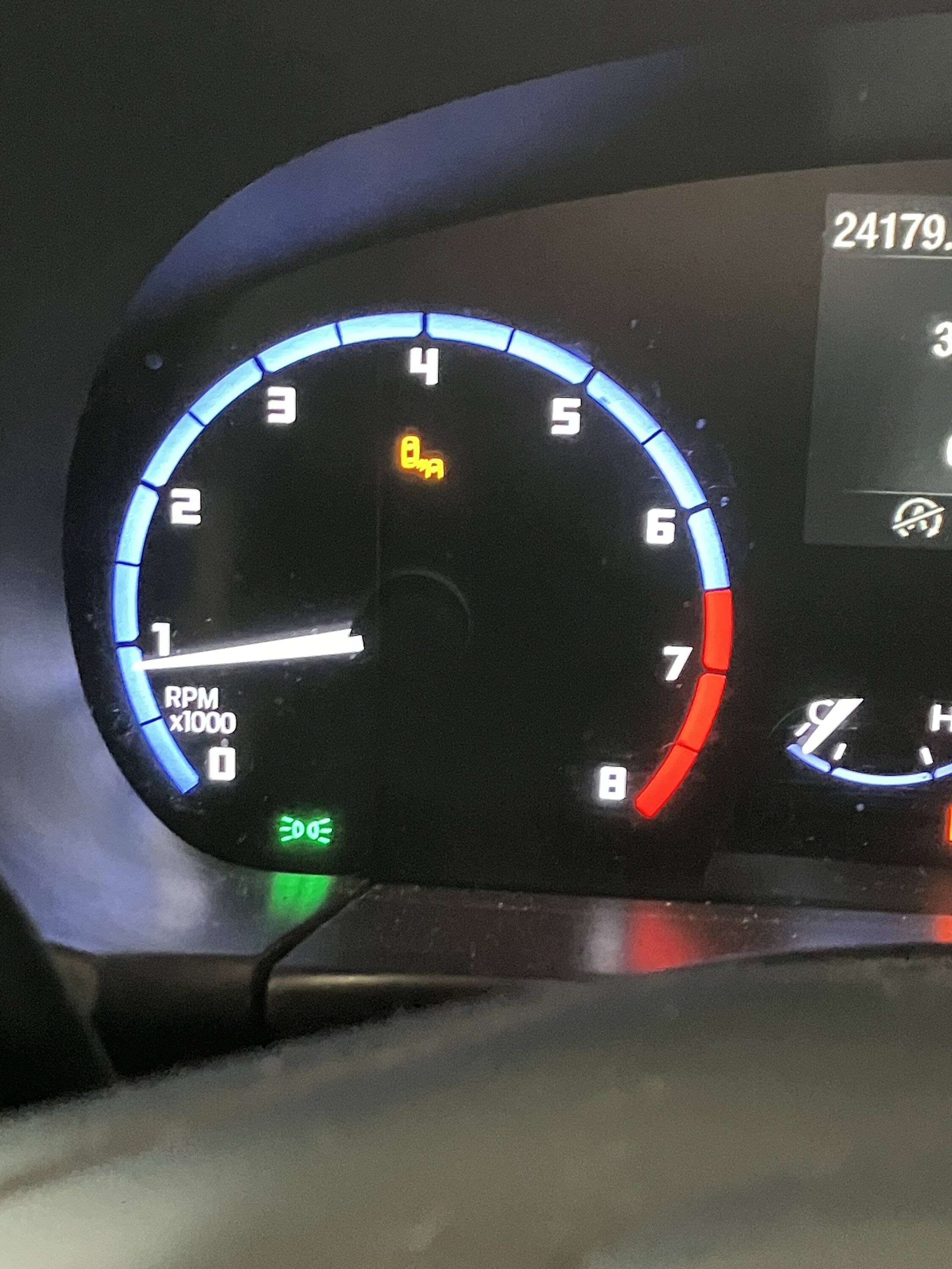

I tried to look up this symbol in my manual but it’s not in it. I called Ford and informed its precollision assist but I don’t believe this is correct. It’s yellow, two cars side by side with two curved vertical yellow lines between the cars. I attached a photo. Does anyone know what this symbol represents?

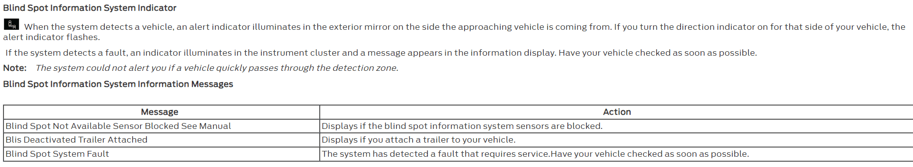

Quick lookup in the manual shows that it might be a faulty Blind Spot Monitoring System. Here's the link if you would like to take a look.
https://www.fordservicecontent.com/Ford_Content/vdirsnet/OwnerManual/Home/Content?variantid=7450&languageCode=EN&countryCode=USA&Uid=G2121496&ProcUid=G2174893&userMarket=USA&div=f&vCode=&vFilteringEnabled=False&buildtype=web

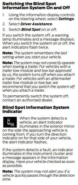

I find all about it, on or around page 212 of my manual.

its in your settings. you can turn it on and off. i always hit mine by accident as its close to the 'turn off traction control' tab lol.

Thank you so much! I missed that in the manual. I was looking under symbol section.
The Ford manual is not easy to use. There are many other symbols, you have to realy look closely through the manual to find them.
Glad I was able to help.

It just means blind spot monitoring is off. I turned it off by accident in the settings recently while driving and saw the symbol pop up.
