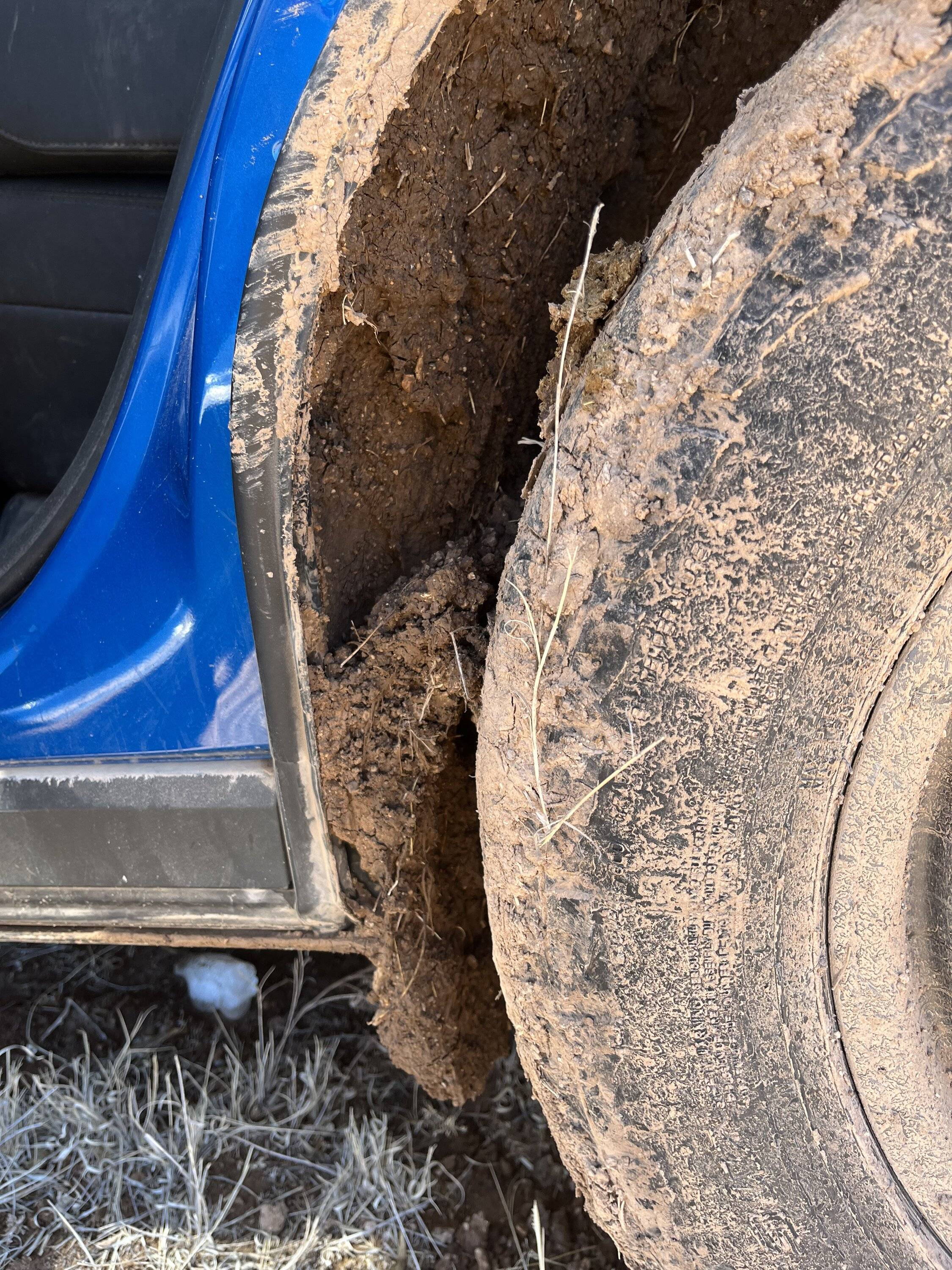

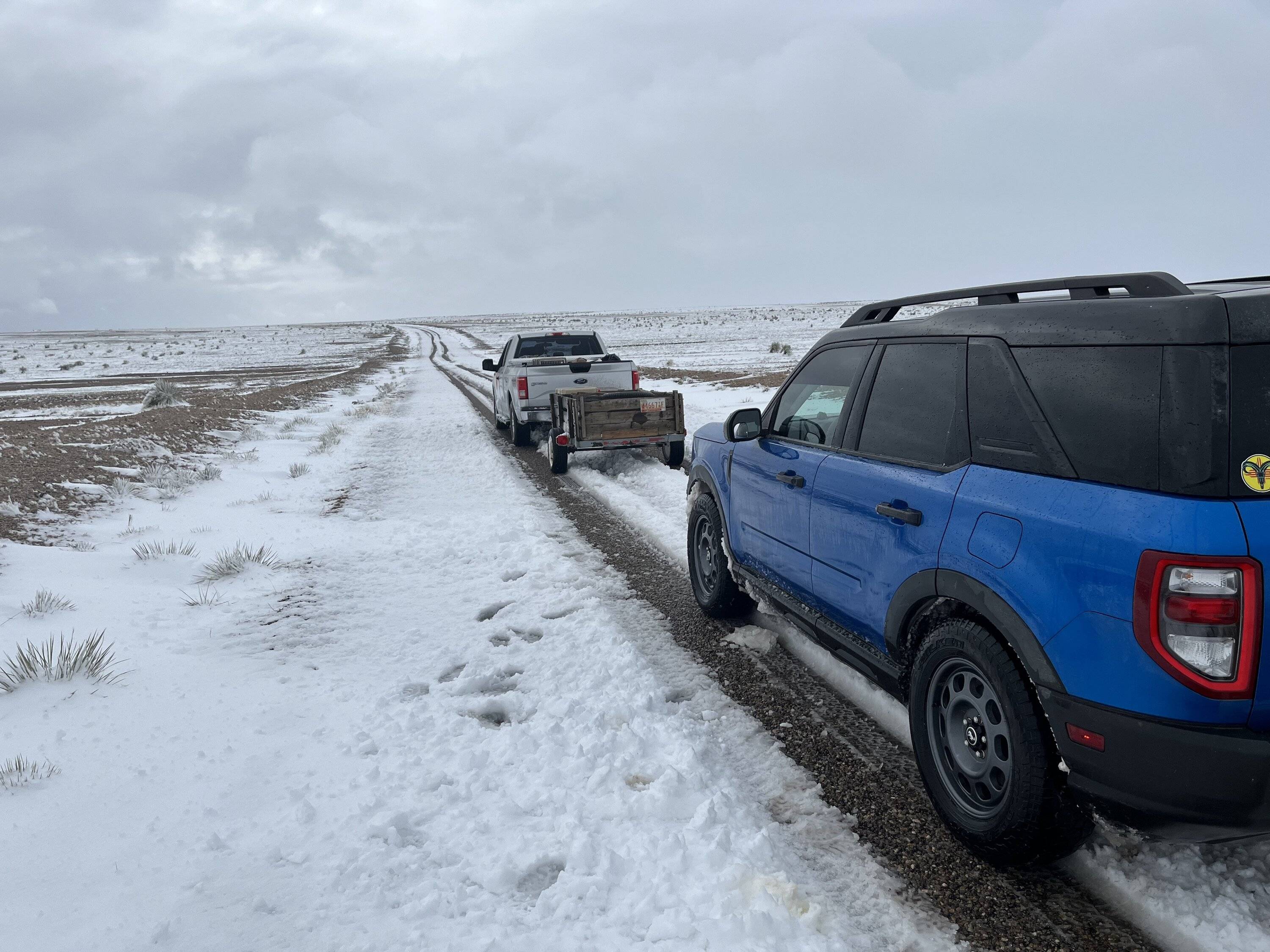

I went on a hunt last weekend in terrible road conditions. I was plowing snow in the center and had some ice and snow in the ruts. I tried slippery mode a couple of times. I ran on snow, slush, and mud, and the Badlands performed flawlessly through it all. I need to go to the car wash. I'm not fond of the carpet lining in the wheel wells.
