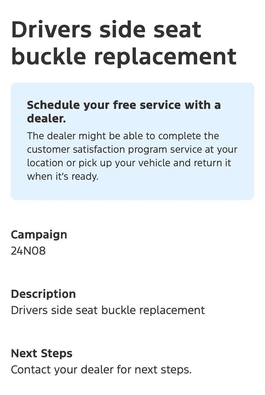

I haven’t seen reports about the passenger side seat belt and my FordPass shows this for drivers side. Probably taking it in for service is a good step
