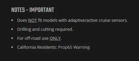

Now I had another doubt... my BS BB and have BB package also ford copilot assist plus, the nudge bar will affect that?
And I will respond that question myself... with this.... if your BS is equipped with the radar you will block the purpose and maybe you will get some warning and error messages...

Yeah, I have the adaptive cruise/lane assist and this is what they have on their site now:

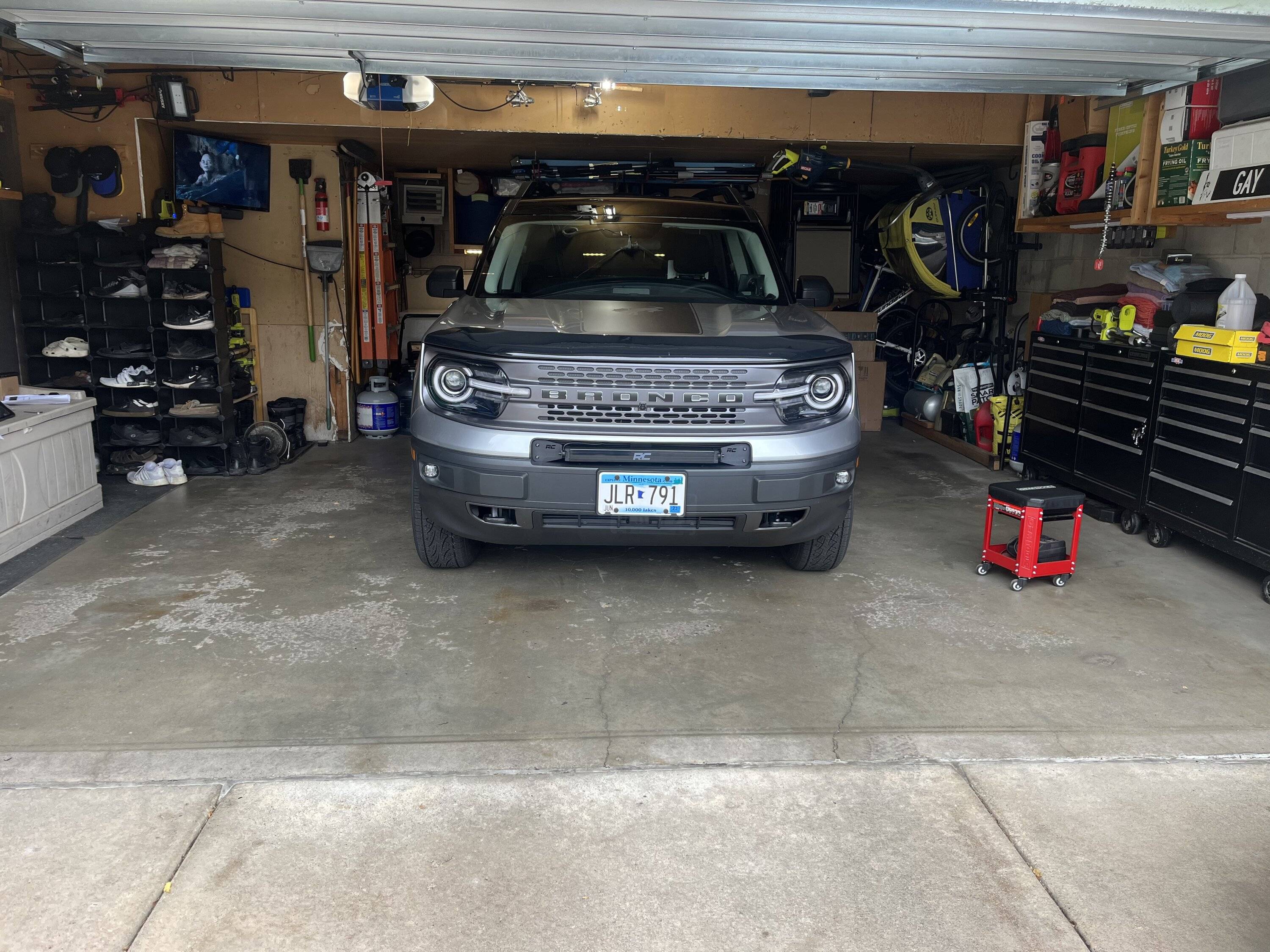

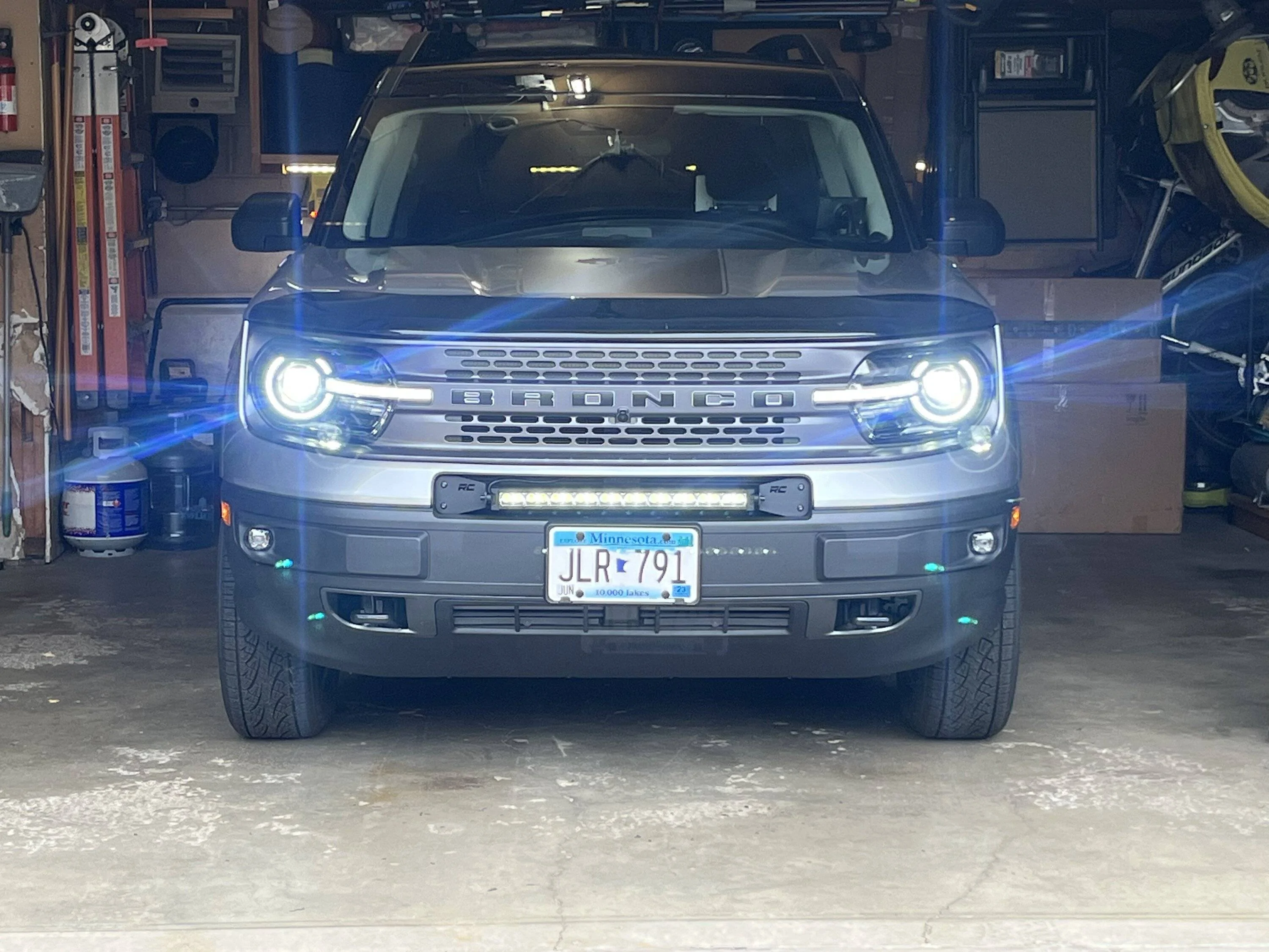

I have the integrated one in the bumper. It is awesome! Can go through car washes without concern. LoL
Pictures please :)

Low is like driving lights, and high is like Super High Beams! LoL
