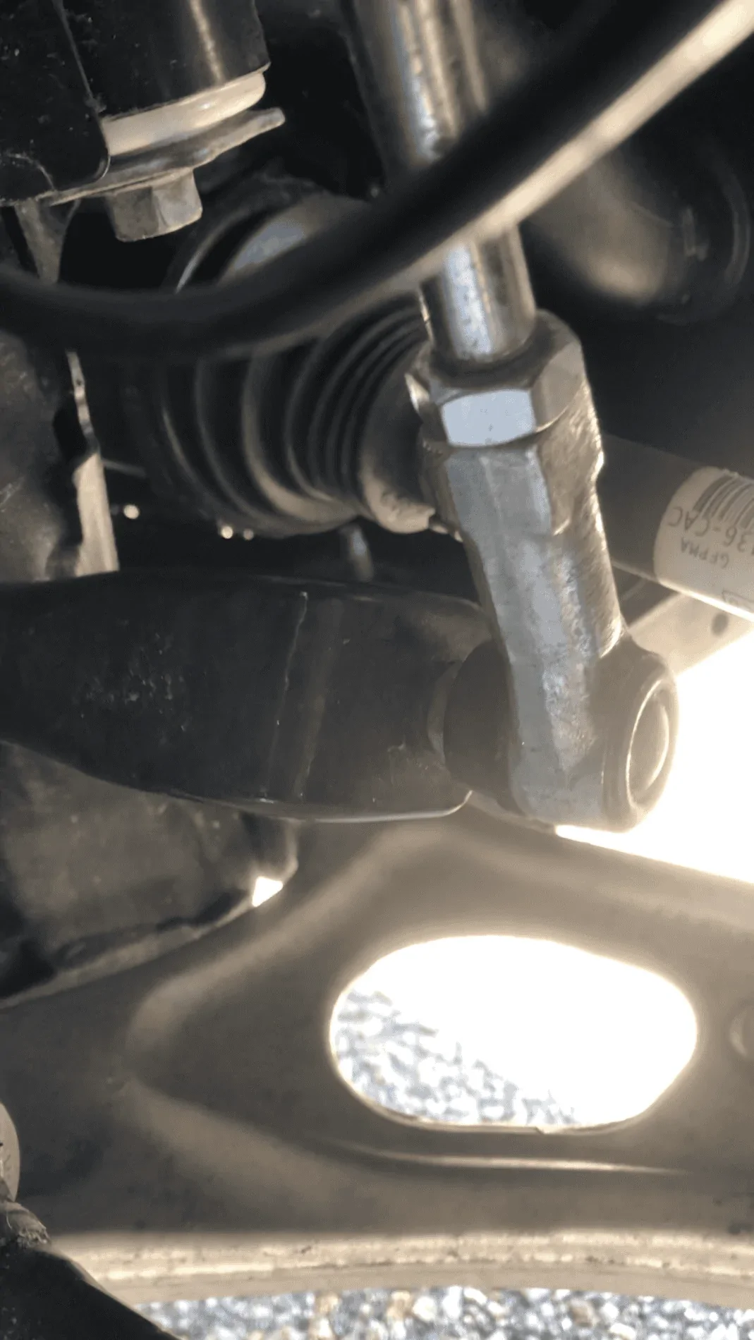

I don’t know how to tag someone, but @MRanderson was correct when he said the nut on the sway bar link was loose! I double checked mine after reading his story, and I didn’t see anything loose near the drop down bracket. After further investigation it was on the link itself, and not the bracket. Here’s a picture and video of what was wrong on mine. I’m not saying this is causing everyone’s clunking, but huge thanks to mranderson to giving us his feedback first!

That clunking noise is constant?

No, I should have clarified. Mechanic wanted to show me exactly what was clunking. They rocked the bronco back and fourth to imitate the noise. I’m definitely more of a visual learner than just having someone say yeah it’s this. I wanted to know what they fixed. Luckily it was something simple!

After enhancing the Video , its the actual Link ( Heim joint ? )where it attaches that is loose . What is that Link Attached to , that black bar ? Sway Bar ?
Wont take long for it to wallow out that Hole where it's attached .

Yah dude! I’m stoked that helped! Mines been holding up well so far.
I’m pretty familiar with the suspension on the car so if anyone has questions DM me and I’ll respond back.
