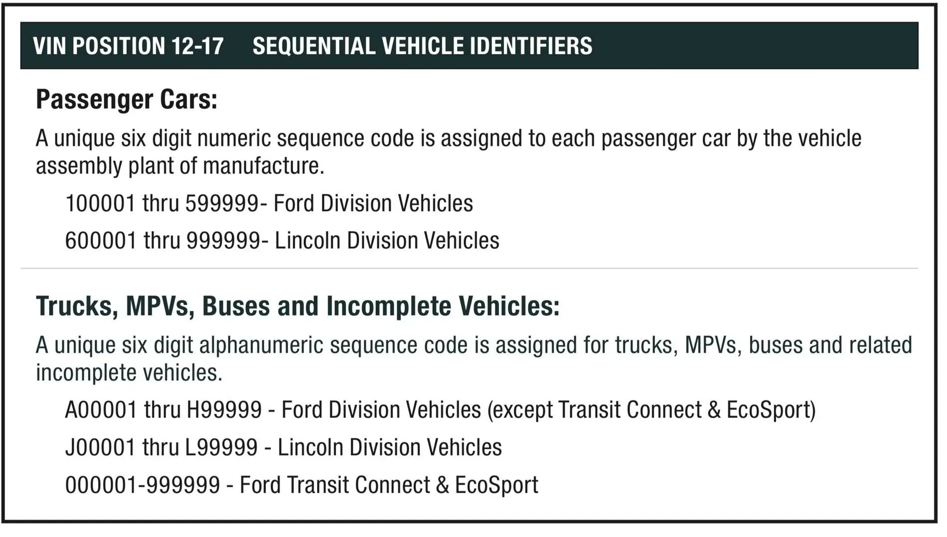

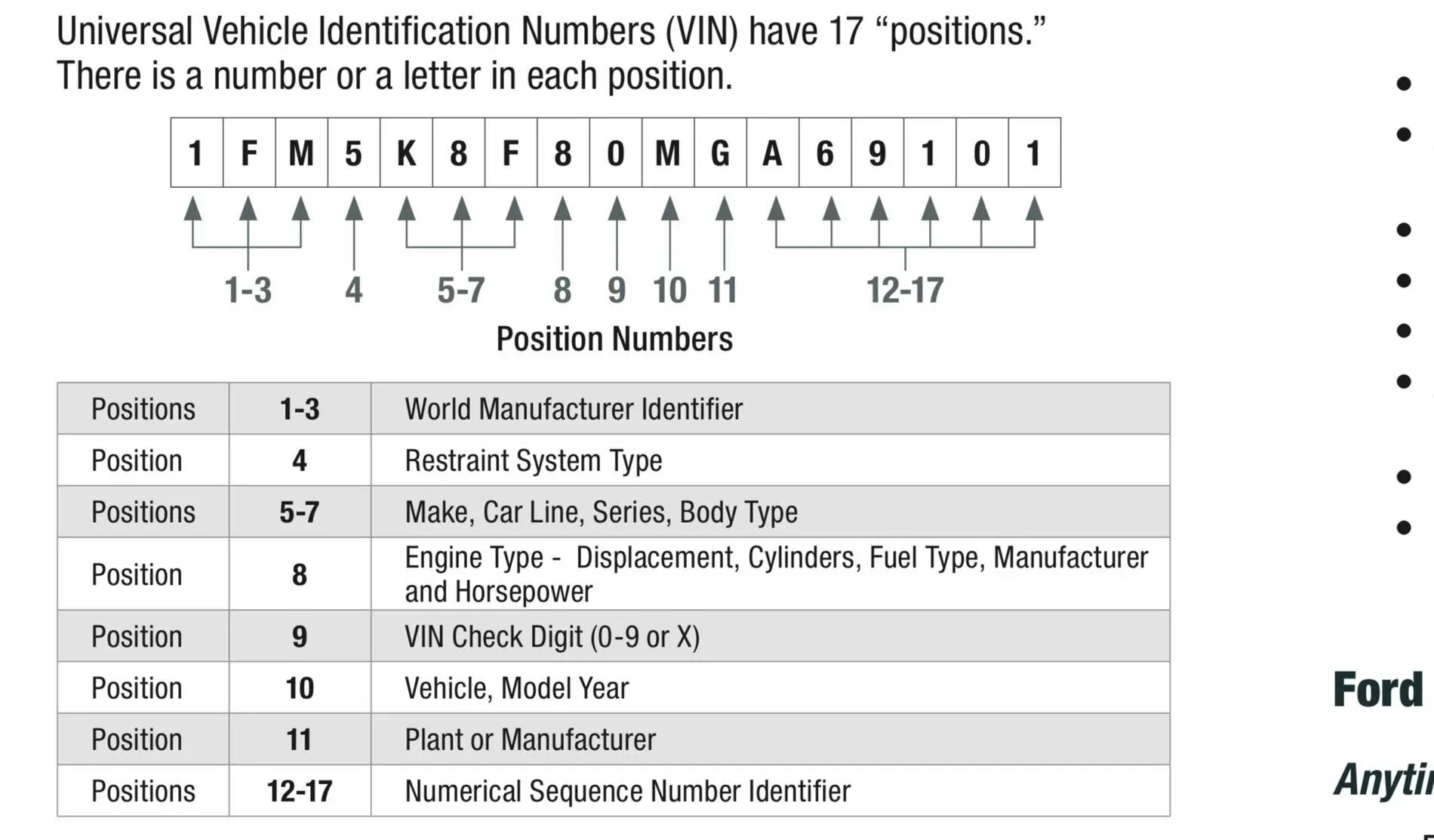

This is directly from FORD

Thanks I appreciate your time. Was trying to figure out what my production place in the 2000 first edition model is .

Based on that logic my badlands is the 226th 22 badlands off the line. Not bad, if I understand the number system correctly and the number they choose goes up by 1 every vehicle. They certainly are not making many of them.

VIN sequence numbers are not the order they are on the production line.
VINs are assigned when the car is accepted to be built. This is during preliminary scheduling, which is weeks before the final production line order is set.
It is a unique number they are assigned as they are accepted to that plant and not the order they are built in. I have seen a Ford model built in the first weeks of a model year with a massively high number assigned. 70XXX.
Production weeks for vehicles are pushed all over the place based on commodity availability. So VINs are not the order on the line Otherwise your sequence number would change in your VIN if your vehicle build was delayed due to a part missing, which it does not.
Your rotation number on your sticker is your actual place in line in a group on those build days.
