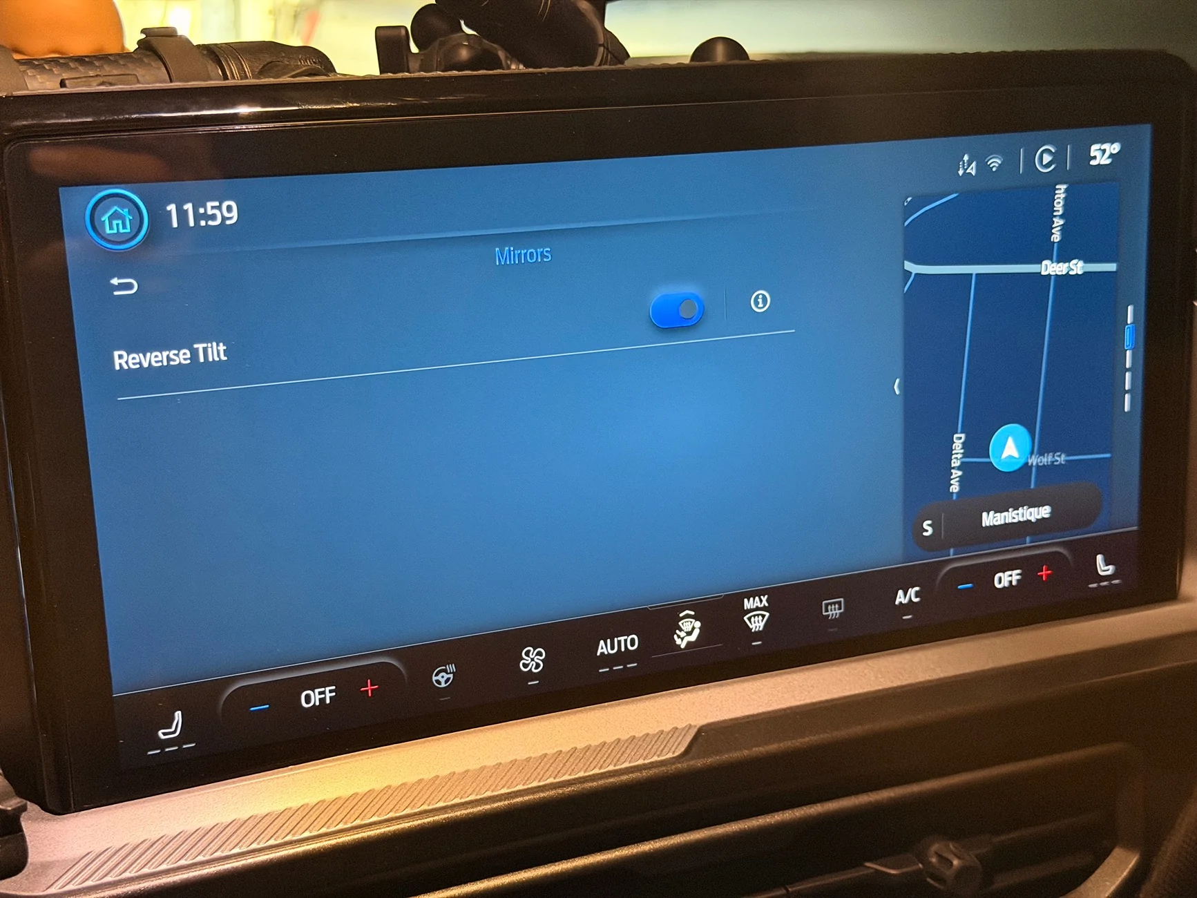

Reverse tilt mirrors WORKED!
Frenchy906
Dec 10, 2025
527
1,361
2025 Bronco Sport Badlands
Stupid laptop was dead… it’s charging now. 🤦🏻‍♂️
Frenchy906
Dec 10, 2025
527
1,361
Can confirm the action is in the APIM… cannot confirm if it works until the morning. It’s midnight, and I don’t think my neighbors would be too happy if I started this thing up at this time. 🤣

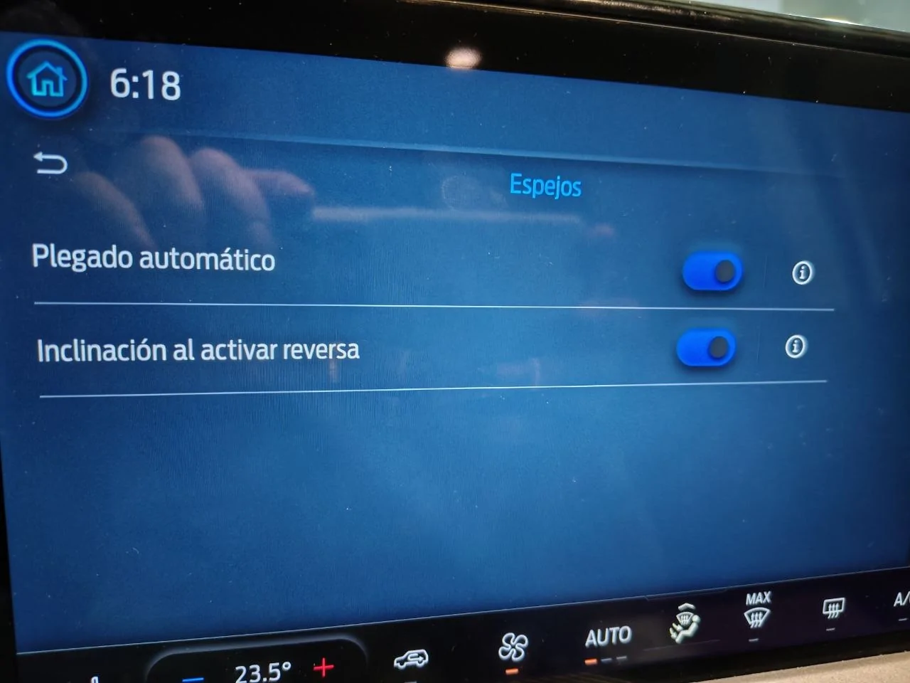

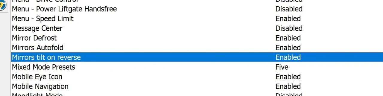

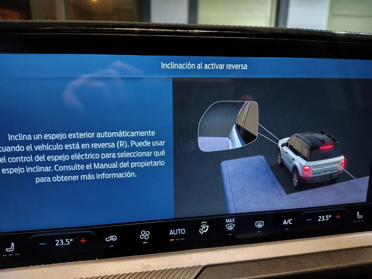

ATTENTION: THIS ONLY WORKS IF YOU HAVE MEMORY IN YOUR SEATS
You just need to activate them in the IPC and in APIM (Easy mode)
:muscle: :muscle: :muscle: :muscle: :muscle: :muscle: :muscle: :muscle: :muscle: :muscle:

Genius!
I did it on mine just this past weekend.
I'd been using both memories, 1 and 2, with two different mirror positions. Same seat location, but different mirrors. It clearly had to be there. On Sunday, I changed about 25 parameters... including the reverse tilt.
But since some didn't work, and I didn't have much time... I reverted everything to how it was before I changed them. And I thought, later I'll just make that change again, save it as a stable version of the backup, and upload it to the group... But you beat me to it. Hahaha... Congratulations!

Did you press the right or left button on the door keypad?:rockon:
Ok… I missed this part.
Just came outside and checked. If I press the left button, the left mirror goes down in reverse. But then I have to put it back into position after I’m out of reverse? I did the passenger mirror… and it definitely moved, but it didn’t go down. It pointed as far to the right as it could.
