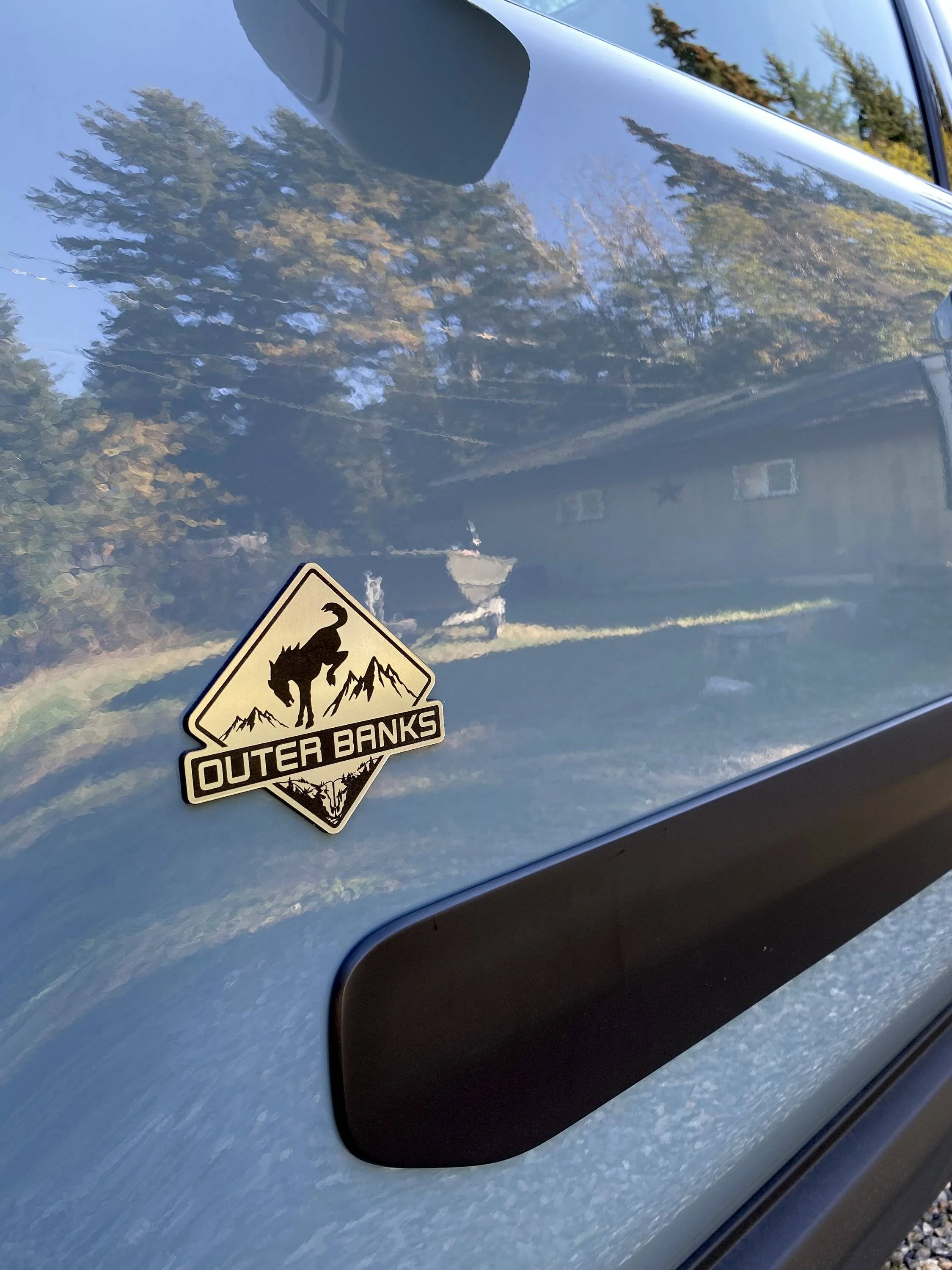

I particularly dislike the OBX decal that they come with. So I replaced mine with this. However I also do like the no-badge look too
Ford Bronco Sport Removing sticker from side,  the triangular one IMG_1847

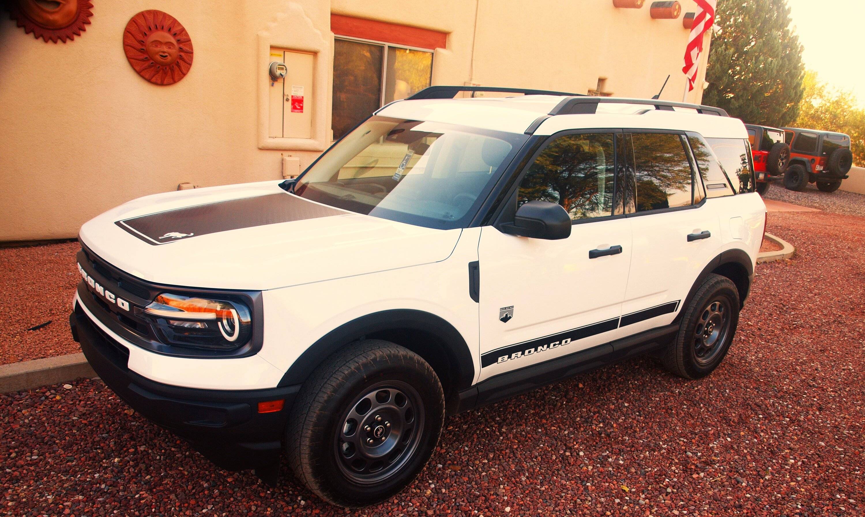

Has anyone removed the 'factory' sticker from the side, the triangular one such as: BIG BENDS, OUTER BANKS...
Is it just a 'sticker' that could be heated with a hot air gun and peeled off?
Just would prefer a clean look to the side.
Ford Bronco Sport Removing sticker from side,  the triangular one AAa23BRONCO.JPG

Mine were weather-worn and I thought the "Sport 4X4" decals on the rear quarters would look better. I just (slightly) heated them with a heat gun and they pealed right off. I used a 30% solution of 90 alcohol/water to remove any glue left behind
