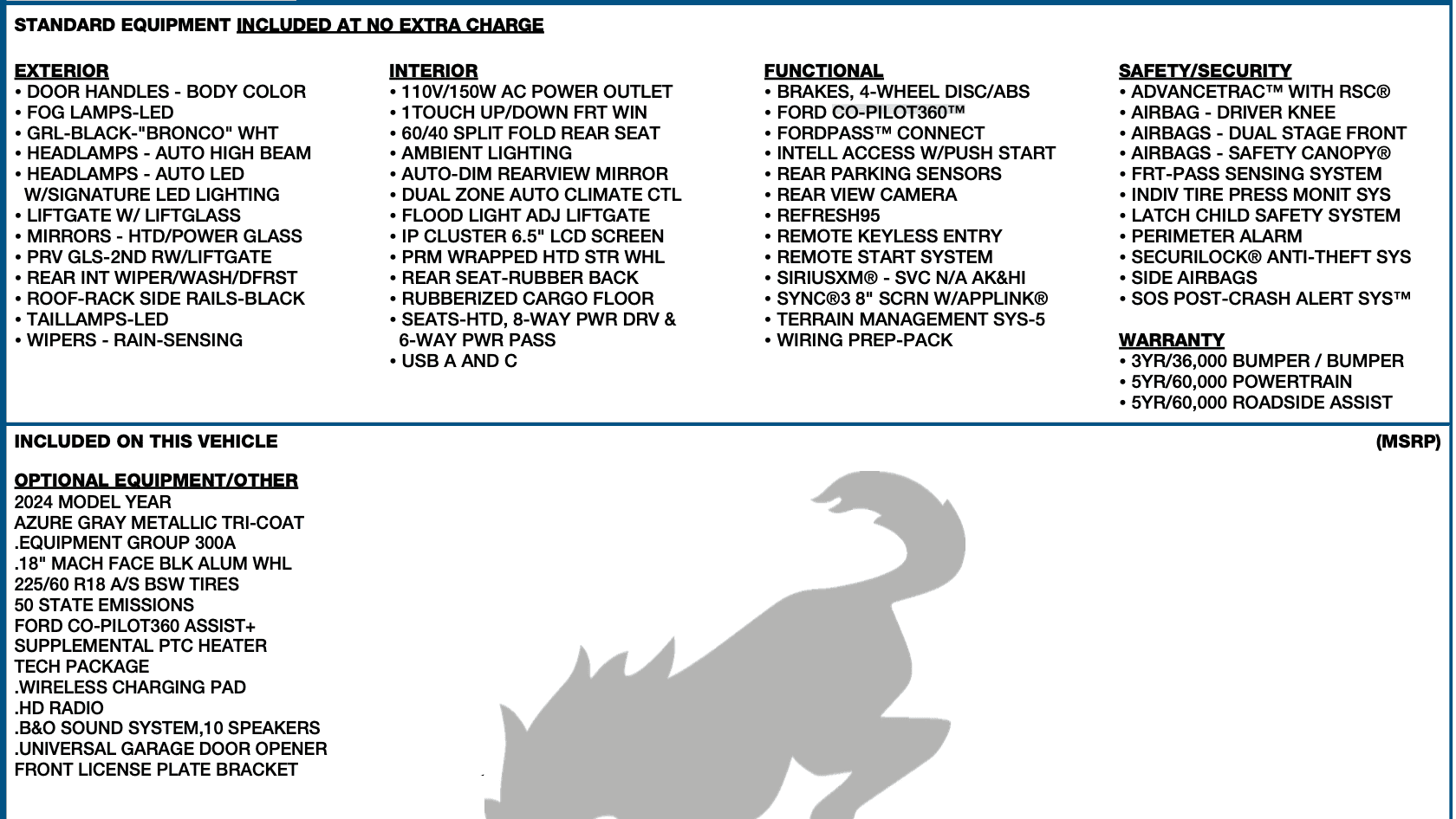

Ford Bronco Sport Remote Start...Perimeter Plus? Screenshot 2024-05-31 at 6.27.55 AM
Here part of the window sticker. KN1Z19A361A is the part # to the perimeter plus module I got off Ford’s accessories page. I may have to call. Thanks.

I don't see it on the window sticker.

My question is: could I already have the Perimeter Plus module installed, and just a matter of enabling the shock sensor feature?
If you take a look at the 2024 Bronco Sport order guide (attached) you'll see that "Perimeter Alarm" is standard on all trim levels. This strongly implies to me that "Perimeter Alarm" is the window-sticker term Ford uses to identify the basic "Anti-theft Alarm," as described in your owner's manual. Given there is no mention of one in the owner's manual, I think it's logical to assume the basic anti-theft alarm does not incorporate a shock sensor.
