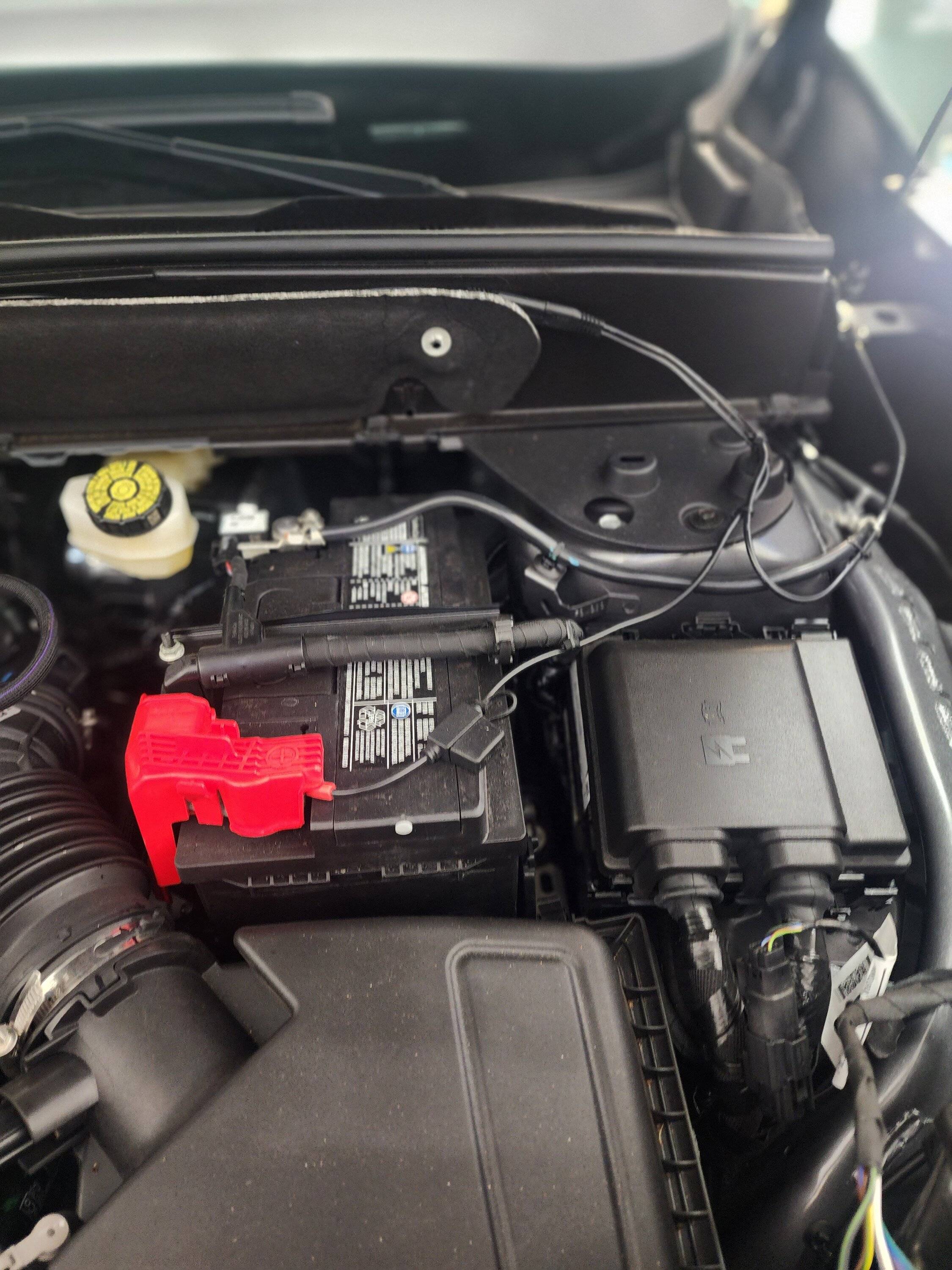

I know this is a source of huge debate, but I'll just throw out there, I've had my battery tender connected directly to the positive and negative posts of the battery for nearly three years. I put it on whenever I park for more than 3 days or when I notice the auto start/stop working less during a drive. As it does more now that the car is running lights and such in the winter dark. I've never had an issue with the "charge level" going wonky. I have a voltmeter plugged into the 12v port so I can see what level the alternator is running at. 14.9 is the highest I've seen and 12.1v is the lowest I've seen when the car is autostopped. I got that message one time when the car was almost new and that was what prompted me to get the battery tender hooked up. I have not seen that message since 2021.

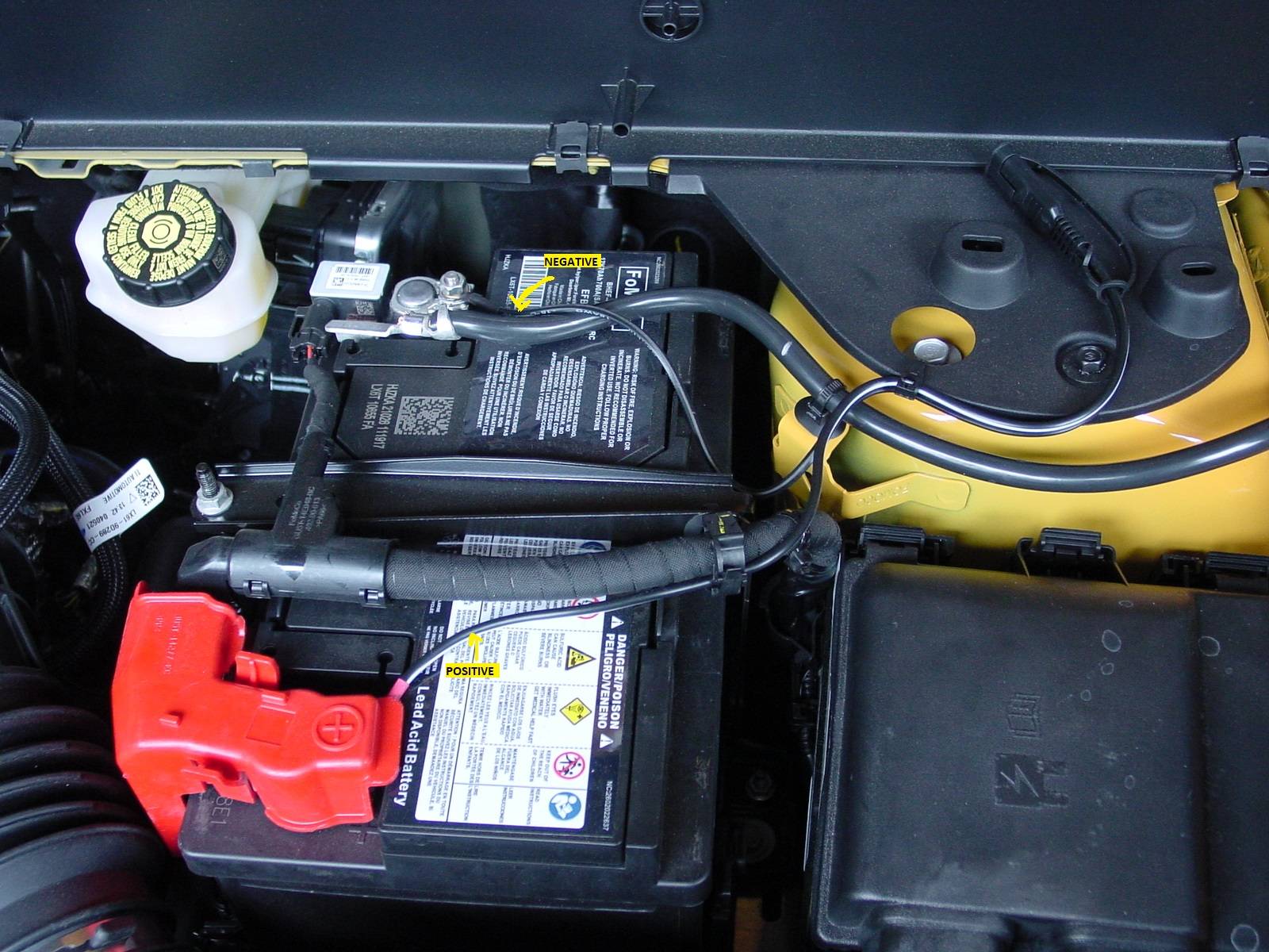

Yep. I took out the clamping bolts for the cables and put the charger's ring terminal over it and reclamped those to the posts. The charge wires are on the "battery side" of that BSM, despite many claims that you need to hook up and feed current to the battery through it. Maybe your battery is actually dying and so the charger isn't having an effect?
"She's gonna blow captain!" :cool:
No, seriously, bypassing the BMS and connecting a charger directly to the battery terminals won't hurt anything -- it's just that the BMS will not realize the battery has been charged. So it will think the SOC is lower than it actually is.
