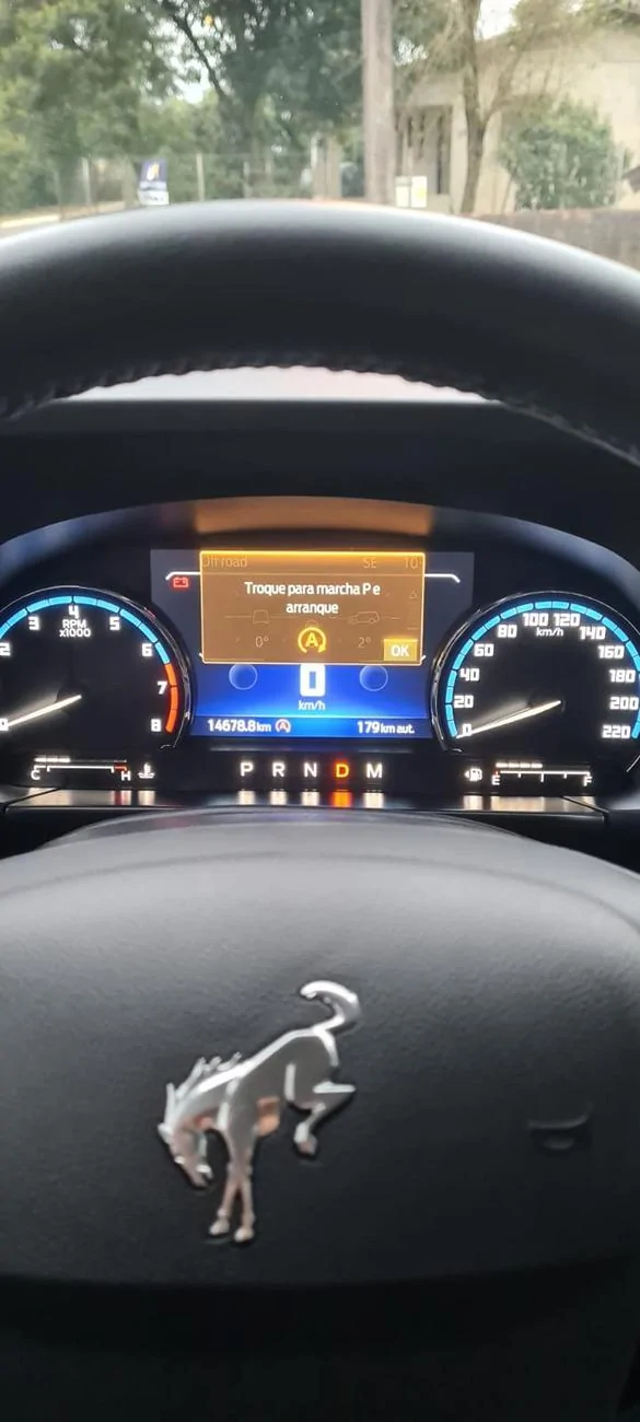

I`m not shure if my problems are due to software update but since my BS whas updated I had 4x times experienced a start/stop failure, after stopping the car it didn't start when accelerating... twice I had this alert in the screen (it is in portuguese - "Switch to P gear and start").
I Also experienced about 5x times this month the car engine dying in the first attempt to turn it on, in the morning.... I Sent the car today for warranty for them to check what is going on...

I`m not shure if my problems is due to software update but since my BS whas updated I had 4x times experienced a start/stop failure, after stopping the car it didn't start when accelerating.
Clearly recall 24S24 did not work for your vehicle however it is difficult to say exactly that is the issue because your battery could have degraded significantly prior to the recall such that the calibration changes Ford made could not overcome the degradation done to the battery. 100% that’s a guess because there is insufficient evidence and no follow-on information (yet) from Ford.
On the other hand, one of the calibration changes is to prevent Auto Start Stop from engaging when the battery has insufficient charge. That calibration change for reasons unknown to us failed to work for your vehicle.

I got the BS today from dealer. Apparently they couldn't measure the current battery level as discharged but they were able to reproduce the star stop failure and they got an alert of low battery in the scan during the operation.... Now they are telling me to exchange it but since the car is one year and 3 months old the battery warranty does not cover the exchange (it is one year of battery warranty standard here....) I argued that it is a Ford BS
Problem related and they have to cover the expenses because is not normal a battery last that short of time... Now I have to wait their analysis to decide if they will cover it or not. I am not sure about how to proceed in this case... It is not cheap a new battery here and this is totally related to recall issue. ??‍?
