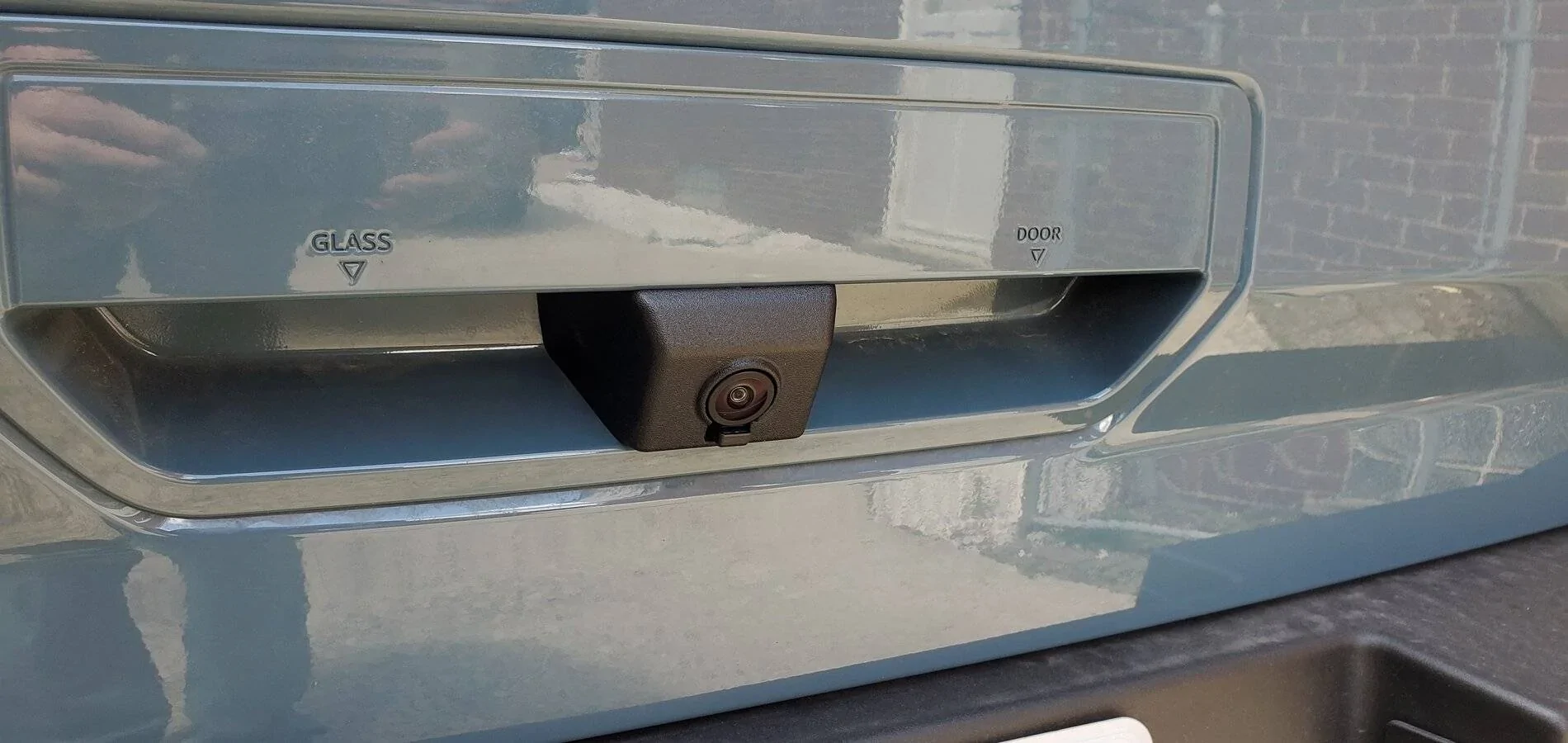

If anyone has info or part numbers, please throw them my way. Even photos if you have the camera washer would be nice.
Wow, good research! Here's a pic of my rear washer assembly. Maybe the handle is the same and the plastic cover is different?

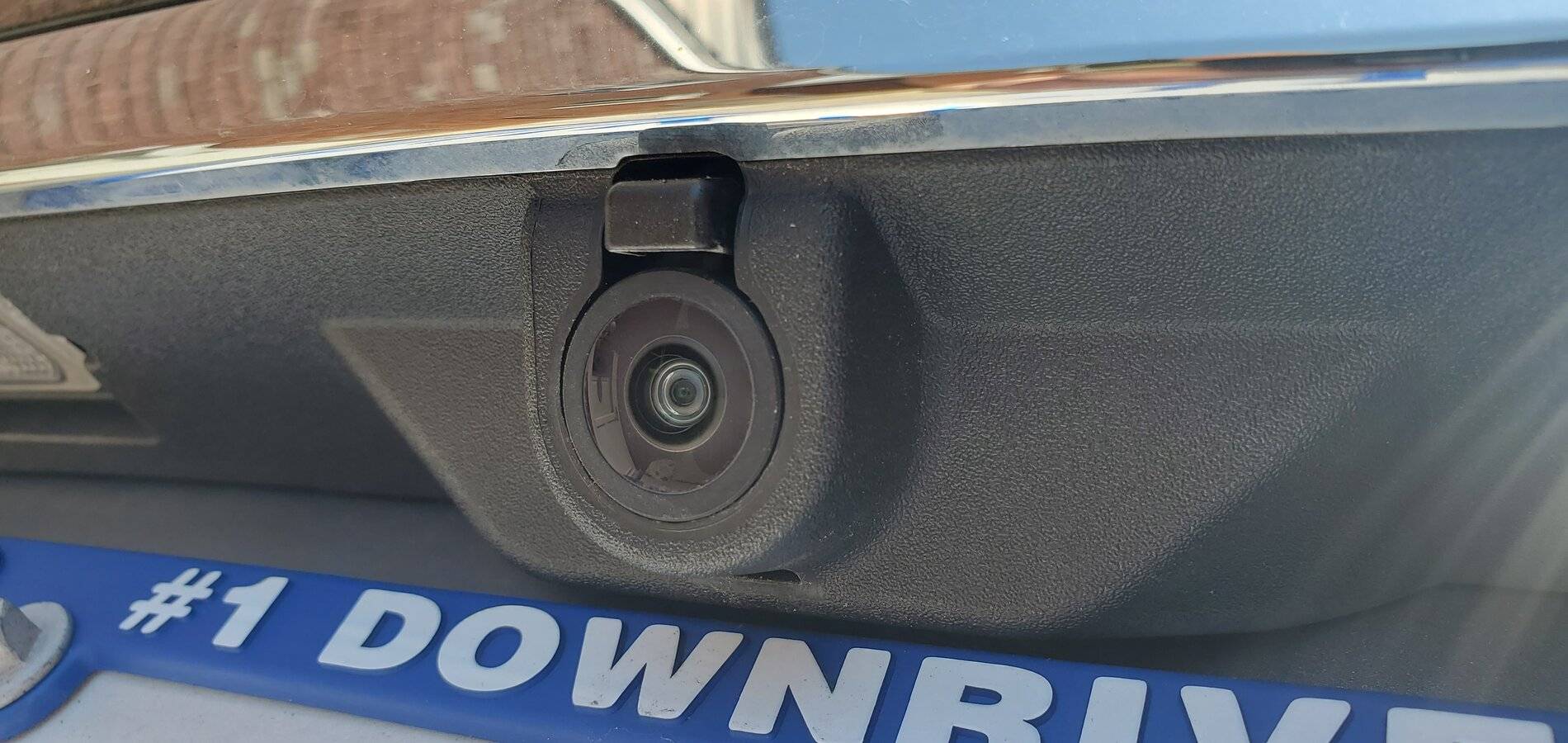

You're awesome. Thanks. Looks like the only difference is the small notch. I will have to dismantle mine and take a look. I might just order a handle as well.
Camera is definitely not different. Just the jet below. Same as my 2020 Edge.

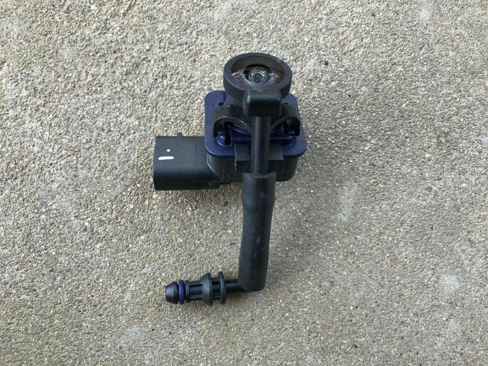

Can confirm how it attaches to the existing camera. Simply clips onto the camera. Just need to find (or modify) the housing.

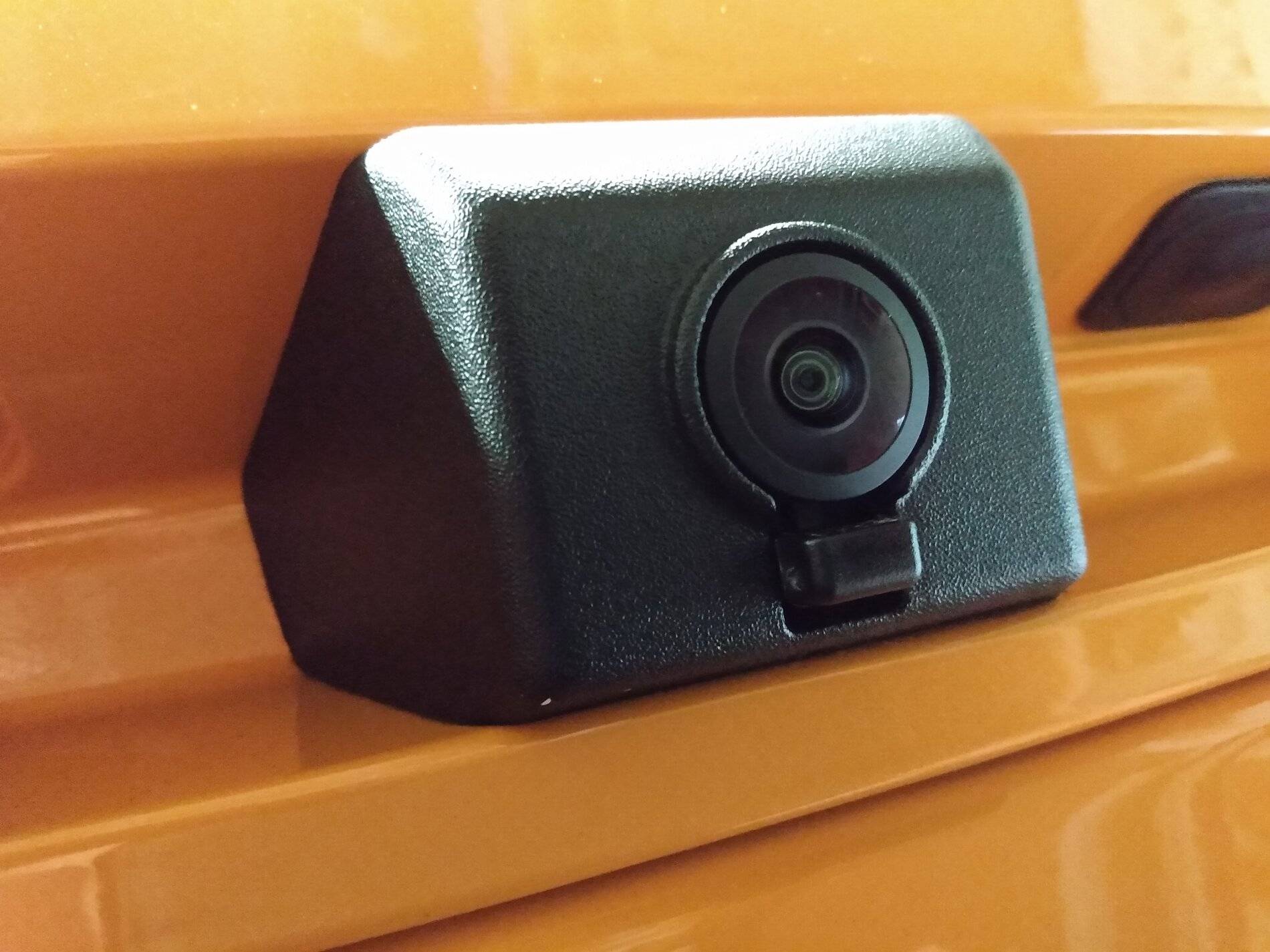

outstanding upgrade, well done.
I suggest you start a new thread for your write up so it doesn't get buried.
