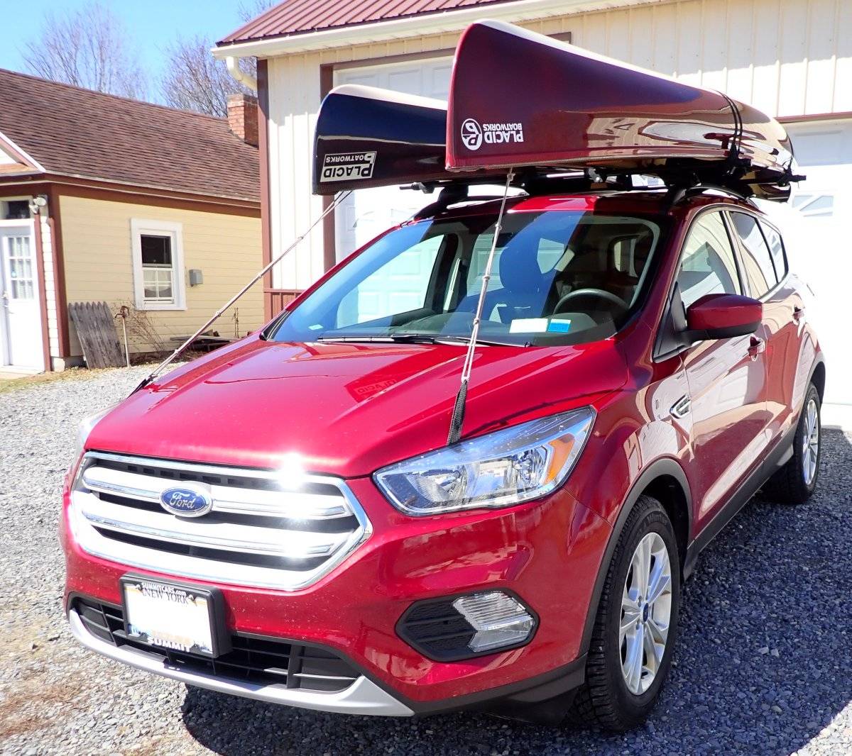

Same on my '18 Escape. Spacing is different front and rear. I marked my Yak towers so I know which crossbar goes on the front and rear. Will be moving rack to my Sport when it arrives so will have to respace everything. Rack goes on in the spring and doesn't come off till late fall.
