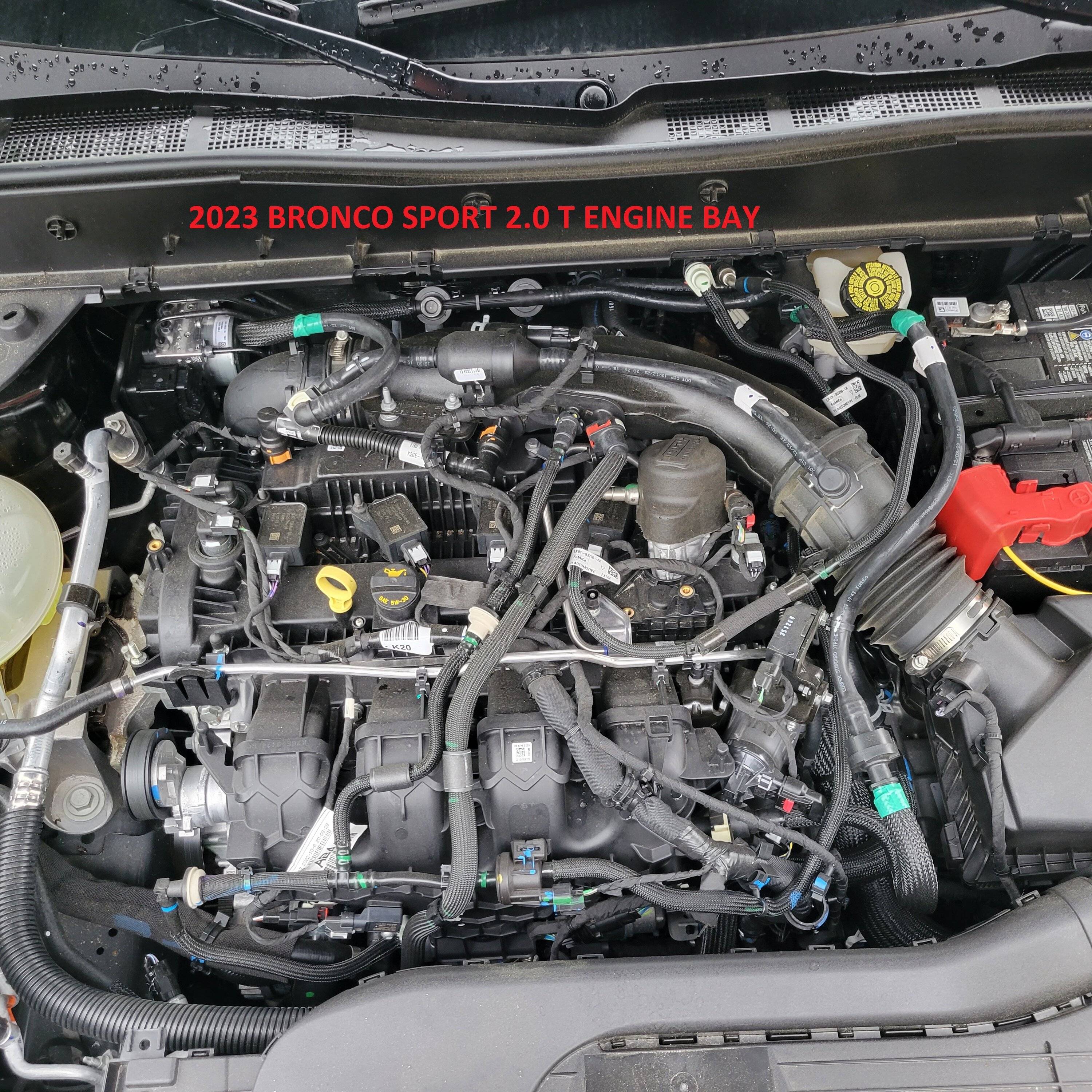

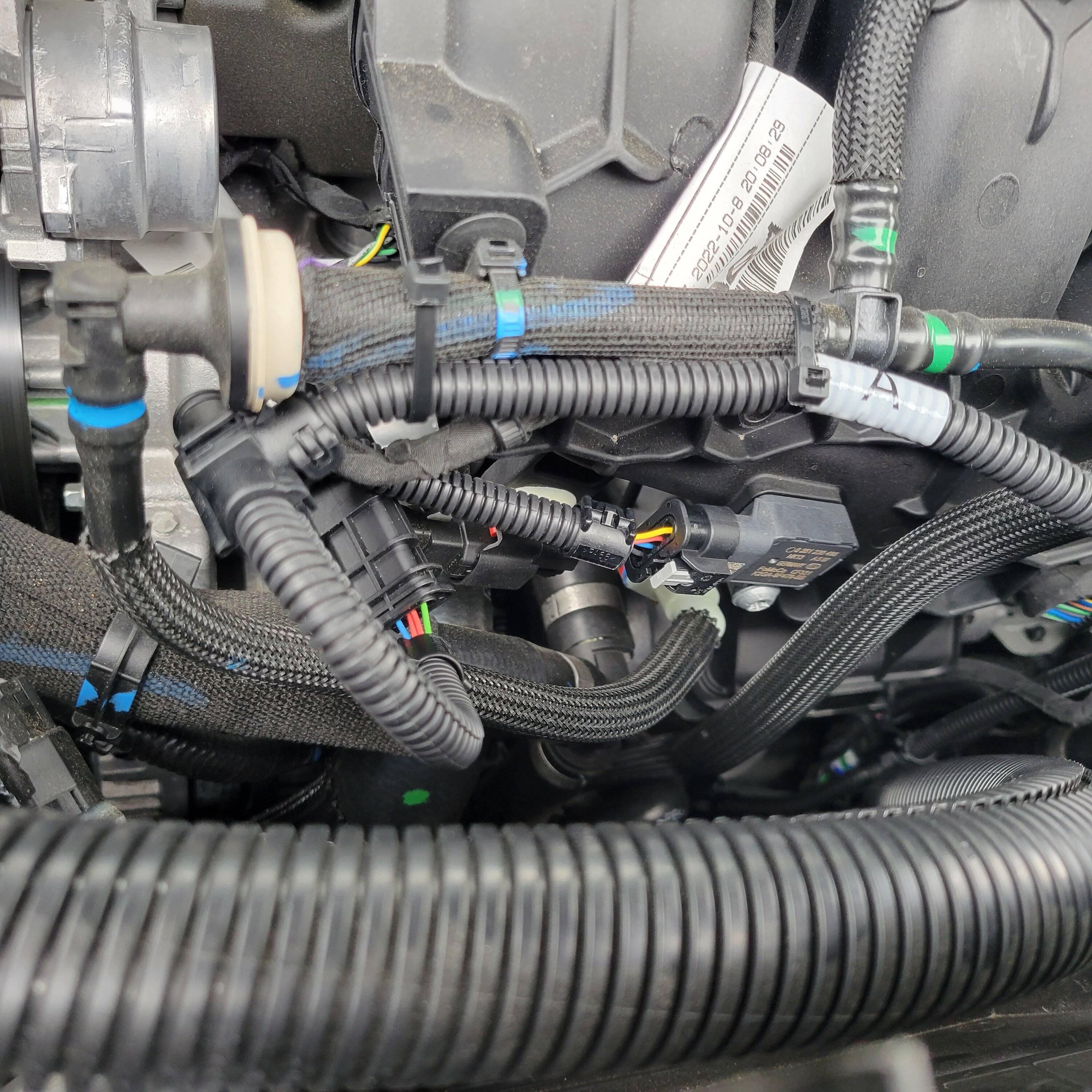

Attached are pictures of my Racechips GTS plug-and-play chip install. Overall impressions 1) Adder Power: Significantly felt change in acceleration, particularly in Race mode. I had zero torque steer stock and now if I full throttle I feel the steering really attempting to get away from me. 2) Drivability: Completely different in throttle response. Prior to the chip, there was always a "zingy" feeling with the throttle as it decided at low speeds what I was doing. Now there is a firm feeling of consistent power all the way through the throttle as if the turbo lag is almost eliminated. Nice and strong all the way through. I haven't done much off-roading yet but can see how a more consistent throttle will help with low-speed manipulation of obstacles. 3) Fuel Economy: Day three and the chip maker states it will take a week or so for it to "learn" your vehicle and driving styles, but I'm recording through the info system a little over 3 mpg better already. I've used nothing but 87 octane all this time and am very impressed with this system. I purchased the Bluetooth option extra and it's really nice to be able to flip settings on the fly from the seat.
Overall: Highly recommended.

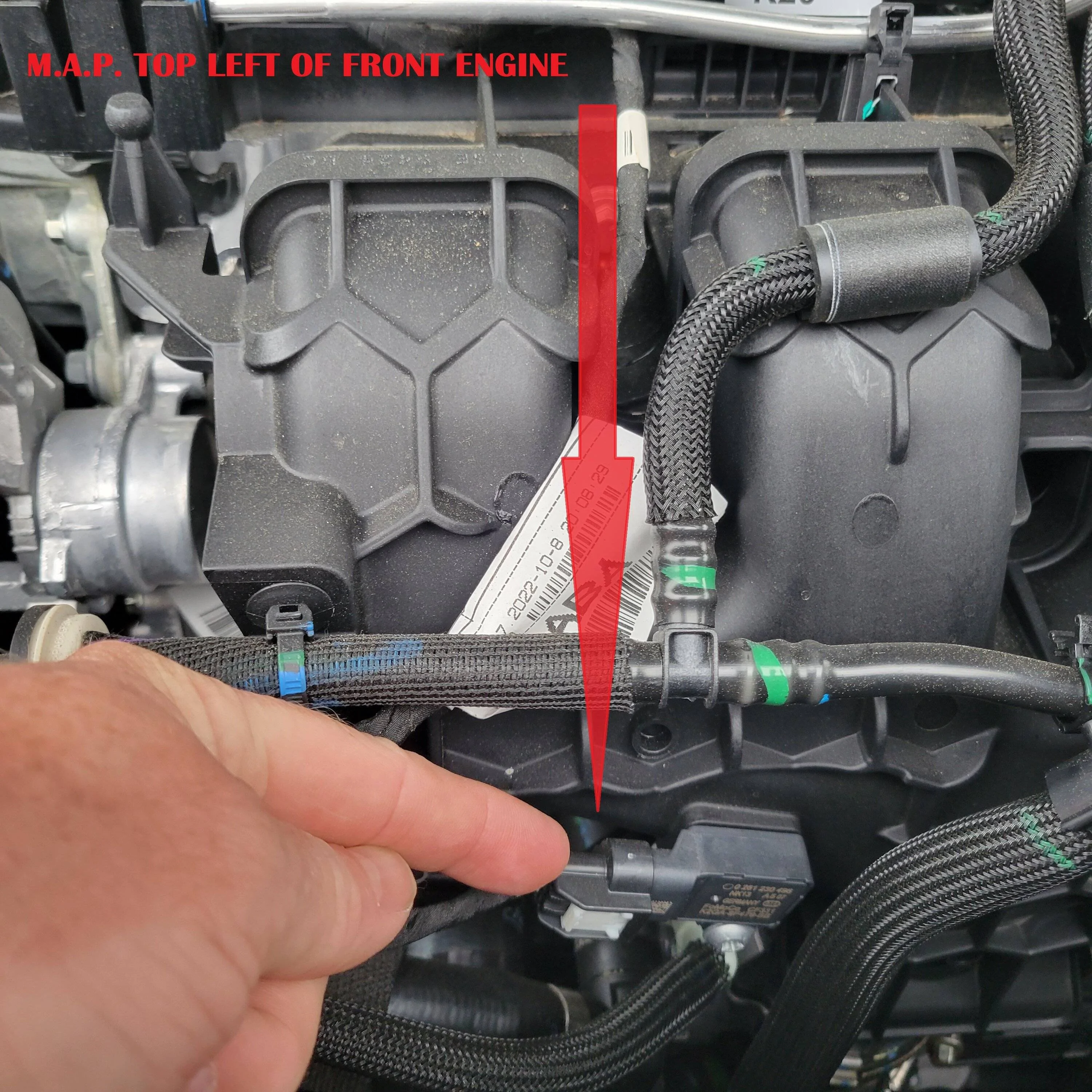

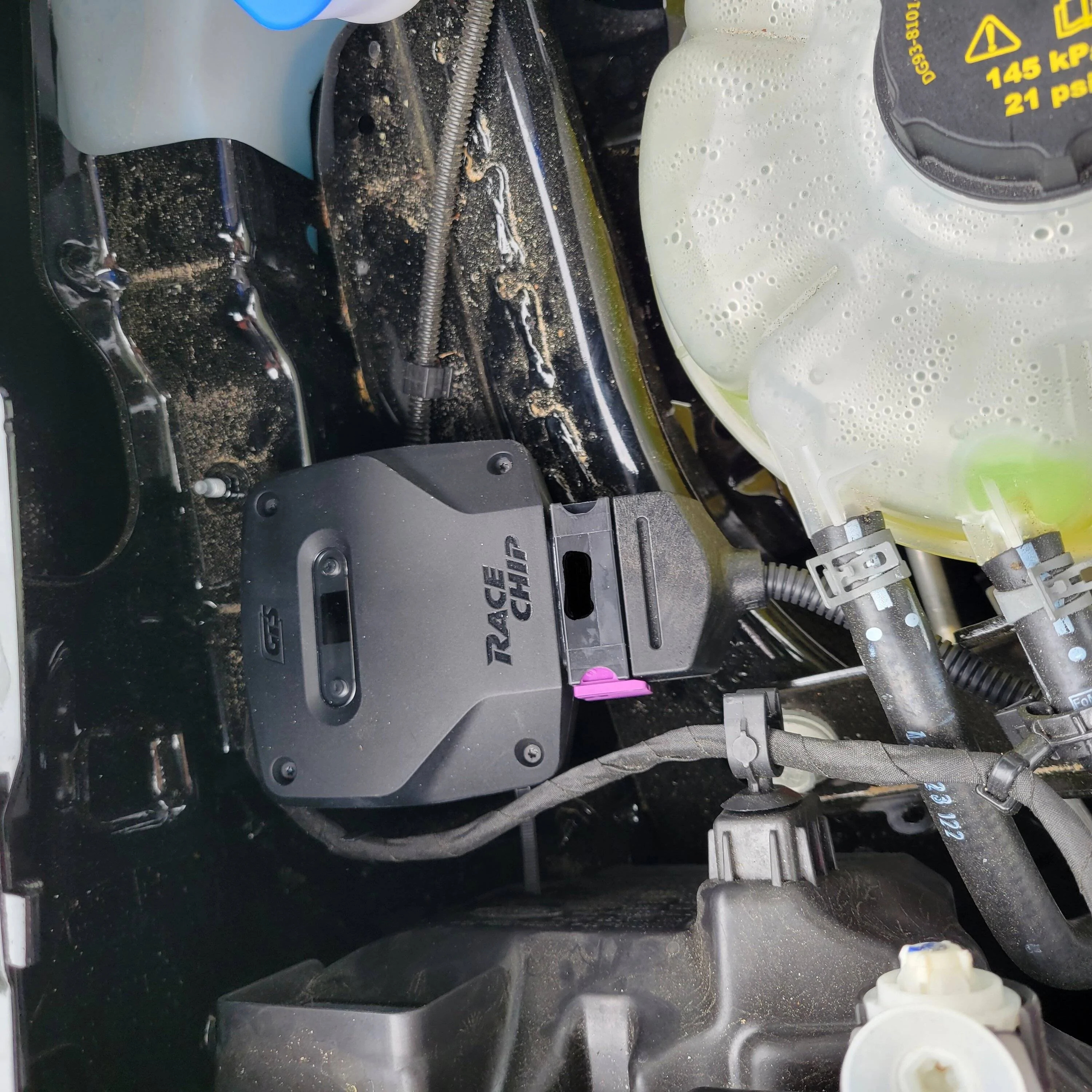

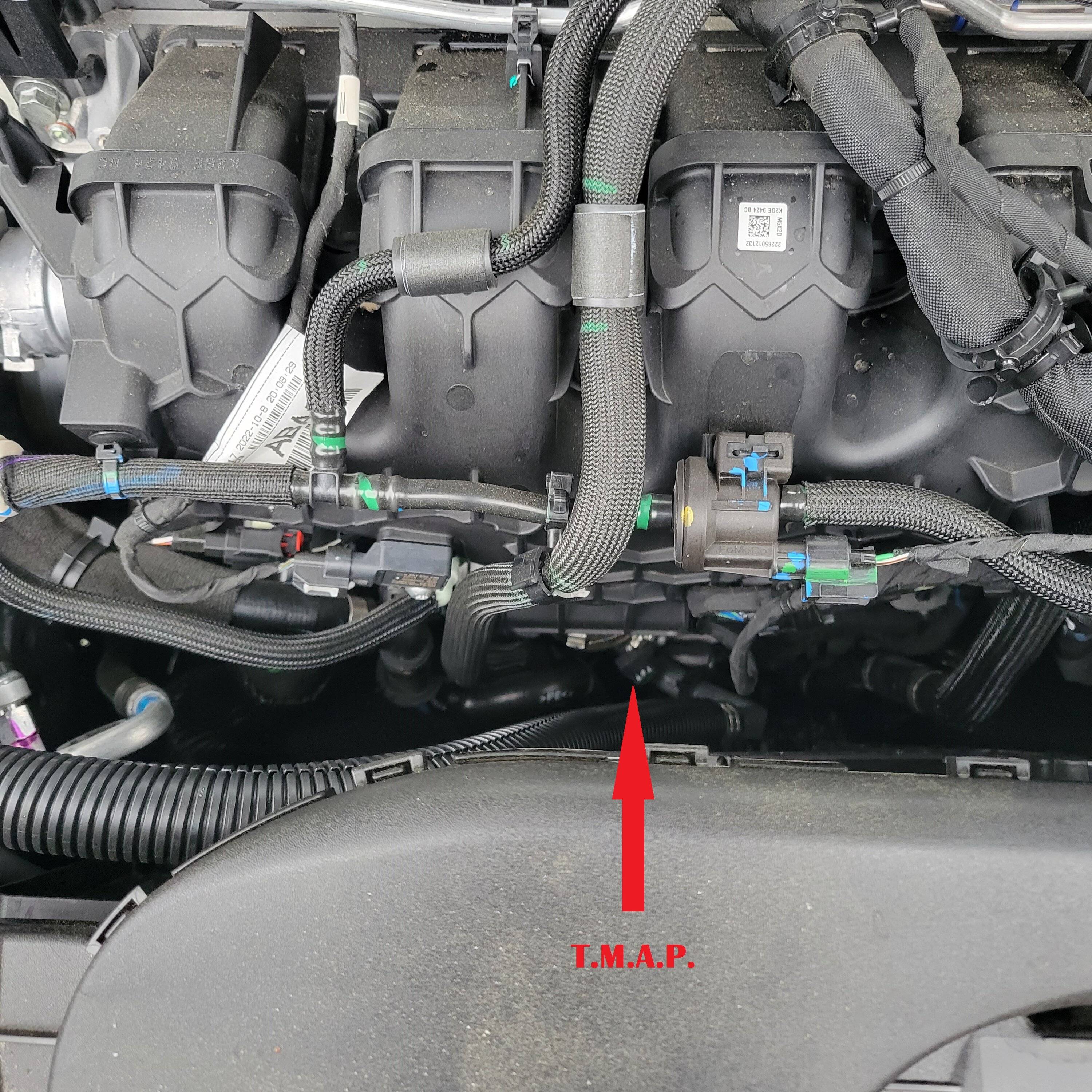

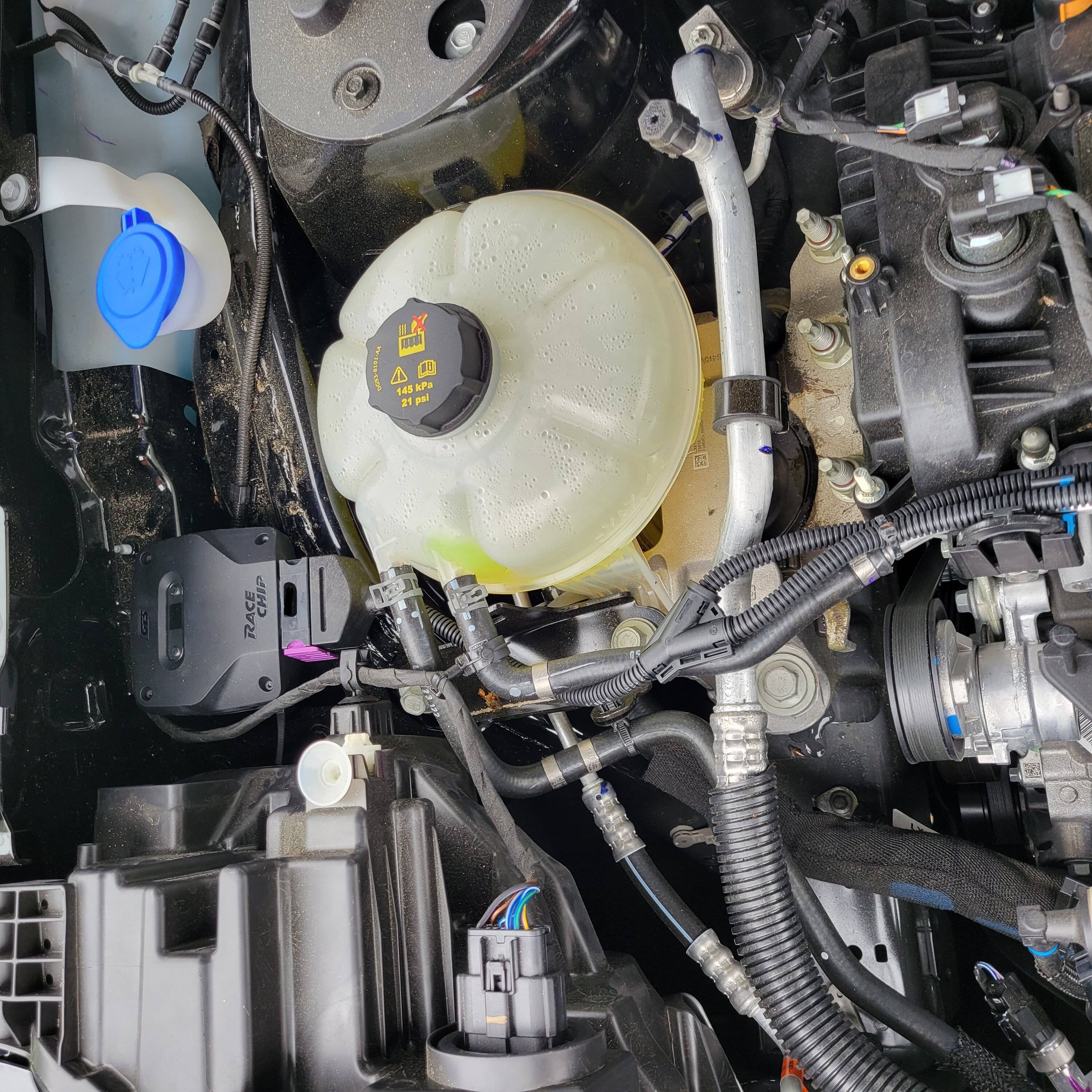

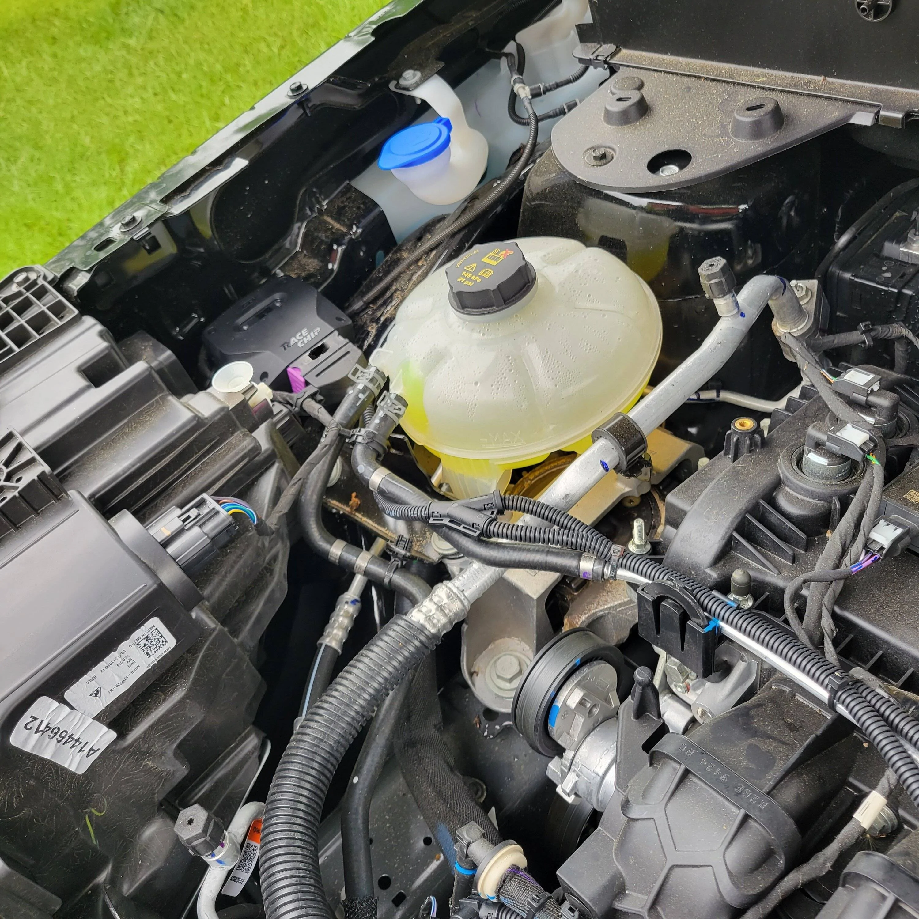

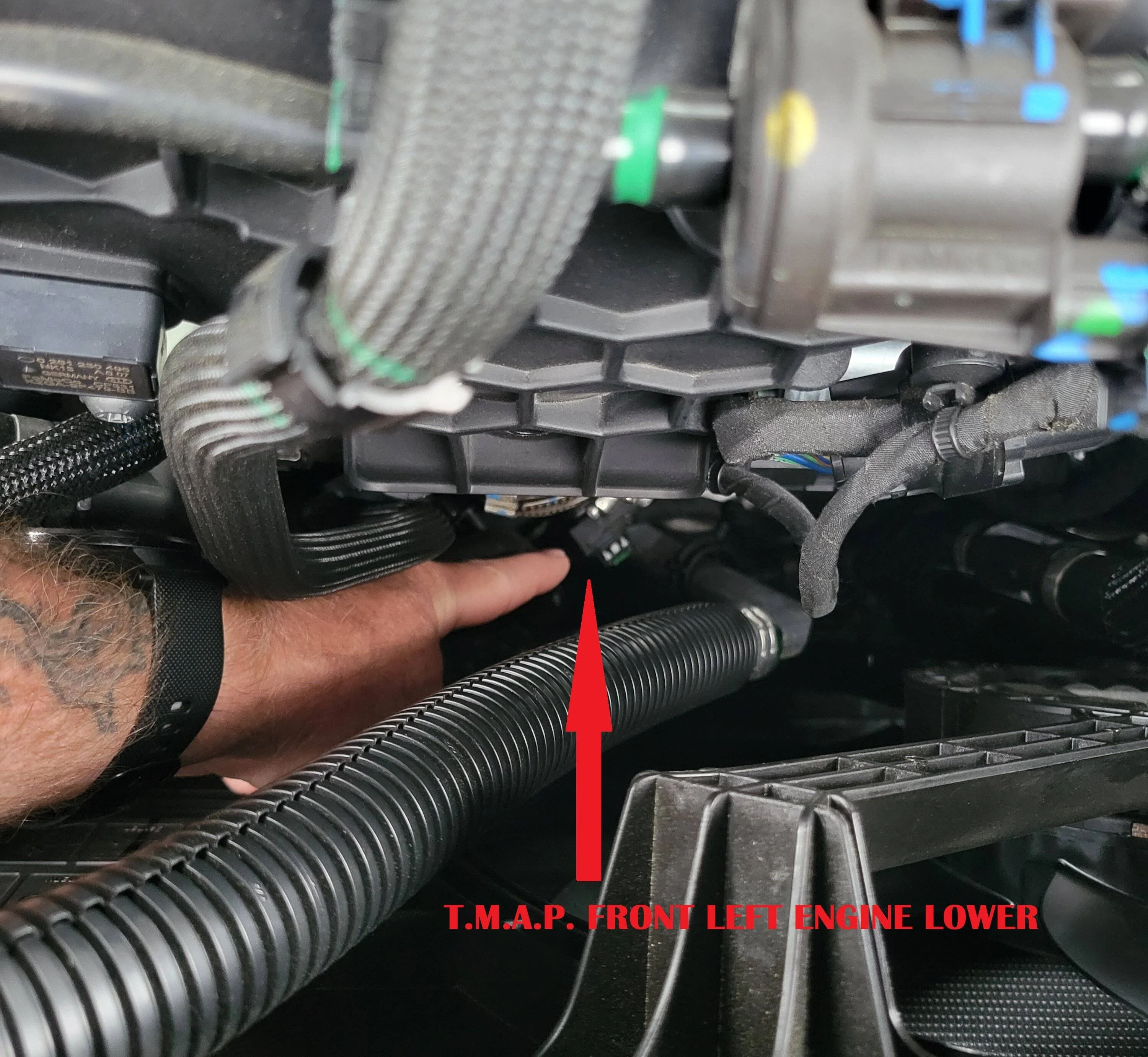

It could be less than 15 minutes except for...the T.M.A.P. location. It takes a really skinny arm to reach down there and unclip the connection where it is. Luckily I have a guy with a shop here and they have an employee with just such an arm. Otherwise, it was literally plug-and-play. Just follow the instructions to "kill" the electronics before you start...unplug the stock connector, plug theirs in, zip-tie the wires away from direct heat or moving objects, and drive away. I think my line routing was the most logical, you can see where they run from the CPU across the top of the engine and then down the front. That hole next to the fluid reservoir was a perfect spot for the CPU to mount. I think all in all we had a total of 30 minutes of actual work. The rest was mainly confirming the instructions and where to run lines.
