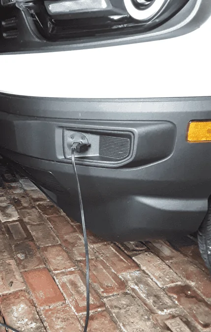

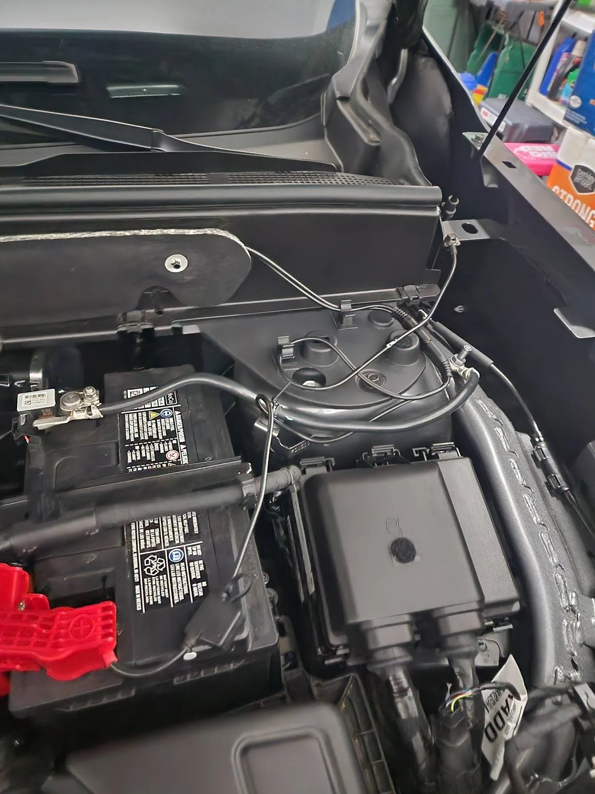

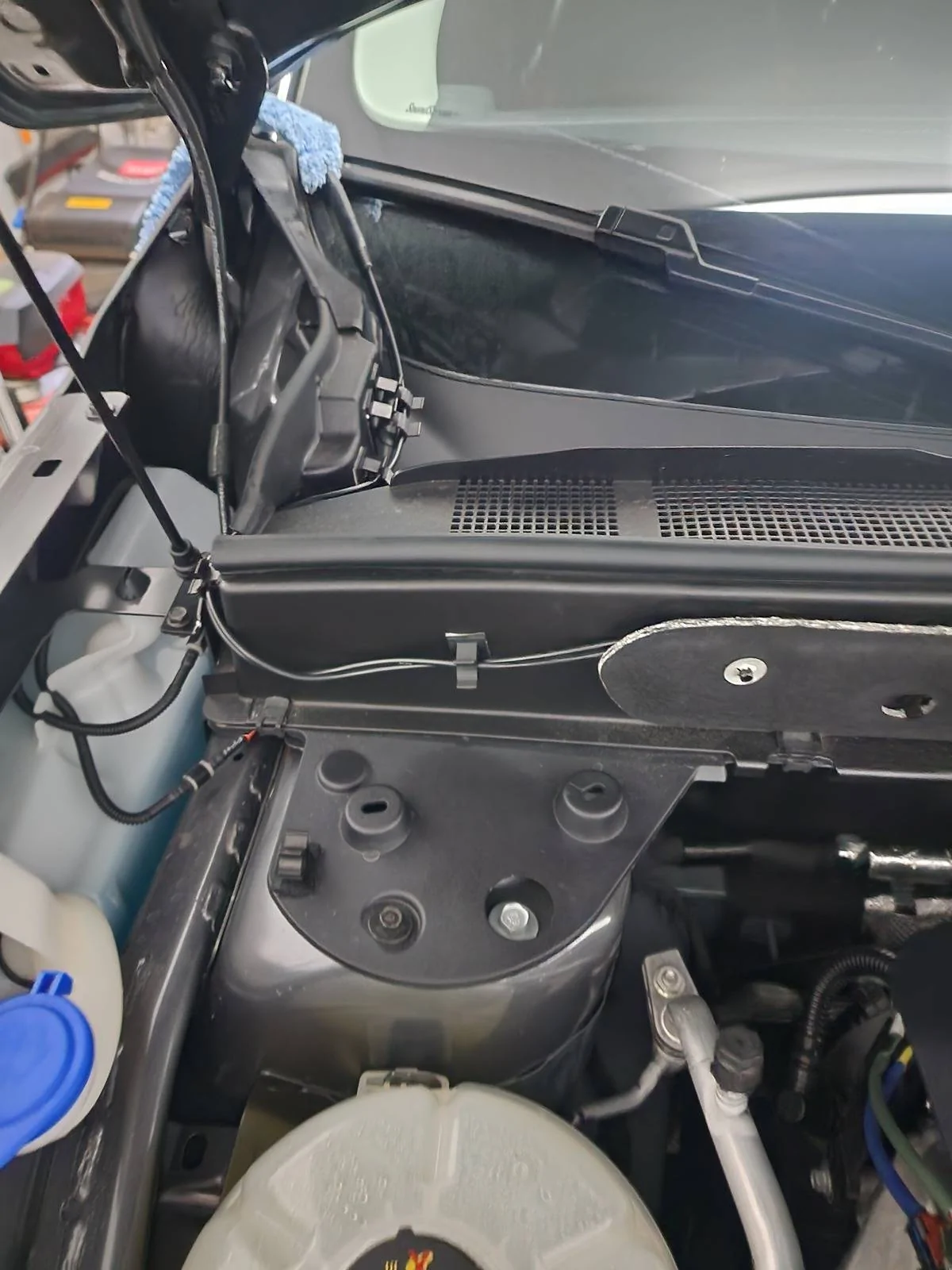

Major Kong
Major
Mar 5, 2022
1,209
2,910
Right Here Right Now
Bronco Sport aka "Spark Plug"
Ford Bronco Sport Questions about Battery Tender 1712862376947-ls
Ford Bronco Sport Questions about Battery Tender 1712862572849-rg
exterior access
no frog lights so perfect location
weatherproof/dustproof 12V
skinny ole spider monkey arms could only reach so far to explore cavity
flashlight penetration compromised by multitude of components
bows head
silent prayer
proceed to drill blind
small exploration hole to feed fish wire
feed feed feed feed annnnnnnd BINGO
wiring doable
drills larger hole to accept inboard side of connector
*note limited space to accept connector on interior side of bumper*
hot glue and screw
tidy up the wire routing
close the hood
big smile
