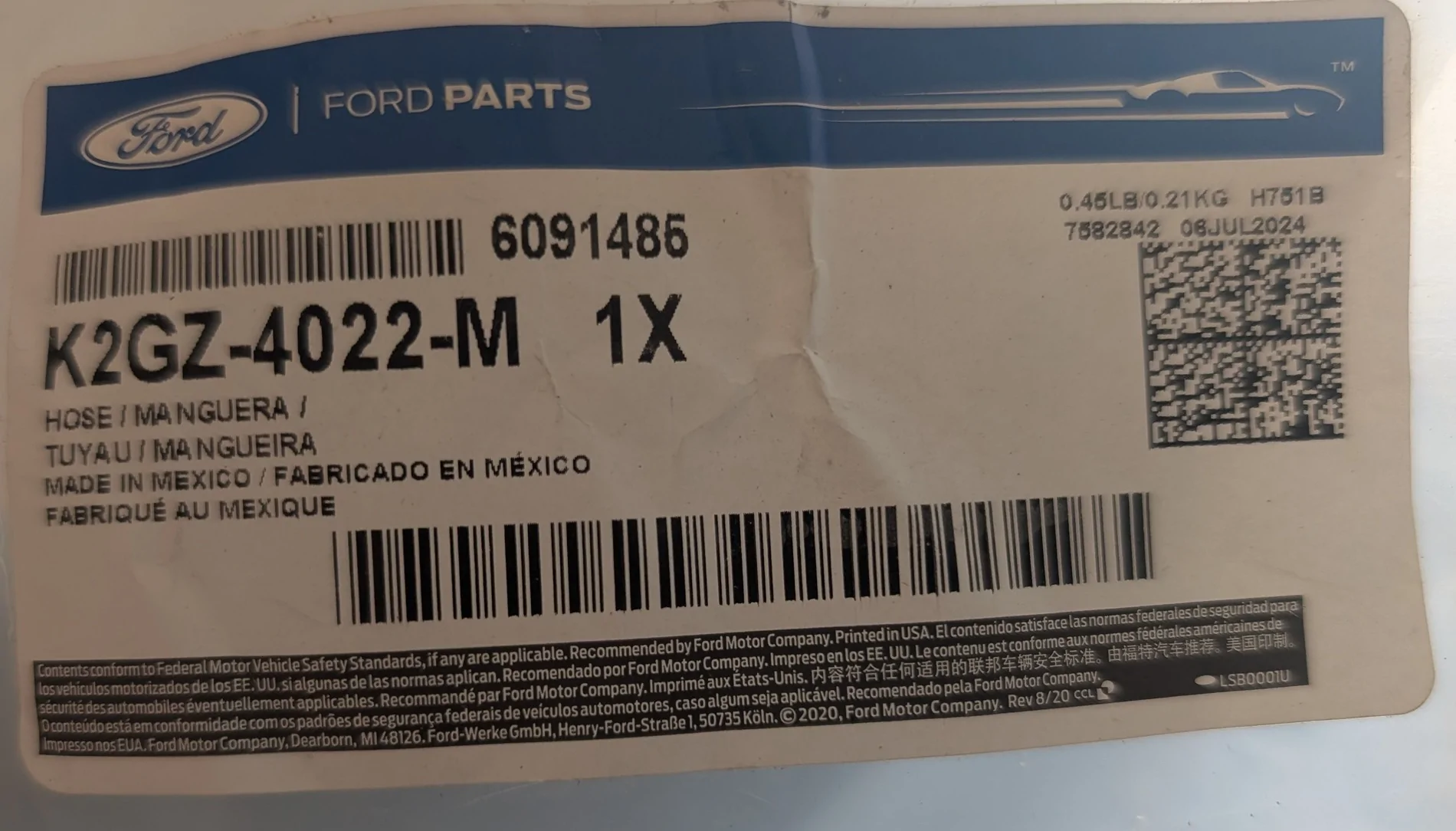

I've heard talk of this vent hose but haven't checked to see if mine has had it installed yet or not. I'll look into it this weekend. I will say that the fluid that came out of the RDU did look pretty clean all things considered. But that doesn't mean that the improved vent is necessarily installed. I do plan on getting it off the pavement before too long so any improvements to reliability I'm all ears about.
That being said, is it pretty easy to tell the difference between the two? Like will I know if it has it or not just by looking and having no point of reference?

If you look up TSB 24-2185 it shows and tells you everything you need to know. If you can't find it, let me know and I will try and save a copy from service data and upload it
Pic showing RDU vent hose is:
https://static.oemdtc.com/NHTSA-PDFs/MC-11010795-0001.pdf
There is also TSB 25-2351 RDU TECHNICAL SERVICE BULLETIN Chatter/Shudder During Low Speed Turning Events
https://www.broncosportforum.com/forum/threads/new-tsb-25-2351-rdu-technical-service-bulletin-chatter-shudder-during-low-speed-turning-events.16807/

This is the updated vent hose part number.
Ford Bronco Sport PTU and RDU fluid spec sheets PXL_20250813_174732345~2

Thanks everyone, this is seriously helpful knowledge. I'll take a look at it this weekend to see which one is installed. If it turns out to be the older version (as I suspect it will be) then the updated one will be next on my list of things to do.
It looks like a fairly straightforward job, has anyone done this themselves? Drilling holes into the wheel well would make me sweat a little.

I have done a few, just put a drill stop on the bit about a 1/4-3/8" from the tip. Ford has a stud sert that requires a special tool to mount the extended part of the vent hose. You could use a 1/4-20 but sert or something similar.
