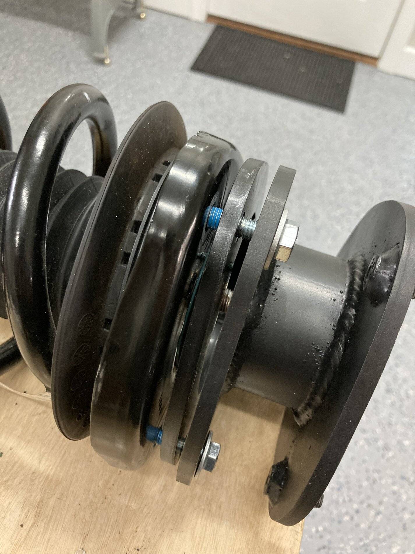

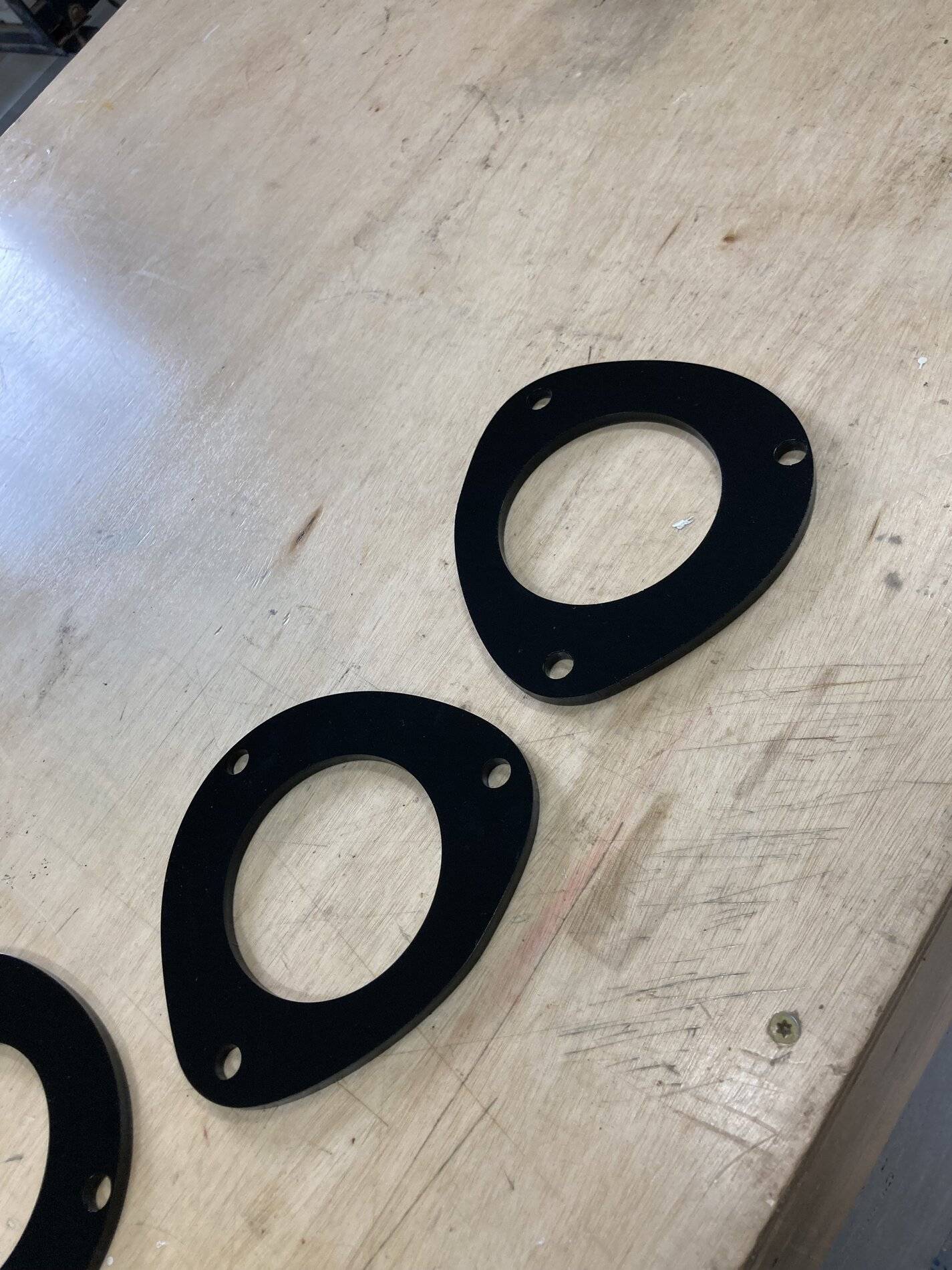

Many have experienced clunking after installing aftermarket leveling kits, I think I have possibly figured out the problem. There needs to be clearance on top of strut for rubber gasket to "flex". these after market lifts compress this rubber gasket causing clearance from he top bolt. I designed and spacer and installed on my outer banks and solved the problem. Been driving with it for 2000 miles no issue so far.
Please DM me for more details and if interested in the product!
Ford Bronco Sport Potential fix to aftermarket leveling kits clunking! IMG_1094
Ford Bronco Sport Potential fix to aftermarket leveling kits clunking! IMG_1016-1
Ford Bronco Sport Potential fix to aftermarket leveling kits clunking! IMG_1014-1

2 weeks ago I installed a 1.5" leveling "puck" (my terminaology) onto my wifes 2021 Badland bronco. The first 6 or so days everything was perfect. The sunday after install, 8ish days, the clunk started. Mainly on the drivers side. It was a very bad clunk, when hitting a bump, stopping, starting, etc... If there was a stiff breeze this clunked. It felt like metal parts rubbing against each other, but not the noise of metal on metal.
I took off the struts and removed the pucks for now as I dont have a fix. I agree with Kcura11 on the potential fix. I inspected both struts after removing. The mounting well, pop the hood to see it, has a swell at the top, roughly 1/4 inch high, from the level at which the bolts mount.
Based on Kcura11's thought, the spacer he designed will provide a space between the top of the strut from the puck. The passenger side strut was perfect. No sign of wear or tear. The drivers side did have some small chunks of rubber removed from the rubber that is exposed at the top of the strut.
I will be making my own spacers at Kcura11 did to see if it will fix the problem, and I cant see how it wont. I still can't figure out way the space is needed, but I cant recreate strut compression with my arms. More gym time needed.
When done I will report back on the issue. Not looking forward to doing it a third time.

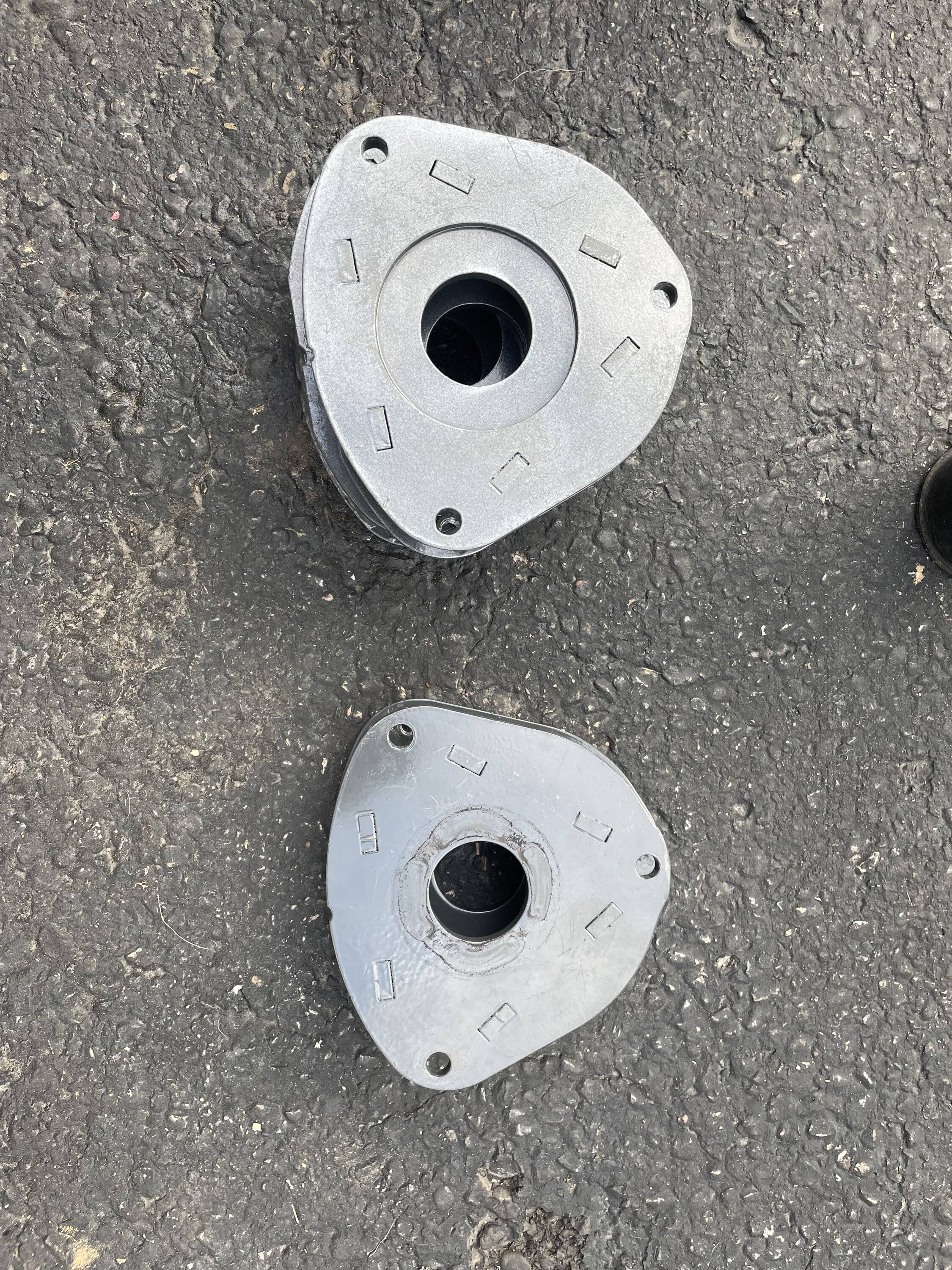

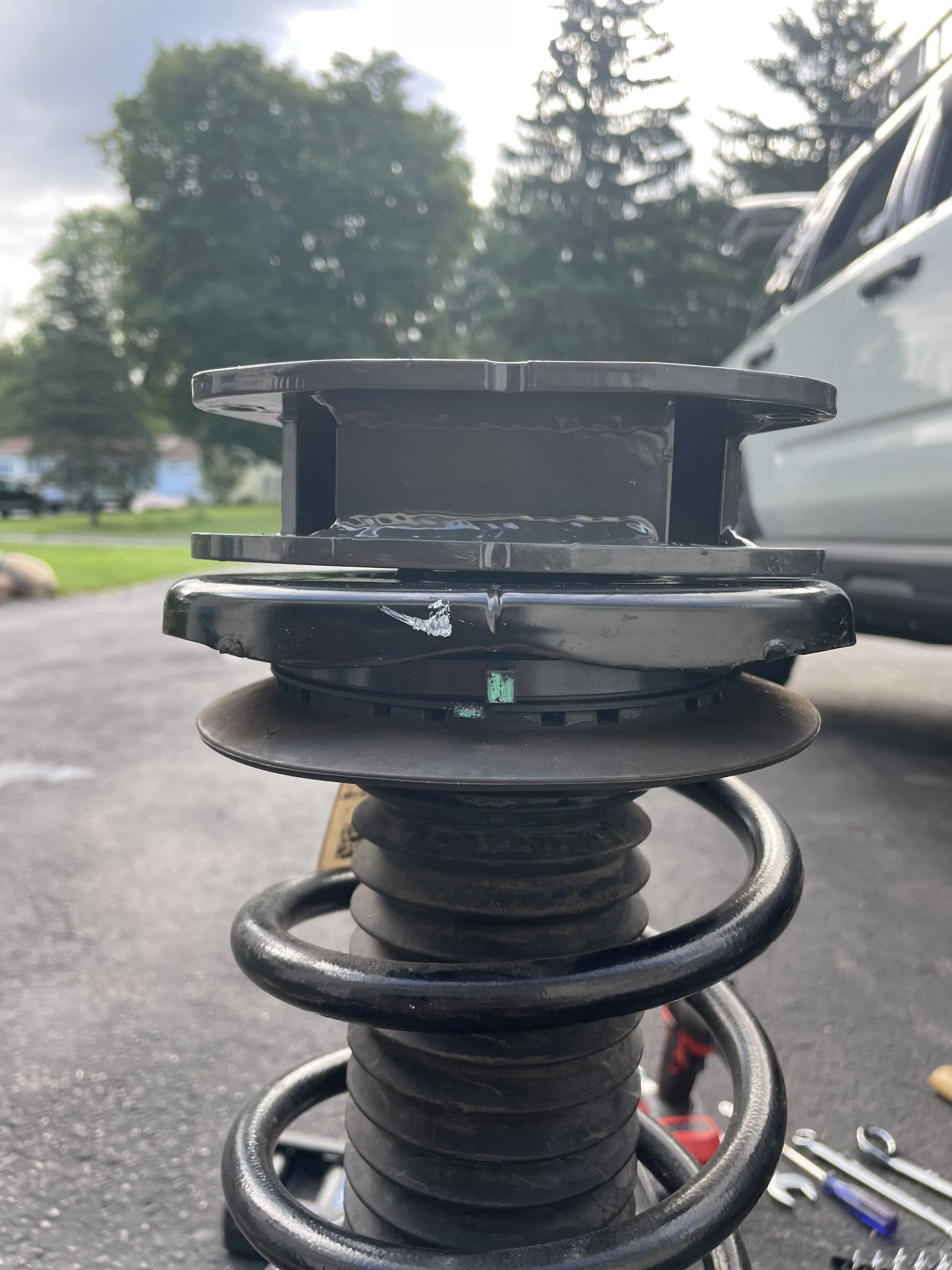

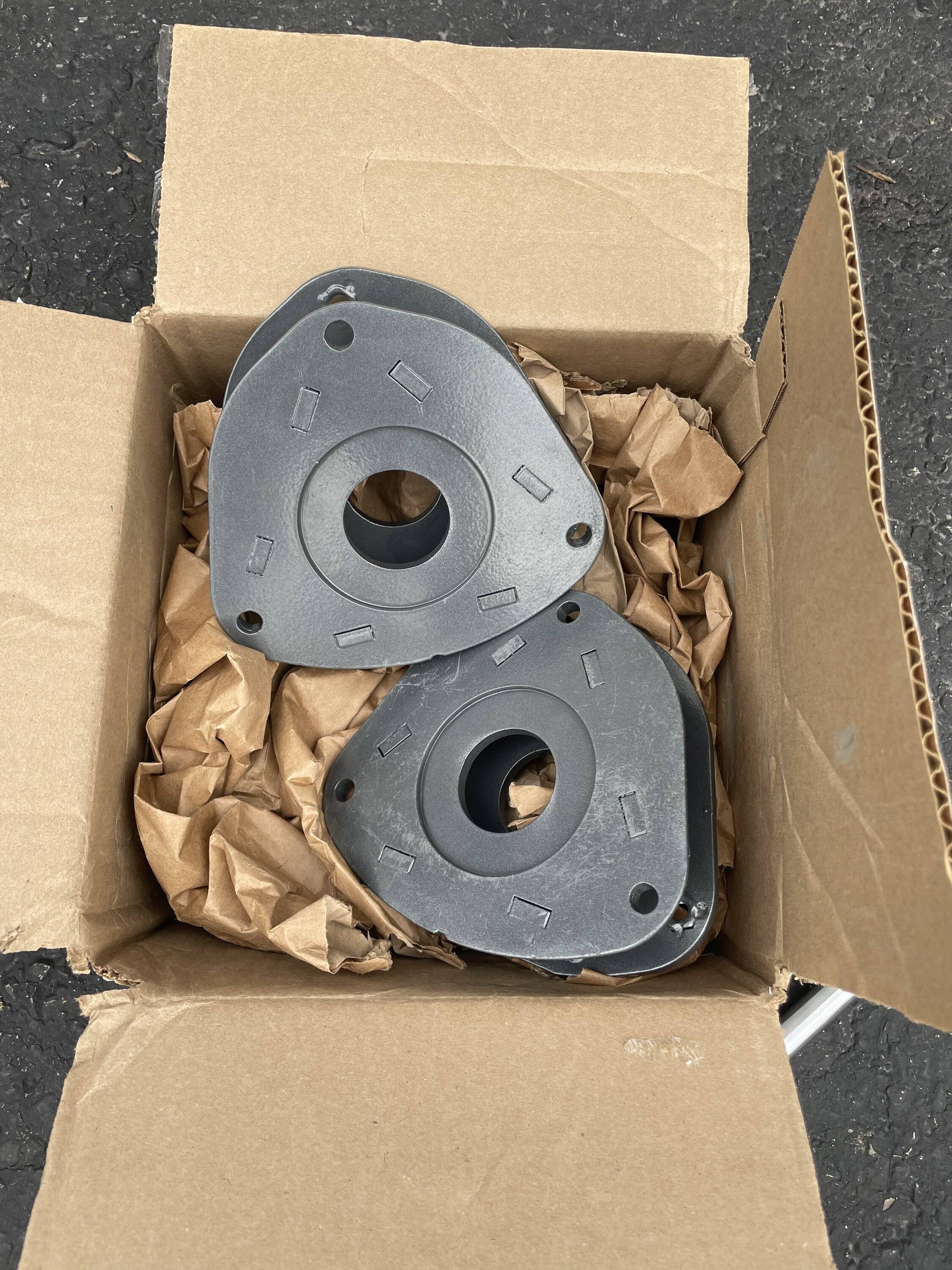

I recently installed the Belltech 1.5 in lift on my bs and are currently experiencing the clunking noise while hitting bumps. I reached out to Belltech directly and they have a new kit with revised parts and they are sending me the new parts free of charge. I’m guessing these revisions will be new front spacers and camber bolts? I will update when I receive them.
Ford Bronco Sport Potential fix to aftermarket leveling kits clunking! B50ECCFE-93EA-4D35-945B-D59B00661EAF
Mr.Grey
Paul
Aug 5, 2023
Rochester NY
2021 cactus grey bronco sport
update on the Belltech 1.5 in lift
New spacers came and looked great!
Spacers were installed this morning and clunking was fixed immediately. The Belltech customer service was very helpful and expedited the shipping so I could install them before my alignment. My only fuss with this kit is the lack of camber bolts but other than that 10/10 for ride comfort after installation. It’s not stock comfort but for running a lift kit and k02s it’s amazing for day to day. I’ll throw some pictures of the comparison of the old and the new spacers and the space in between the top of the strut and the spacer. I forgot to measure but it looked roughly a 1/4 of an inch of travel.
Ford Bronco Sport Potential fix to aftermarket leveling kits clunking! 3556E423-4B1C-4B53-8CD6-2E58E4D0EF64
Ford Bronco Sport Potential fix to aftermarket leveling kits clunking! 2A9A0229-B244-4AE1-9257-E518F85531CD
New spacer
Ford Bronco Sport Potential fix to aftermarket leveling kits clunking! DDFF1B83-F45F-469D-895A-C2C37C87C104
Old spacer
Ford Bronco Sport Potential fix to aftermarket leveling kits clunking! CE934870-1FEE-4F48-88F1-F93F593E8B9A
Ford Bronco Sport Potential fix to aftermarket leveling kits clunking! 0636196A-358F-4544-A948-54F63FB95E9A
