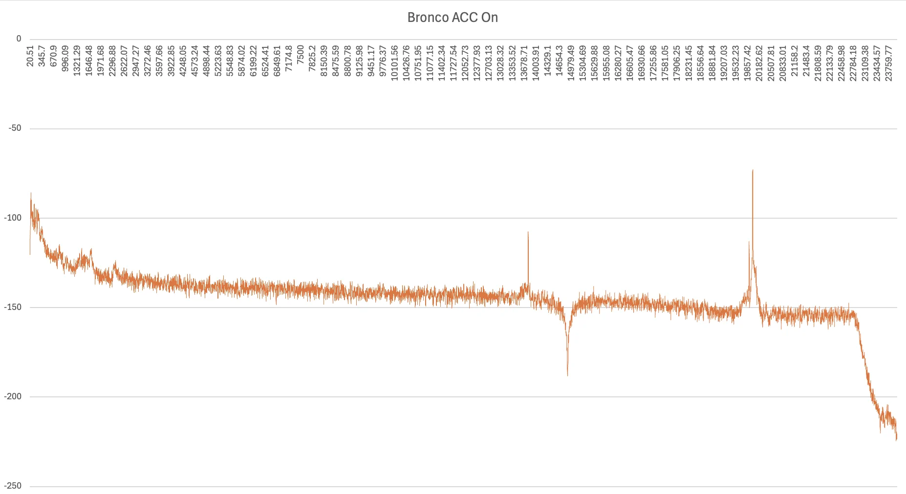

I just bought a new 2026 Bronco Sport Badlands with the 2.0L - overall I'm really enjoying it, but there are a handful of small issues, the most annoying one being a persistent annoying tone audible in the cabin at all times. I've started digging into its origins, and I think I know where it is coming from. Here's some high level notes:
  • The frequency of the tone is ~13.8 kHz. High pitched, but solidly within the spectrum my ears can easily here. About half the people I take in my vehicle can hear this frequency, mostly the ones below 35.
  • The tone is not present when the car is "asleep", but as soon as I click the unlock button of the FOB, the engine bay makes a bunch of clicking noises as systems turn on, and when the various self checks complete, the high pitched tone is clearly audible, even over the headlight fans, and soft music playing in the cabin.
  • From this point on, the annoying whine is present regardless of engine operation, and only goes away after parking the car, shutting off the engine, locking it, and waiting about 5 minutes for things to go back asleep.
There are several things I know that the noise is *not*
  • It is not anything in the engine. The noise is present with the engine off.
  • It is not the headlight fans, I unplugged those to rule them out, and make it easier to track down the source.
  • It is not the center display, or the HUD display, and the tone does not change when brightness of either is adjusted.
  • It is not the inverters for the 120V plugs.
  • It is not the fuel pump.
  • It is not coming from any of the speakers.

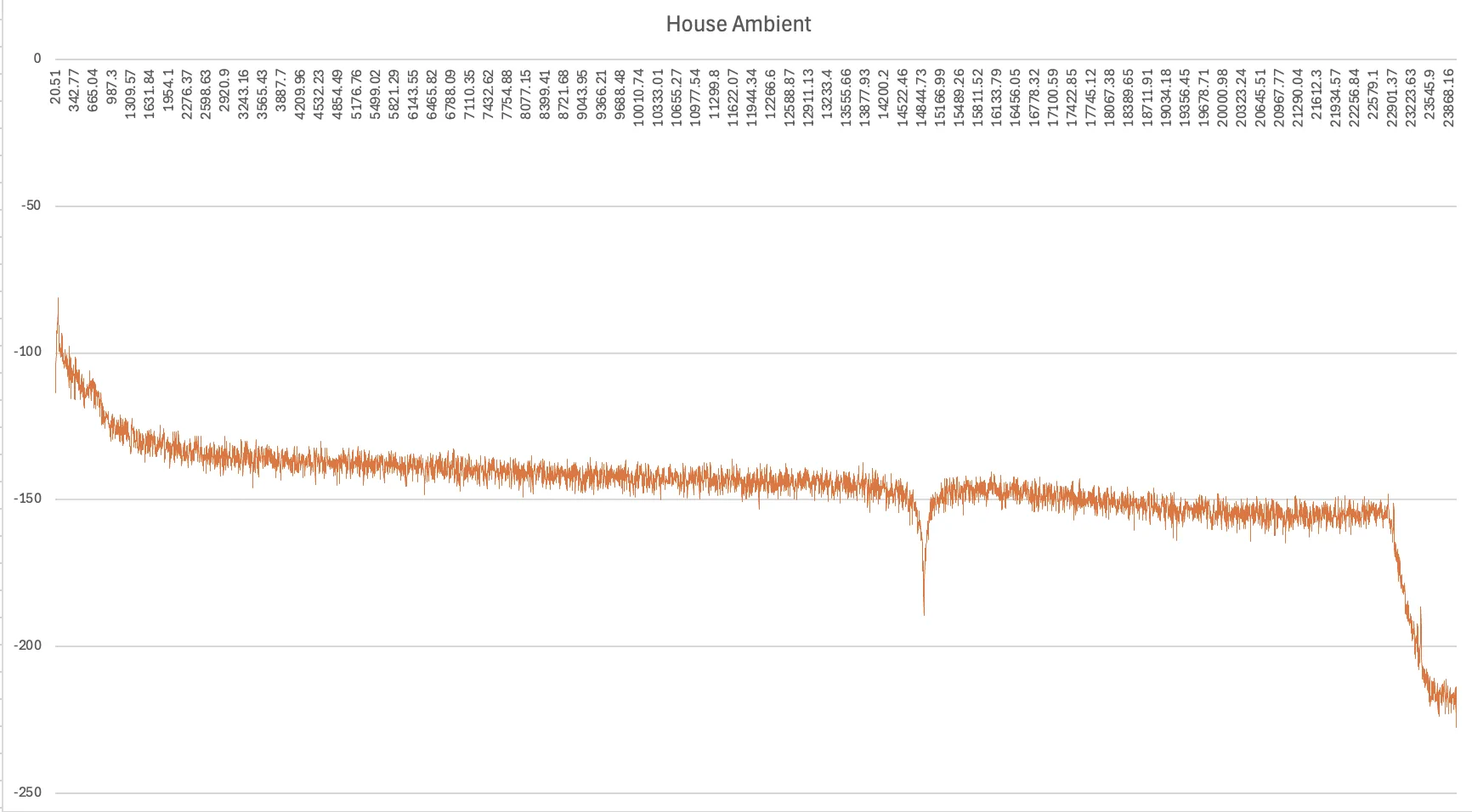

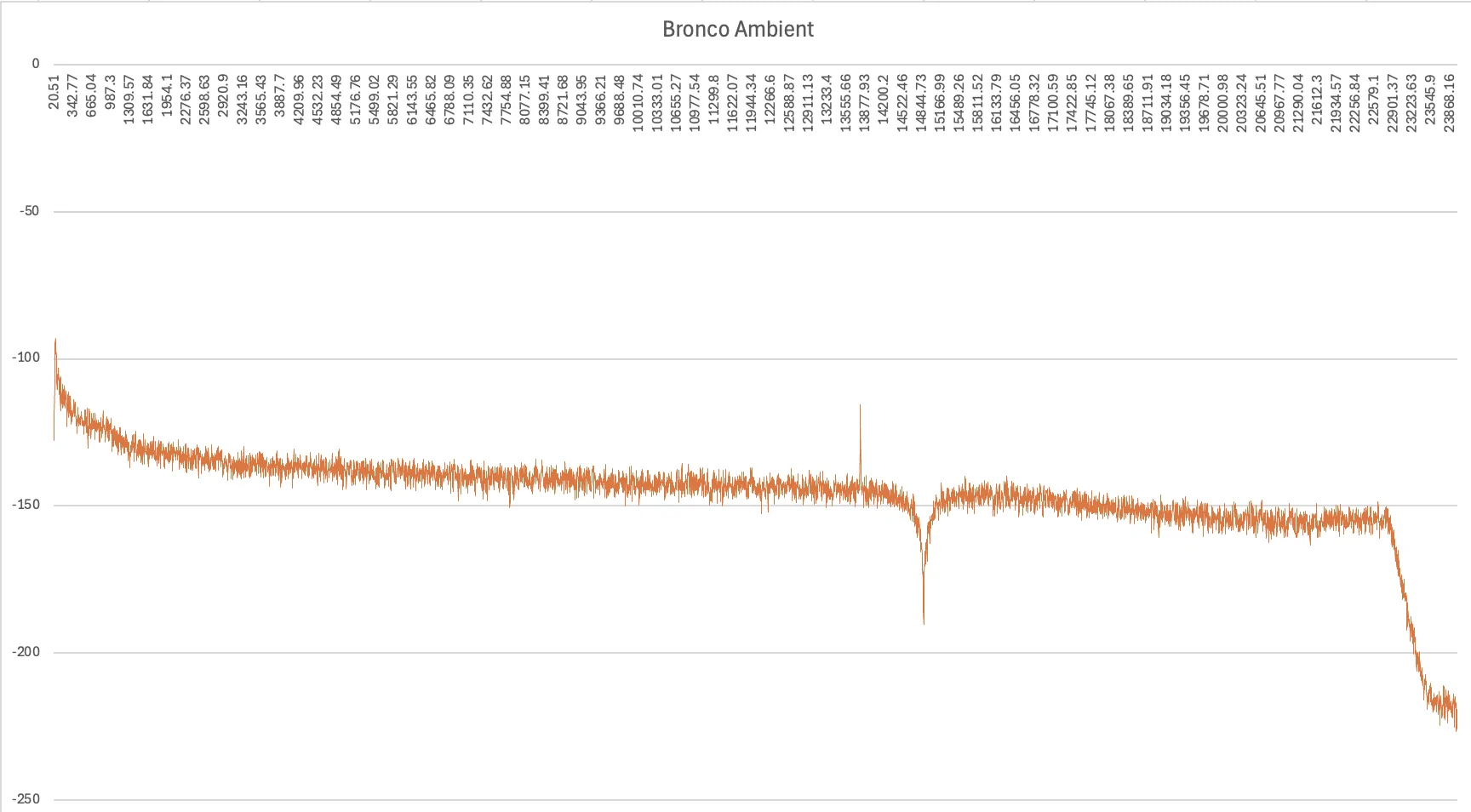

I took a few spectrum captures using a pretty slick website and my macbook pro: https://noisemeter.co/sound-spectrum-analyzer/ And while probing around, it became fairly clear that the noise was emanating from within the hood. I am pretty sure it is coming from the electric brake booster. This would make sense, as my friend's 2022 Bronco Sport 1.5L (which has the older style vacuum brake booster) does not make this annoying tone, it is totally silent in the cabin.
So my question to you all - Is anyone else experiencing this in their Bronco Sports? It is driving me nuts!
I'm worried that it is "normal" with this particular electric brake booster, as I found some videos of someone testing the Ford Maverick brake (which uses the same electric brake booster as this 2026 Bronco Sport Badlands), and I can hear the exact same 13.8 kHz noise in his videos! Is there anything I can do about this?
I attached a few spectrum plots, there's a ton of noise at 20 kHz when turning on the displays, luckily this is too high pitched for most adults to hear (including me), but the 13.8 kHz noise is an egregious oversight by Ford, as this is well within the range many adults can hear.
