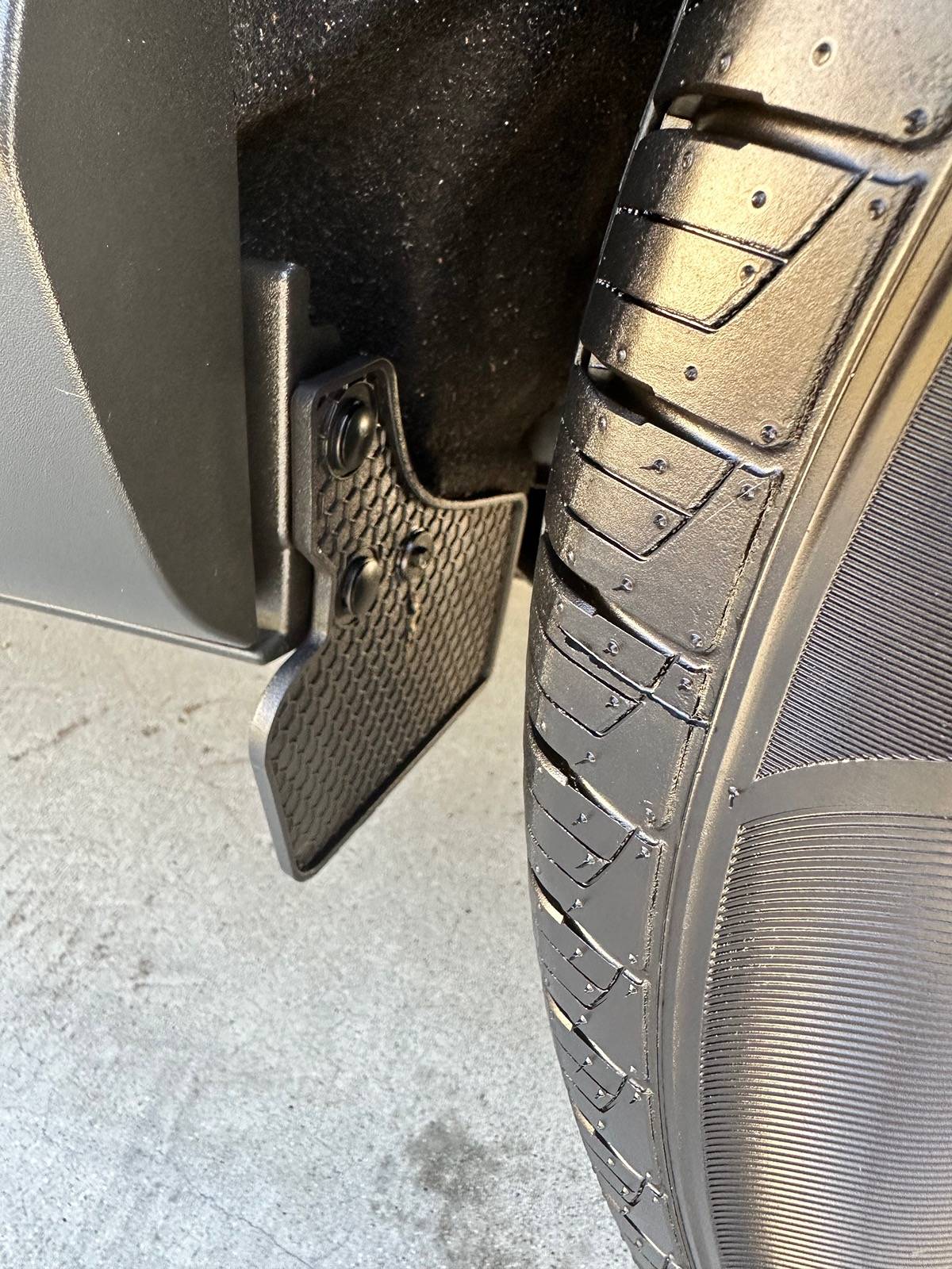

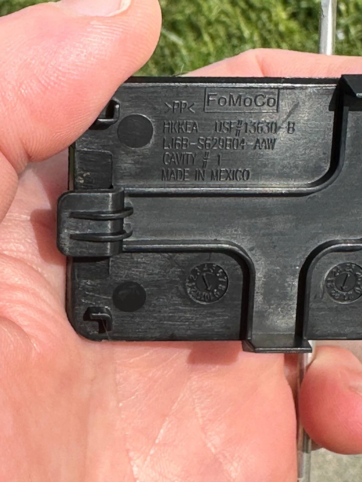

Hello I have a 2022 Big Bend and while cleaning it I noticed that the plastic caps that cover the fasteners for the passenger front seat are missing. I pulled one of the caps on the driver's seat and it has part number LJ6B-S629B04-AAW on it but when I type this in on the Ford parts sight, it indicates it isn't a valid part number. I've attached a picture of it. Separately, there is a little plastic "mud flap" on the plastic rocker panel on the driver's side, but missing on the passenger's side. I can't seem to find this part (or part number). Anyone know what this part number is? I also included a photo of the one I have on the driver's side.

Ah, I should have indicated that the deflector is at the rear wheel. Thanks for the suggestion. Unfortunately the parts person at our local dealership is old and grumpy.

Lucky man, the part # for the rear passenger side air deflector is (drum roll)
M1PZ-5811398-A. This comes with the screw. The two push pin fasteners have to be purchased separately. (AUVECO 20988).

Michael, thank you so much - you are a rockstar!
I guess the seat cap part number is LJ6Z-78672A40-AA
