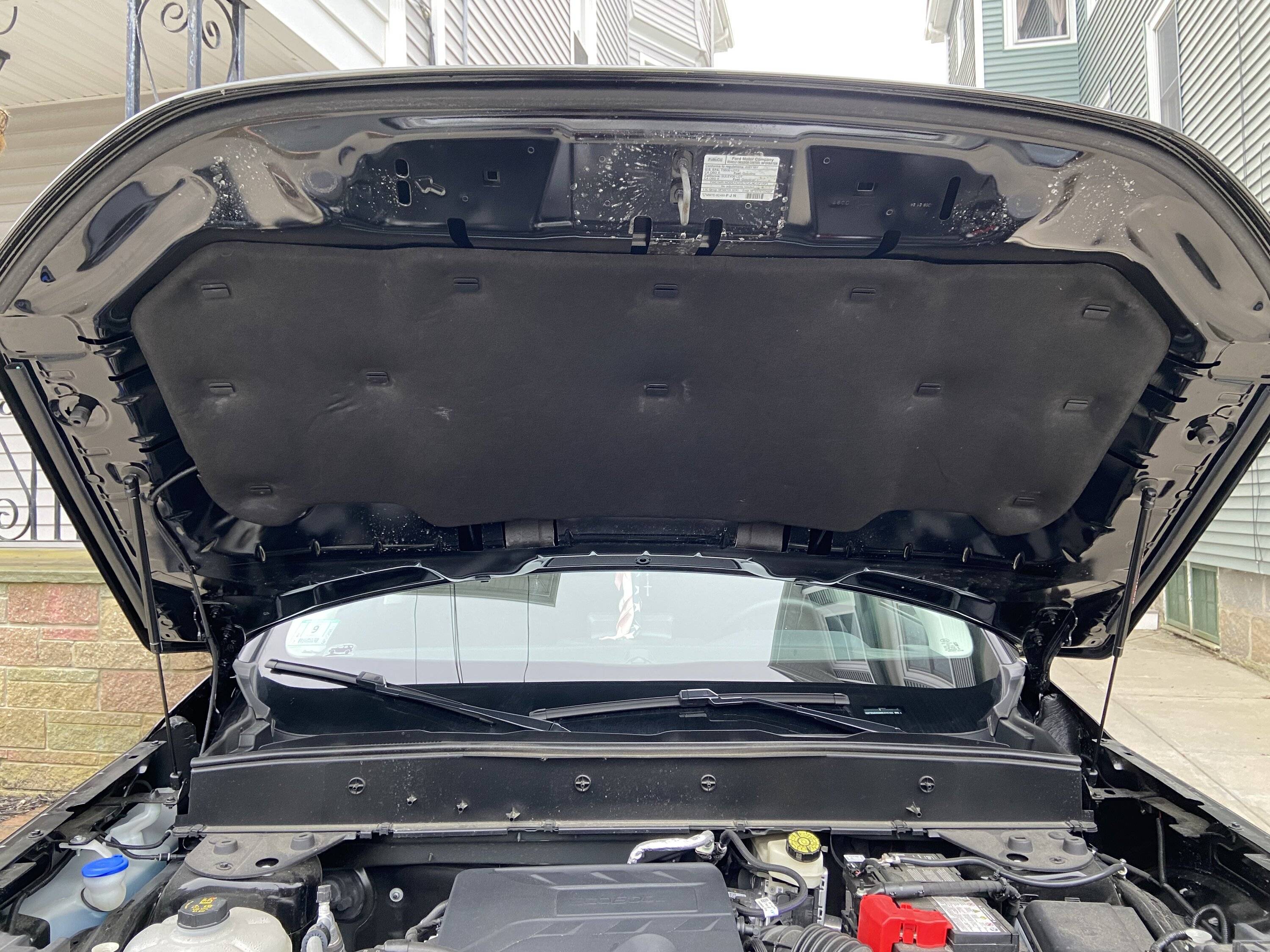

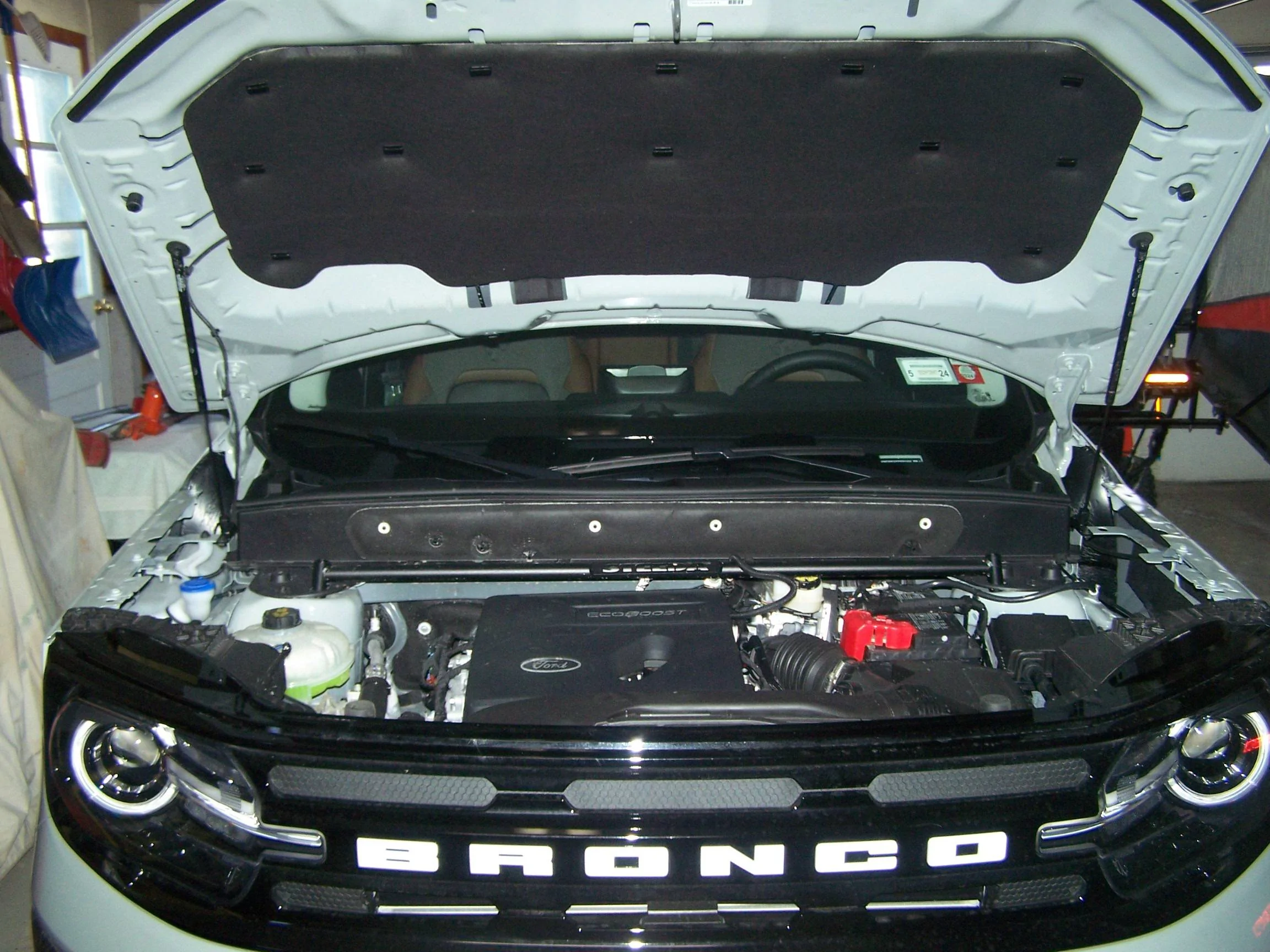

I just installed # M1PZ 16738 B on my '23 OBX. Hoods are all the same between years. Dealer got it in 3 days. A perfect fit with necessary attaching clips. Simple 10-minute DIY project. Pricy though at $202.42.
Ford Bronco Sport Part Number for Hood Insulation (2022 Bronco Sport Outer Banks)? 100_6558
