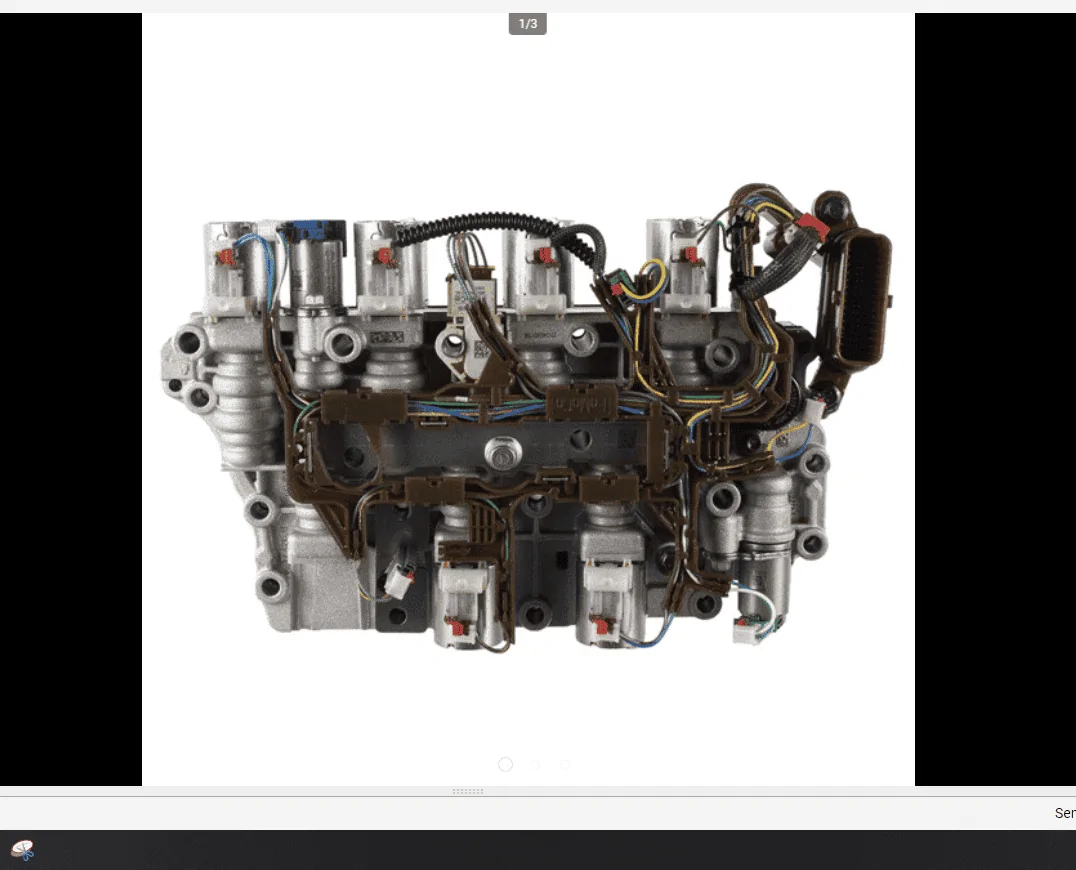

Late to the party but this guy tears down the whole transmission and is very detailed. Mentions torque specs on a few spots.
My question to you is, where are the solenoids located in relation to the drivers seat? Are they just on the other side of the firewall near gas pedal by chance? I have this electrical clicking noise that happens when my transmission shifts , it went away over the winter but now it’s back and driving me insane and I have a feeling one of my solenoids are glitching out
