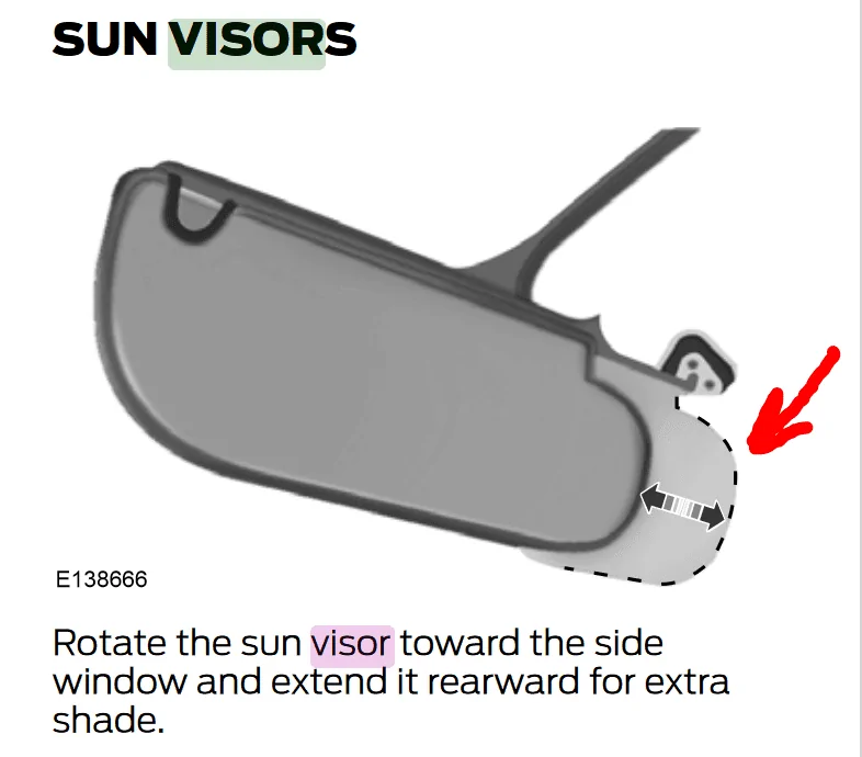

vid 4:55 (nice vid btw)
not sure if you've tried it or not yet
visor horizontal shift.
