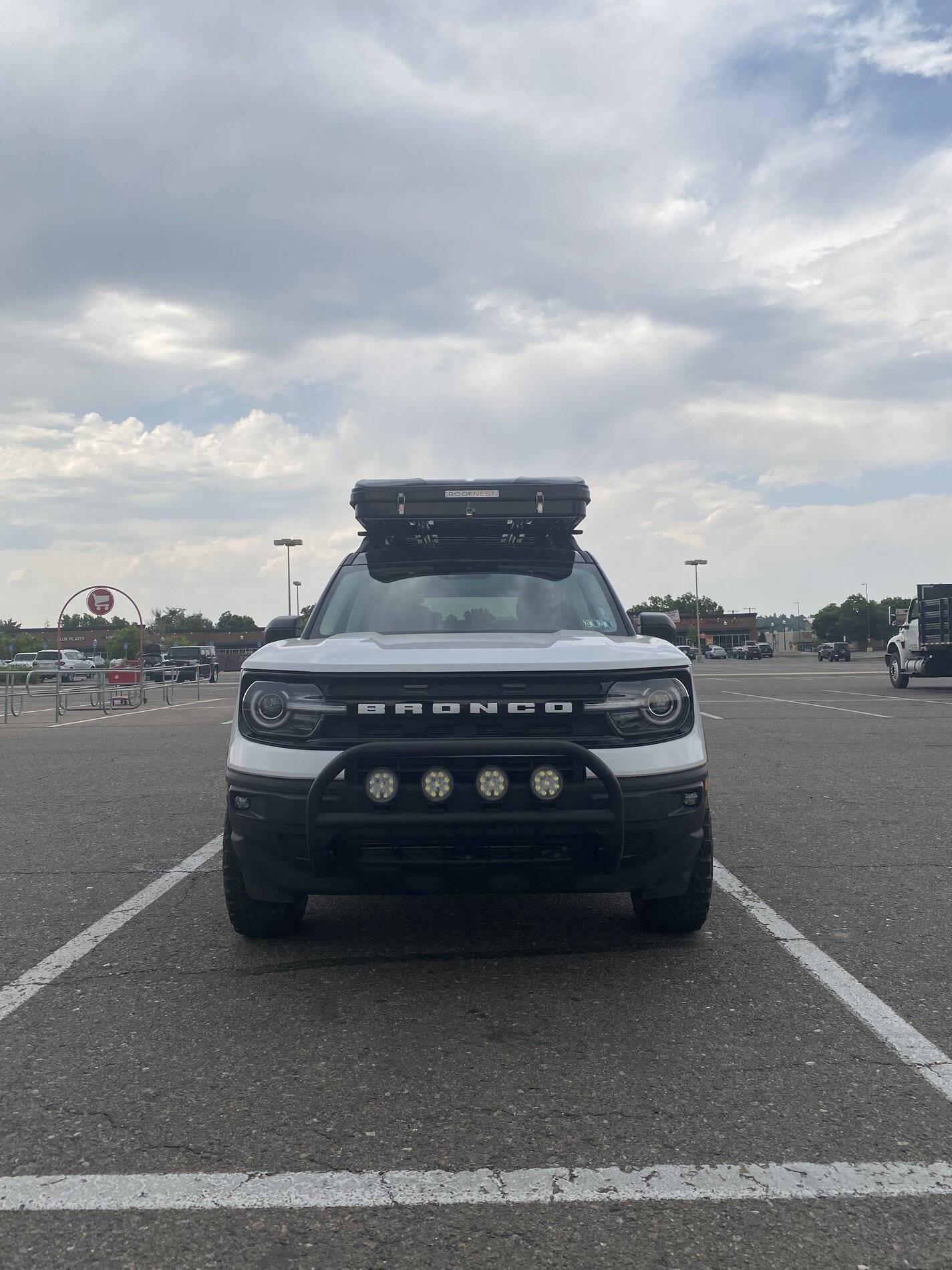

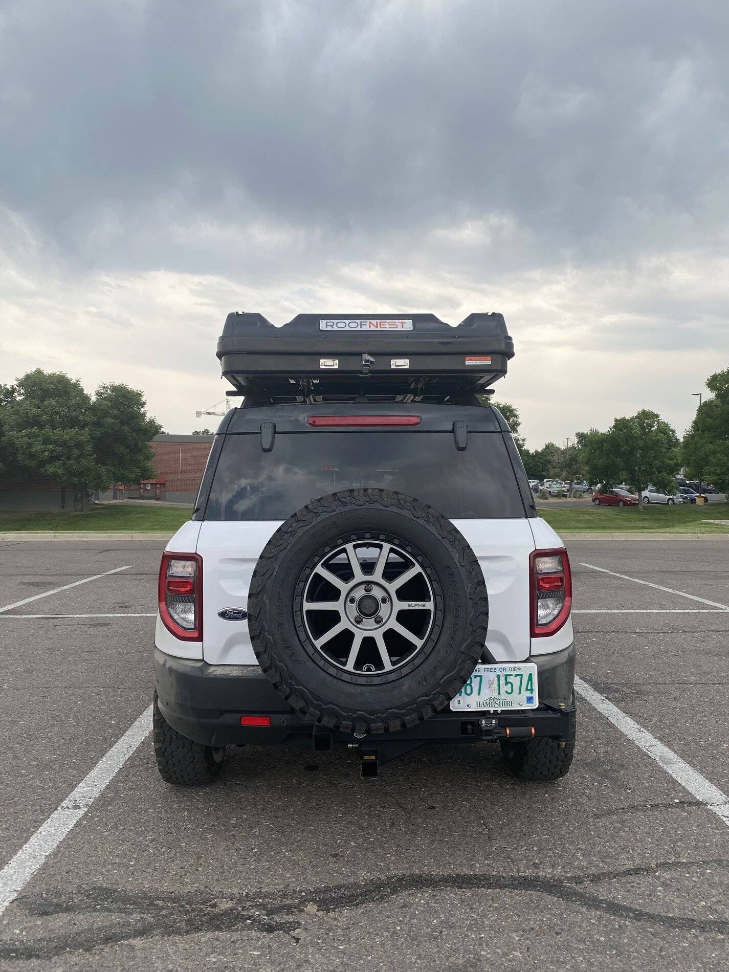

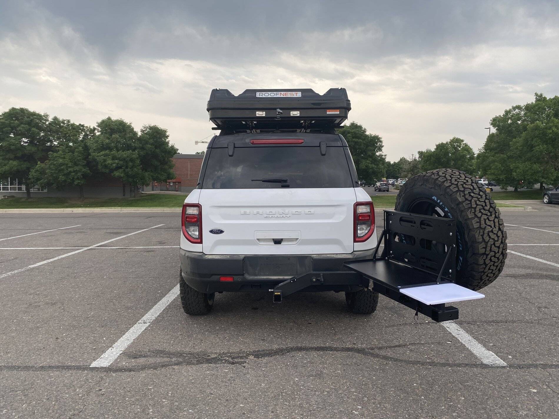

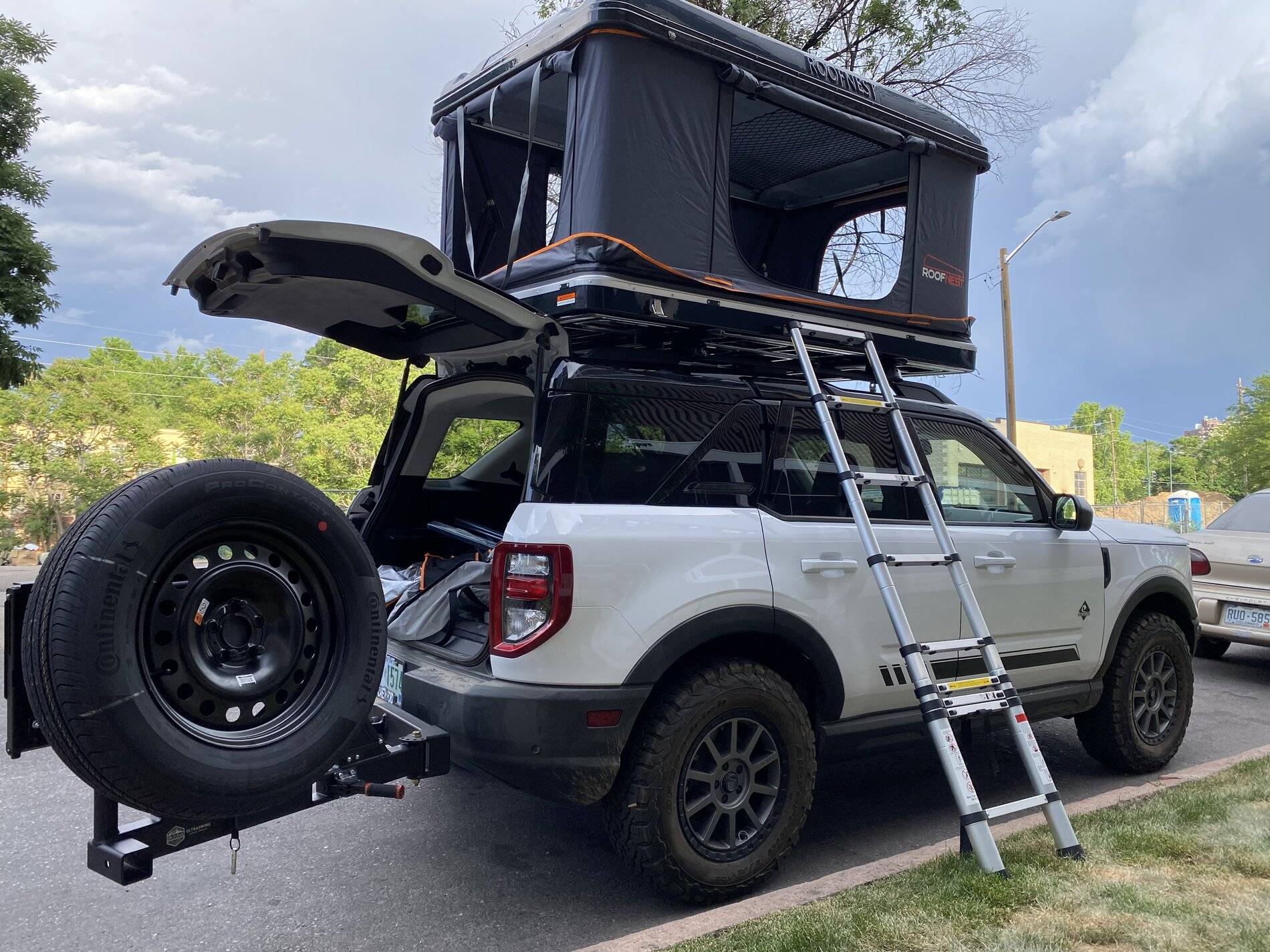

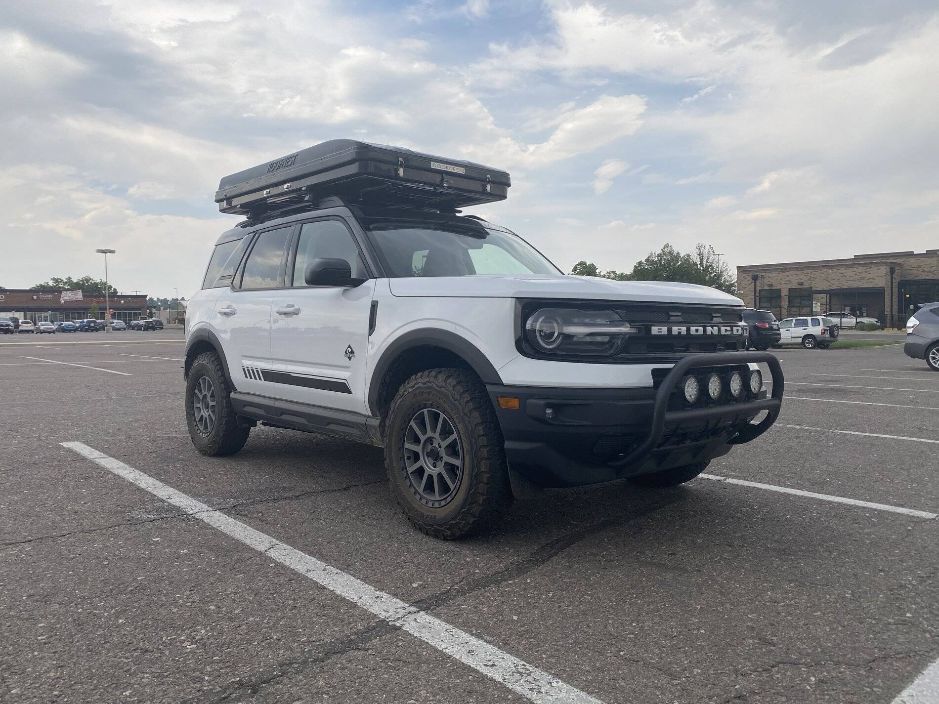

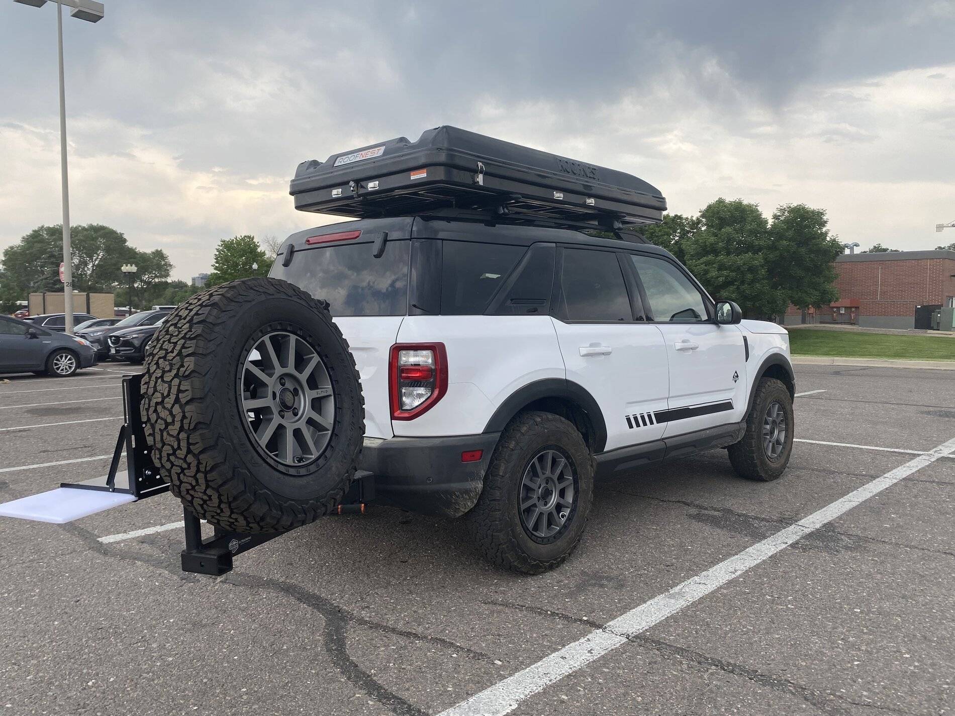

I've been working on some exterior mods to my OB edition to get set up for overlanding out here in CO. Really excited with how things have been turning out so far.
The only minor issue I've faced is with my RC lift. I took it out on a moderate off-roading trail and started noticing a clunking coming from loose sway bar bolts. Was able to take it into my local shop and all seems good now but will be going back out this weekend to see how it holds up. If more issues arise I'm considering switching to @FordBroncoLifts later in the summer.
No issues with anything else and love the more rugged look I've been able to put together. A list of what I've added so far:
  • RC 1.5" lift
  • Alpha Equip grey wheels
  • 245/70/r17 BFG KO2 tires (No rubbing with the lift but it is close)
  • RIGd multi-fit ultraswing with table mount accessory
  • Roofnest Sparrow Adventure root top tent
  • RC bull bar with 4" led lights
  • Crossbars from Yakima
  • Some FE style decals from vortexsigns

Next up on my overlanding set up is determining a storage solution for inside the bronco. Right now I just have a bunch of cheap storage bins so if someone has ideas let me know!

Was there any trimming required to fit the tires?
brazilbronco
Jan 16, 2022
24
SĂŁo Paulo, Brazil
2021 Ford Bronco Sport Wildtrak (Badlands in USA)
@Chasepoirier you said rubbing was close, have you really pushed it to full compression and if so did you have issues?
I have a Bad Land which has a factory 1" lift, then thinking about getting an aftermarket 1.5" lift... so trying to figure out if I should go 245/65R17 or 245/70R17.

1. Unfortunately yes it does block the back up camera. The same company that makes the tire swing also sells a camera relocation kit that is compatible with Ford tailgates, not sure if it will work for the Bronco though.
2. I do have a moonroof and the tent weighs 130lbs so I am technically 30lbs over the dynamic weight limit. I haven't found any issues, it's just a matter of being more cautious while making abrupt maneuvers.
Any word on the camera relocating kit for the swing away?
