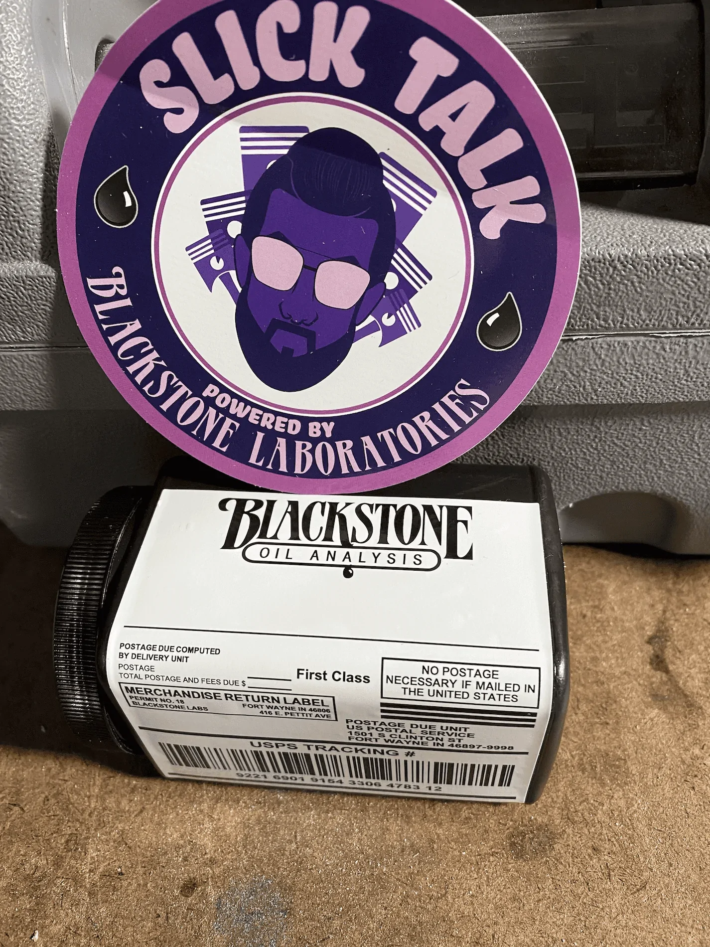

fourthgear
Jan 31, 2021
536
602
florida
I'll be sending my first oil change sample to here .
Ford Bronco Sport Oil change at what mileage / intervals? tempImagess1ABX

Is this your first change or did you do one at 2k? I am just about to hit 1K.
1st oil change. I trust my oil filter. My oil looks, smells and feels fine @ 5k.
