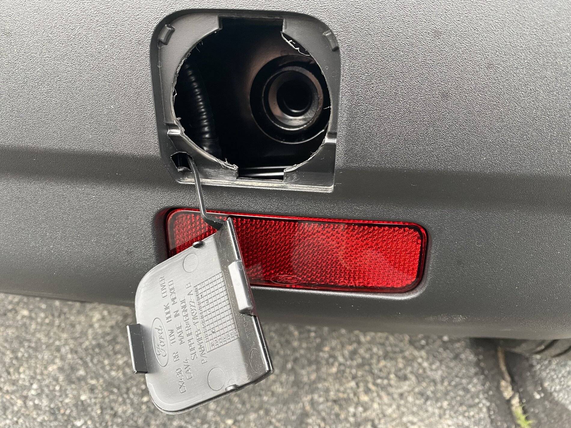

After another walk around, I emembered there was a small panel on the rear passenger-side bumper
Ford Bronco Sport Non-Badlands Tow Points 8B7EBC1F-17ED-48EE-9150-35E6D874A63E

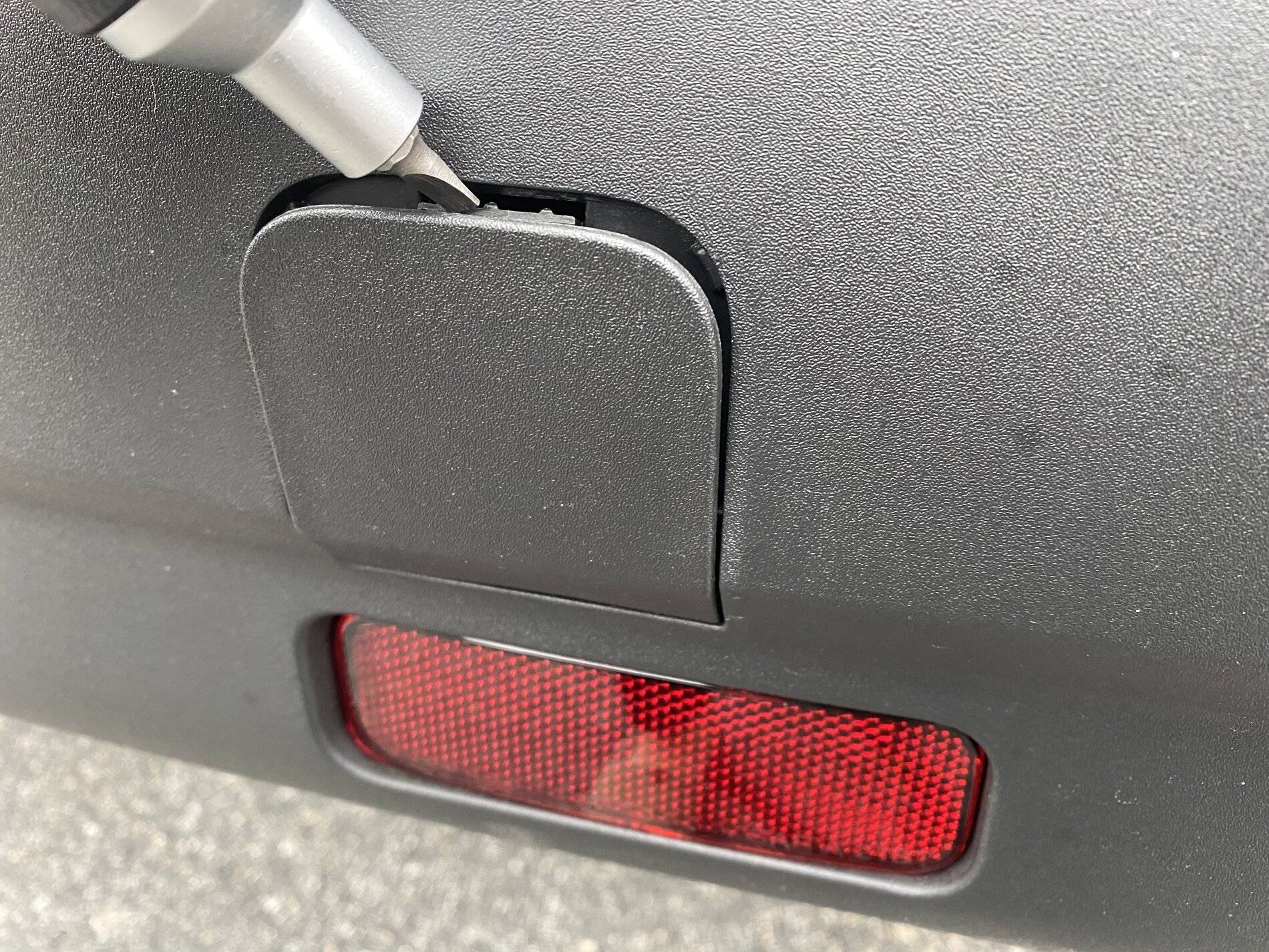

Prying from the top to open
Ford Bronco Sport Non-Badlands Tow Points D22C8661-C91B-4680-8DE0-37A978866A2C

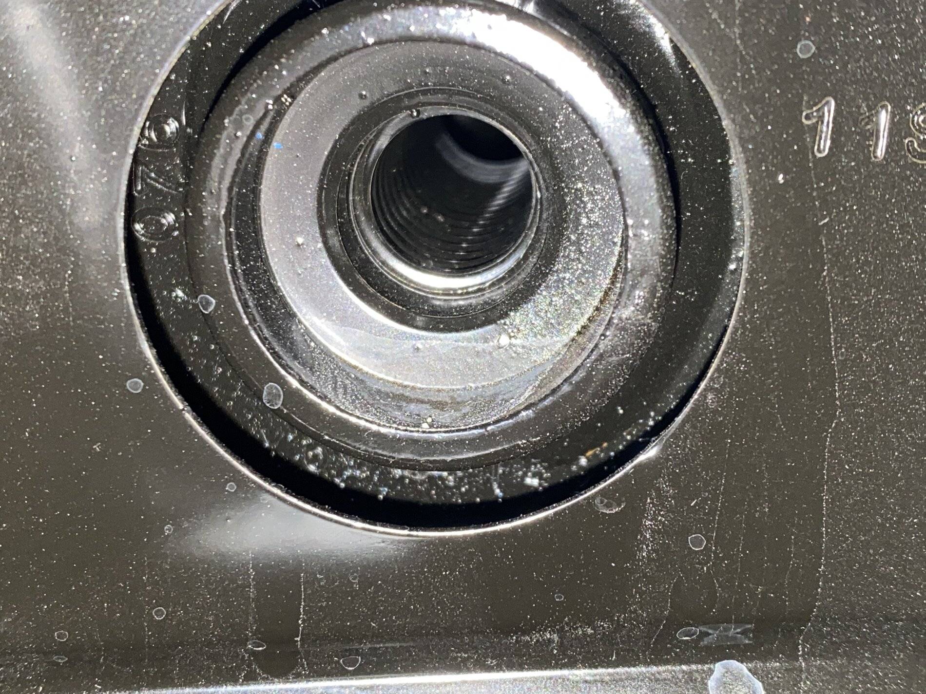

You get a nice little opening to…
Ford Bronco Sport Non-Badlands Tow Points 8264E1DA-B960-4997-ADBA-7E2ECCCB3C5C
Threads!
Ford Bronco Sport Non-Badlands Tow Points 3659C369-9CBA-452D-B7CB-D25BC306A9F0
The back of the cover confirms the purpose just in case.
Ford Bronco Sport Non-Badlands Tow Points B8C32958-9D4F-4245-A0E3-B9531AF9538E
Now I just need to get a tow hook to thread in.
Threads!

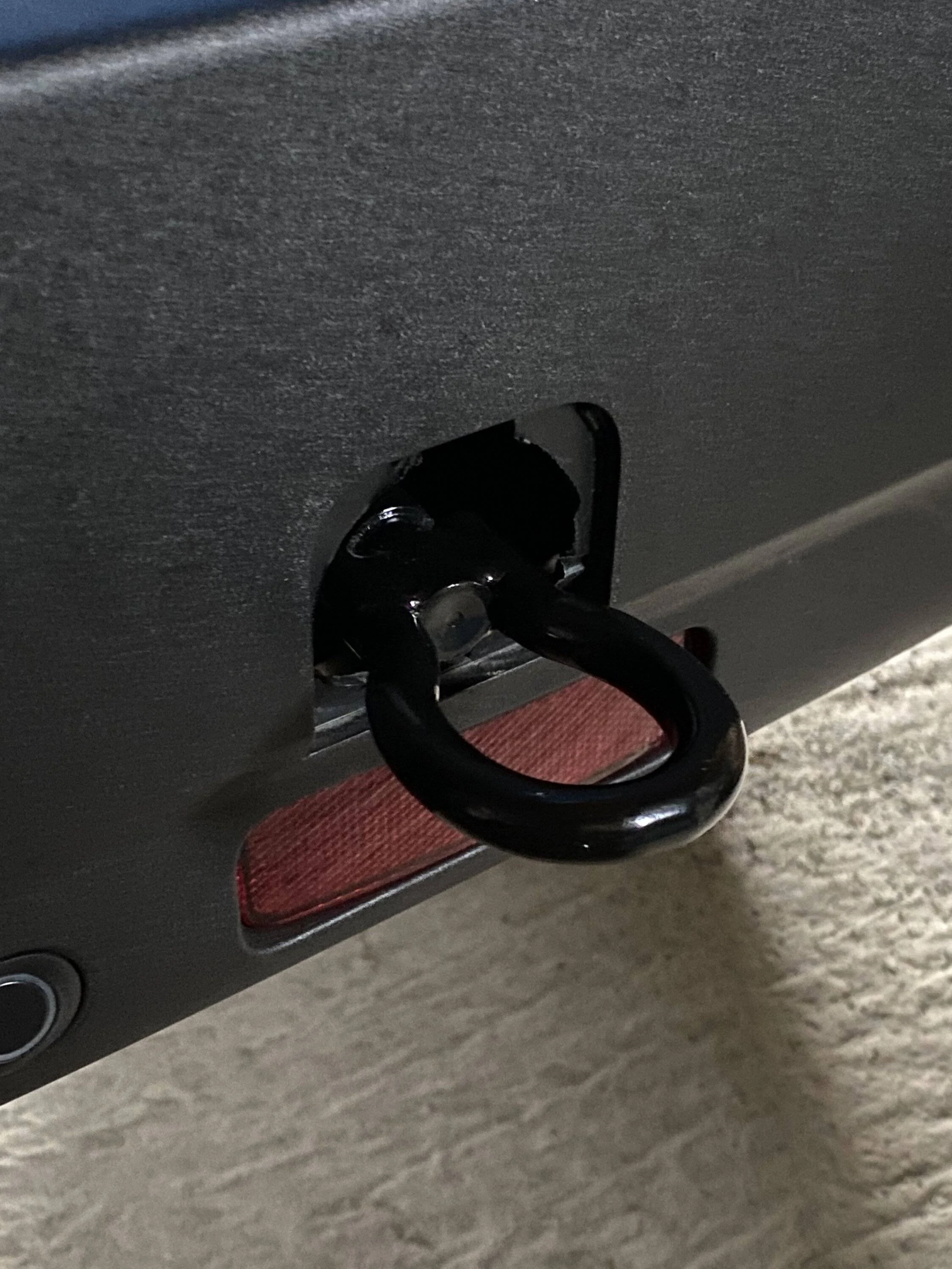

I found a part number for an OEM Ford recovery hook (6M2Z-17A954-A) I can’t remember who posted it, thank you to them.
I easily found it on Amazon, $37.15 when I purchased it (Genuine Ford 6M2Z-17A954-A Recovery Hook https://a.co/d/3DOQt2E) it’s a reverse thread (righty loose, lefty tighty) took me a minute to figure that out, third shift brain activate! I carefully removed the plastic cover by pressing on the plastic tabs and pulling with slight pressure. I eventually want to put the cover back on but don’t want it dangling while driving around. I did perform a thorough search of the spare tire area before purchasing with no luck. In my opinion, this should be a standard feature included with purchase. Nevertheless, an cheap and easy find on the Internet. Some good shackles and a 10k recovery rope are also stored within the vehicle at all times for those days where I just can’t help myself to a little adventure.
Ford Bronco Sport Non-Badlands Tow Points EF71FBA6-14C6-4CB4-A4BC-5516D6752993
Ford Bronco Sport Non-Badlands Tow Points 34EDD7E4-78A4-4F98-8CAF-57BCC4A1DBAF
Ford Bronco Sport Non-Badlands Tow Points AF02DD68-DE57-4A1B-BC44-96850E6D9DF1
