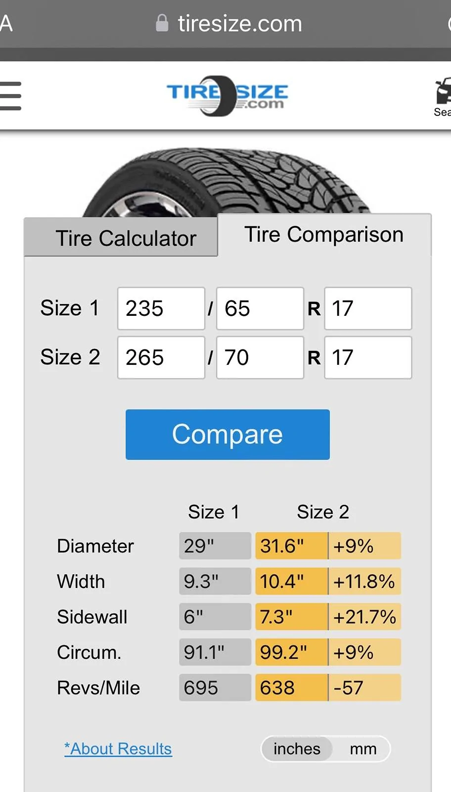

Will a Bronco Sport Big Bend with a Flatout 2" level lift handle Baja ATZ lt 265/70 17inch tires?
At 31.6”, the Baja is too tall. Here is a comparison with the factory optional 235 65/17 to the 265 70/17. I didn’t look up the exact size of the Baja ATZ but it’ll be close to what is shown in the pic. You can do your own comparisons using:
https://tiresize.com/calculator/

No. They won’t fit. For future reference, there are numerous online tire size calculators you can utilize to compare tire sizes, as well as online tire retailers that you can input your vehicle info and will tell you what size tires will fit without modifications.
