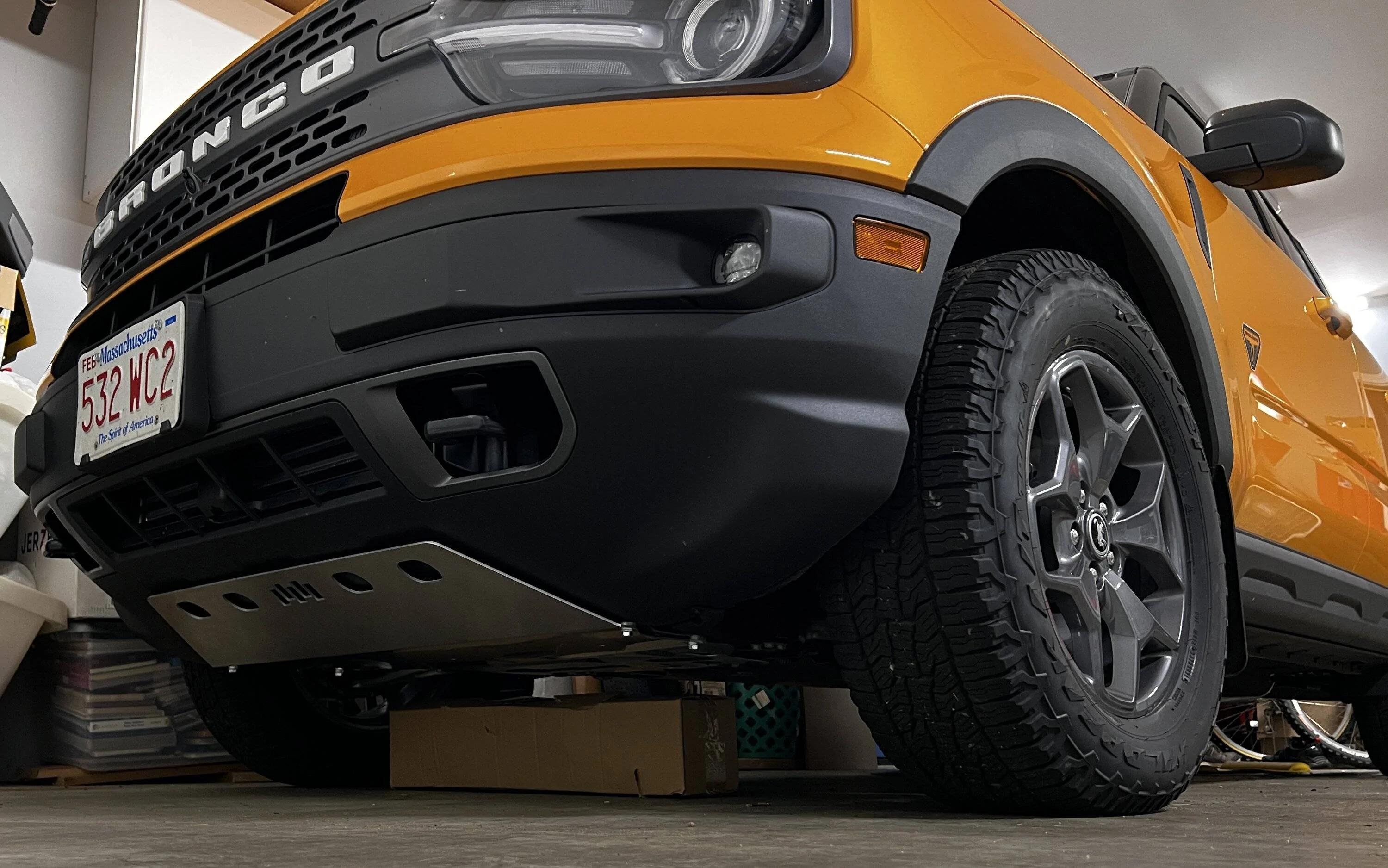

Have you had an opportunity to check the clearances with those 245/65/17s and the Badlands? I have the BL as well and don't want to add a lift. That said I do like filling out those wheel wells, but not at the expense of function. And I certainly don't want to grind down pinch welds.... might affect body integrity...
2,166
3,150
Belleville, IL
Since the rub from larger tires happens at the back of the wheel well, a lift doesn’t really change the equation. It does change how compressed the suspension would need to be to cause a rub, but if you plan to go places where you will highly compress the suspension and have the steering wheel turned, a tire larger than 29.5” (245/65/17) will rub. This will happen with or without a lift.
There could be some aftermarket kit in the future that really changes suspension geometry enough to make a larger tire possible without modifying the unibody. For now, that kit does not exist, as far as I know.
No issues at all!
For the looks works perfect
If I was going to do a lot of off-road maybe I would go for 235/65/17, but that’s just my humble opinion ? Cheers!!!
Ford Bronco Sport My 2022 Badlands Bronco Sport Journey! 4129FAFC-D2A2-4677-916D-1CDEB5FF2A58

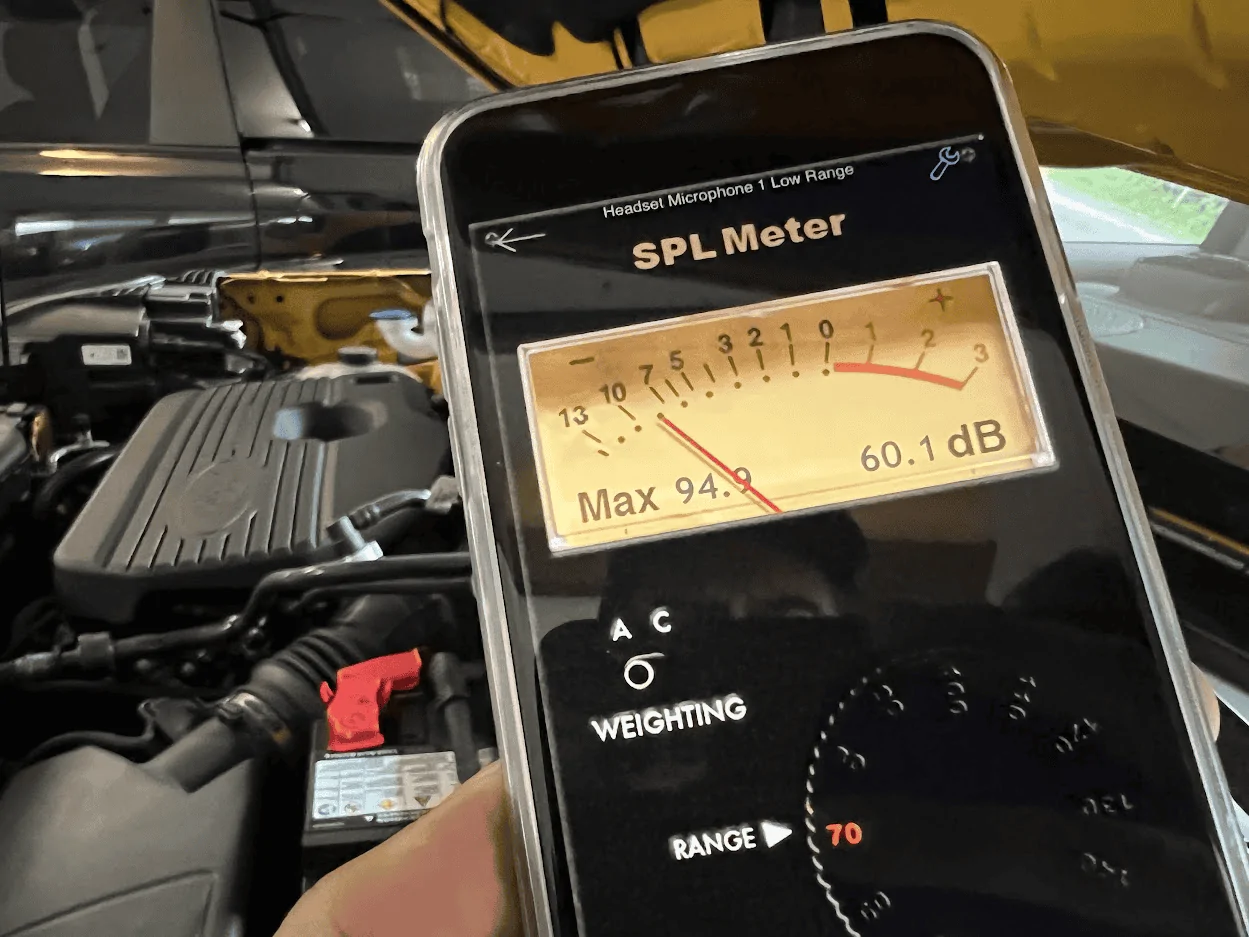

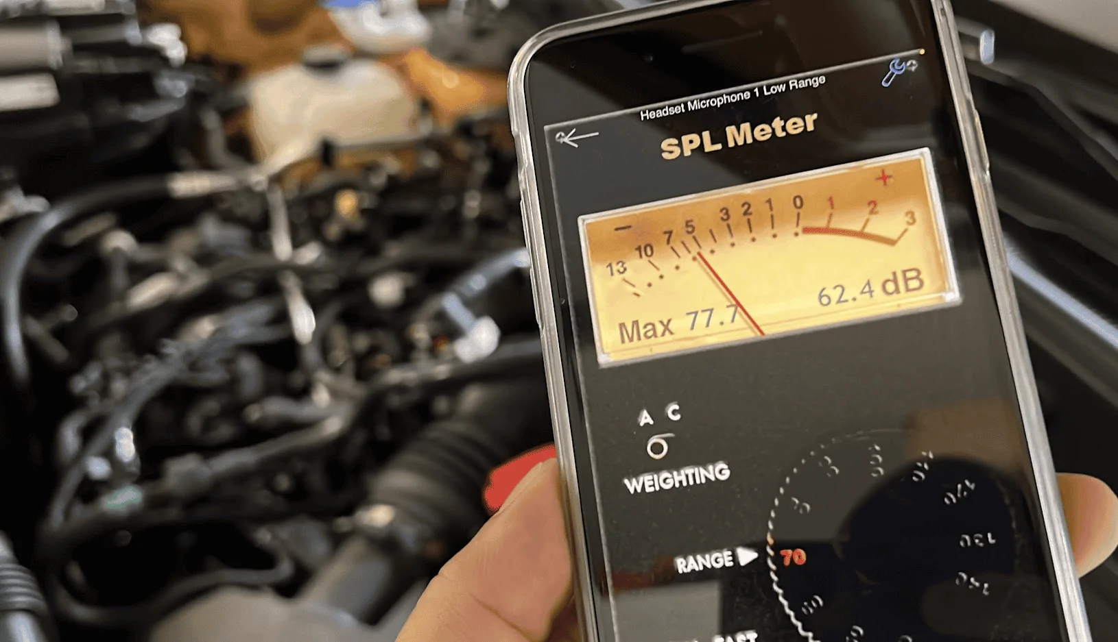

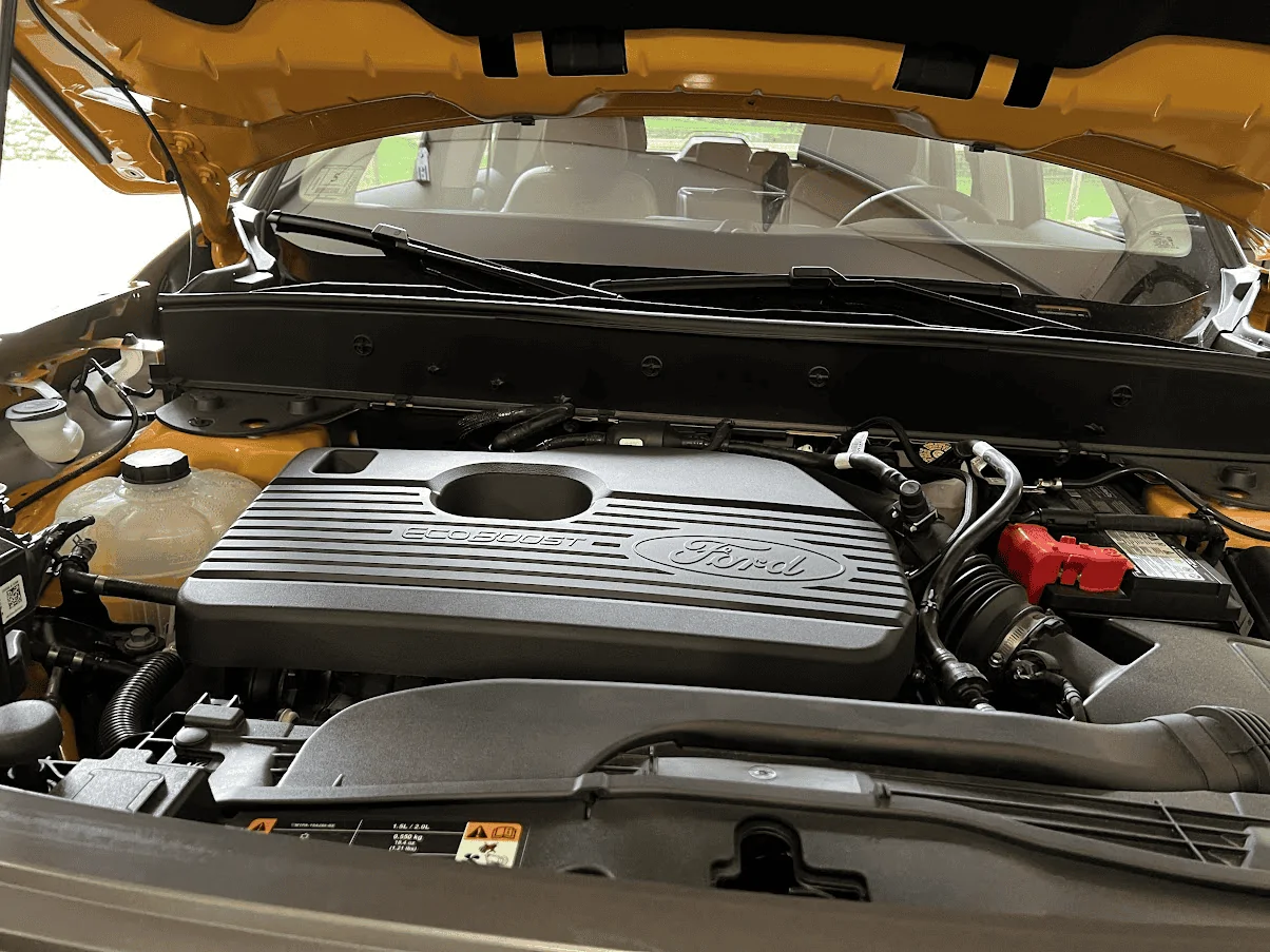

The Foam engine cover does some deadening to the engine noise, about 2 db. Not much but it does cut into an annoying high pitch noise between 2K and 4K.
I'm very happy with the way it looks and helping reduce engine noise it's a plus for sure!
Test at idle without cover...
Ford Bronco Sport My 2022 Badlands Bronco Sport Journey! 1657506477000
Test at idle with engine cover...
Ford Bronco Sport My 2022 Badlands Bronco Sport Journey! 1657506524156
This is a helpful explanation and yes function/performance under load is what I choose over appearances. As mentioned before I m not interested in any lift and off roading is 33 percent of what I do. However, this vehicle is also my daily driver so that's the other 66%...
Thanks for this information... I'll just get the blockiest AT's I can find, but stay within the 235/65/17's... At the point the BFG/KO2's seem the most aggressive AT's at present.

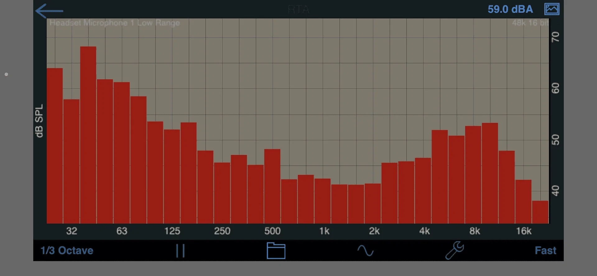

In a very amateur way Exploring the B&O system, I took some RTA (real time analyzer) screenshots playing Pink Noise on the B&O Audio System:
The graph it's not bad, Tonality isn't that bad, no big peaks or valleys, but in real life the system may not sound as good as we wanted.
@ Pilots hearing position:
Ford Bronco Sport My 2022 Badlands Bronco Sport Journey! 1657686035501

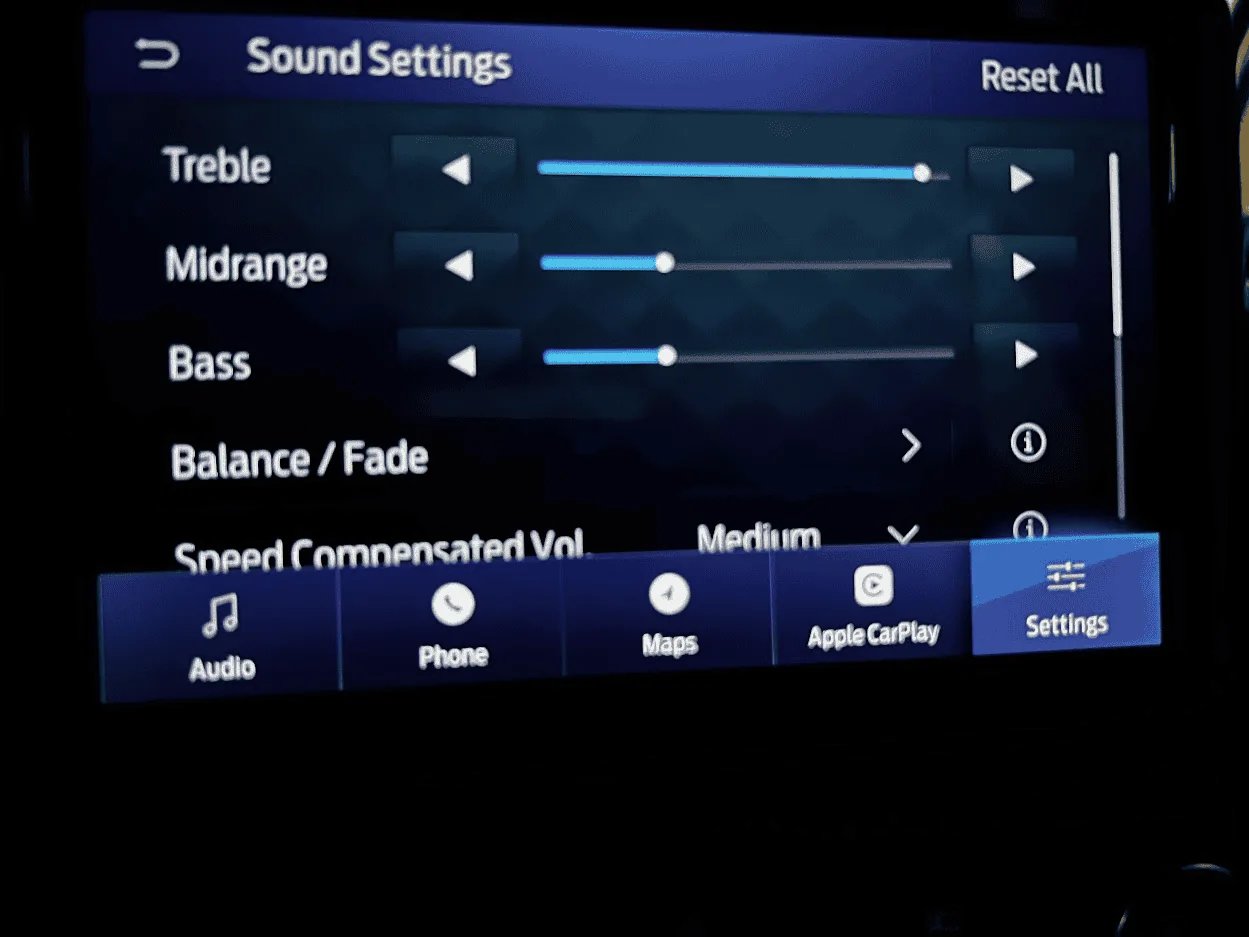

and my settings are like these: (I know I have the treble a little too hot, but that's ok) ;)
Ford Bronco Sport My 2022 Badlands Bronco Sport Journey! 1657686190721
