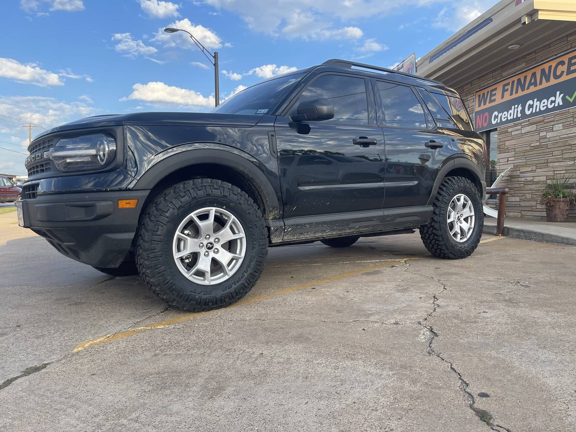

Ya I am happy with it. If I could do it again I would do a smaller size tire. But hey. I am loving it. Suits my needs just fine and I love the stuff stock look it now has…

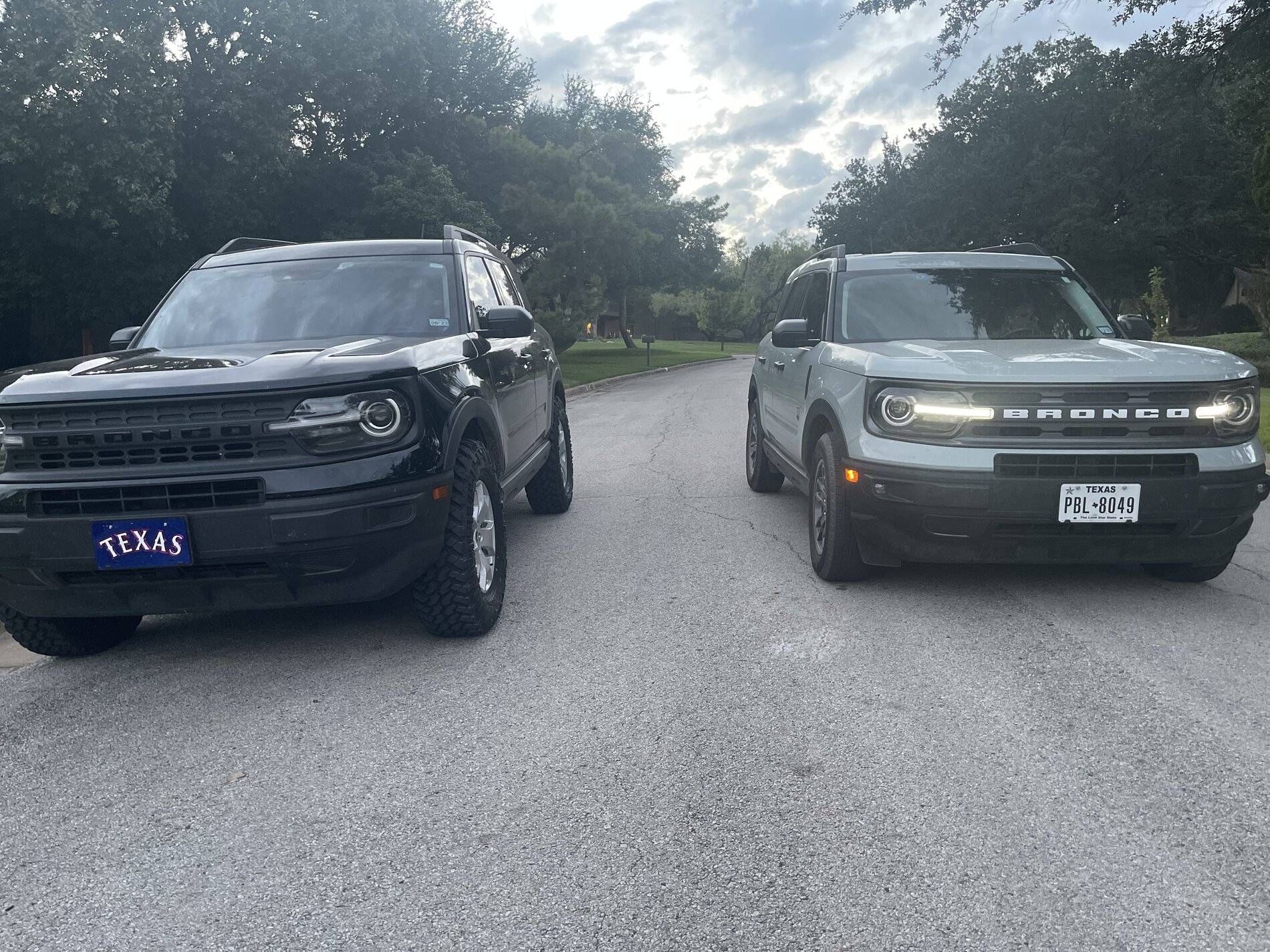

awesome!
and yeah, that side by side comparison, what a difference it makes.
did you install it?
how's the ride quality after?
nice job!
The side by side comp, the stock one is not pulled up even with the big tire Bronc. That exaggerated the lift look. Makes the lifted one look bigger and badder.
A better comparison would be exactly side by side, closer together and an end to end side shot. The pic taker needs to be dead center of the truggies.

oh i totally agree, the way the photo is taken, can be deceiving. still gives a great appearance to me.

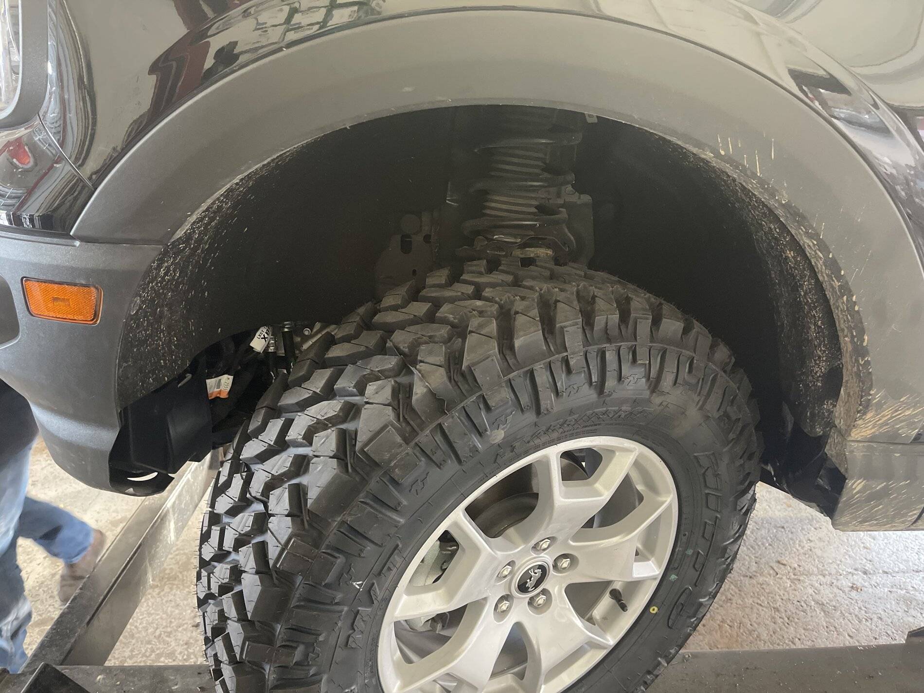

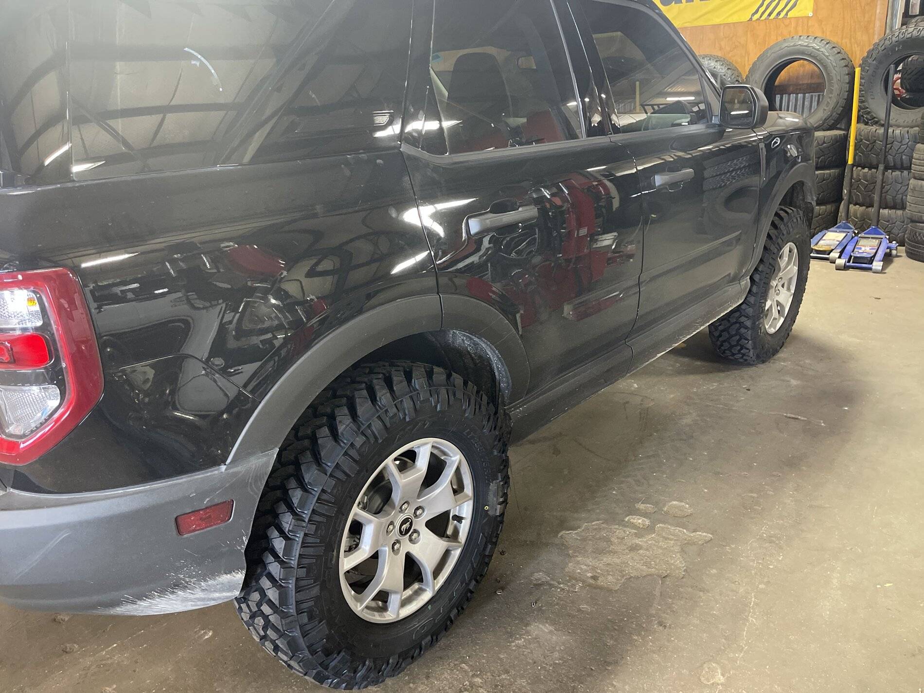

the ride is the same as stock, the tires are aired to 30 PSI. When the tire shop installed my tires they had them at 42 PSI and they measured 33.5” tall… at 30PSI they are measuring at 33.1”… I have to do a little more trimming but over all I am a lot happier than BFG could ever make me
Nice to see a "real" tire on an SUV! Didn't someone once say "rubbin is racin"??? :crackup:
