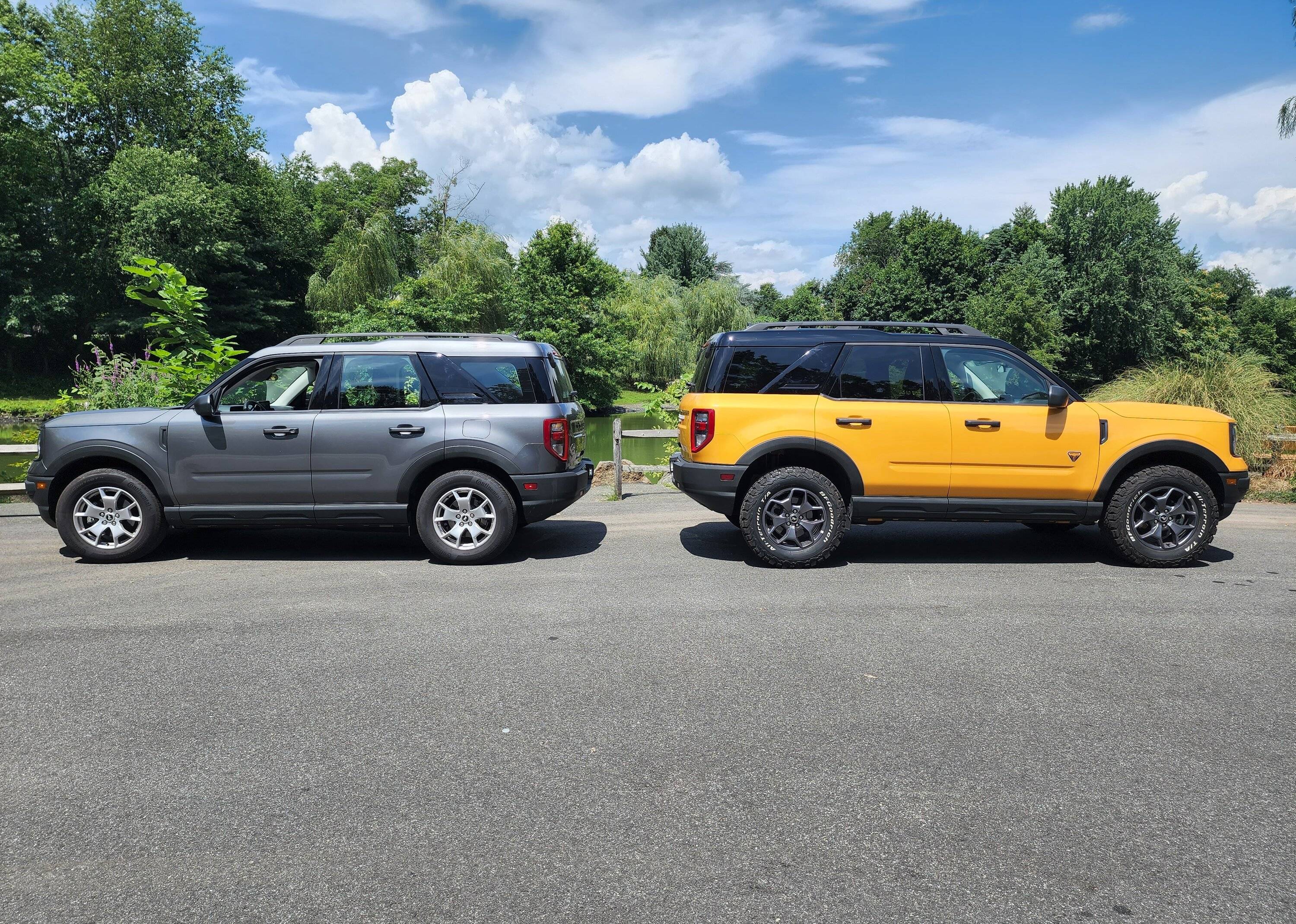

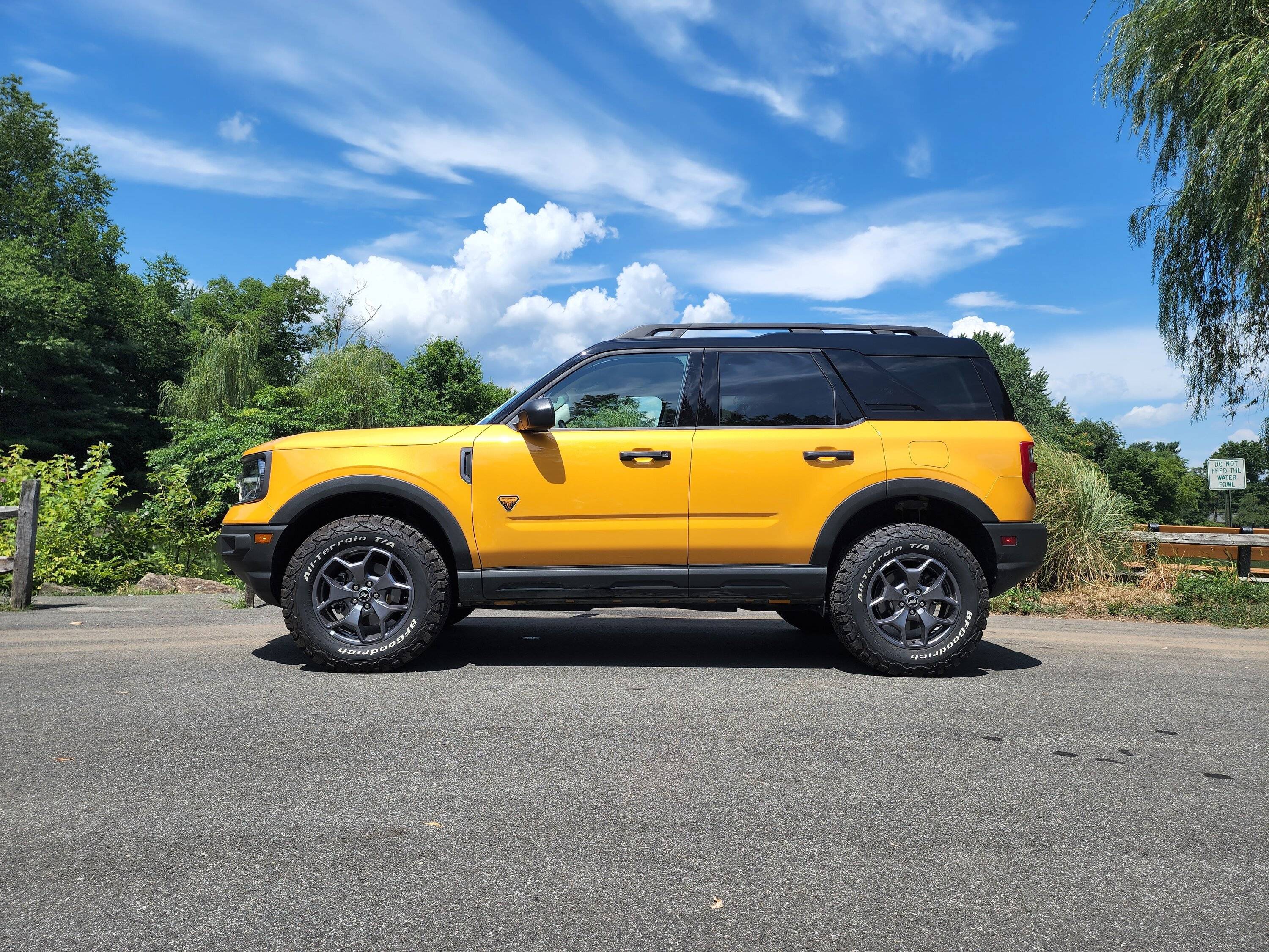

Ford Bronco Sport Badlands on HRG lift and 245/70 KO2 tires (pics with comparison to stock Bronco Sport) 20220805_133105
Ford Bronco Sport Badlands on HRG lift and 245/70 KO2 tires (pics with comparison to stock Bronco Sport) 20220805_131549
Ford Bronco Sport Badlands on HRG lift and 245/70 KO2 tires (pics with comparison to stock Bronco Sport) 20220805_132025~2
Ford Bronco Sport Badlands on HRG lift and 245/70 KO2 tires (pics with comparison to stock Bronco Sport) 20220805_164421~2
Really nice shot. Unfortunately the pics just don’t really show it. It’s even more pronounced than an image shows.
I’m riding on the HRG lift and 65s. I didn’t want to deal with the tire rubs. I got to just a tad over 10in after all was said and done.
I would go for the fender flares next. At least where I am there are lots of rocks and it helped a lot with that. Not to mention it just does something nice to the look IMO. Makes it look a bit more aggressive.
enjoy!!! I know I do.

Thanks! Right, the difference is most noticeable when you pull up next to another truck.
The nudge bar will be the next thing as it is sitting in my garage currently.
I'm not a fan of the shiny bolt fenders that I see most frequently. There is another style that looks pretty good (like just a larger version of stock) ...but I think that will come after new wheels.
I may go with a (minor) positive offset wheel and then get the fenders.
