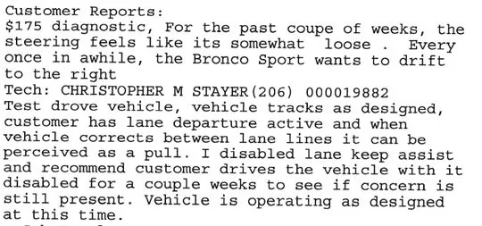

I had the opportunity to get my 2021 Bronco Sport in to a local Ford Service Center near me to inspect the steering & front suspension system for any equipment issues that could cause the 'loose play' I was experiencing. Turns out the Bronco Sport is AOK, with everything working as designed. But the Service Tech noticed during a test drive that the Lane Keeping System was activated. And a slight departure from centerline would exert a 'pull' back to the center of the lane (assuming lane lines were detected on both sides of the vehicle). I didn't know this feature had been turned on as the button for it is on the end of the turn signal stalk. I originally had it turned off. What a 'dumb ass'! Cost me $175 diagnostic charge to become more aware of all the 'gizmos' the Outer Banks model has.
Ford Bronco Sport Loose Steering Lane Keeping System
Ford Bronco Sport Loose Steering Steering System Diagnostic

I have a 2025 Maverick now but used to have a BS BB and turned it off on the Turn Signal stalk. After I talked to another Maverick owner who told me about it and I hated it and I'm glad I turned it off.
