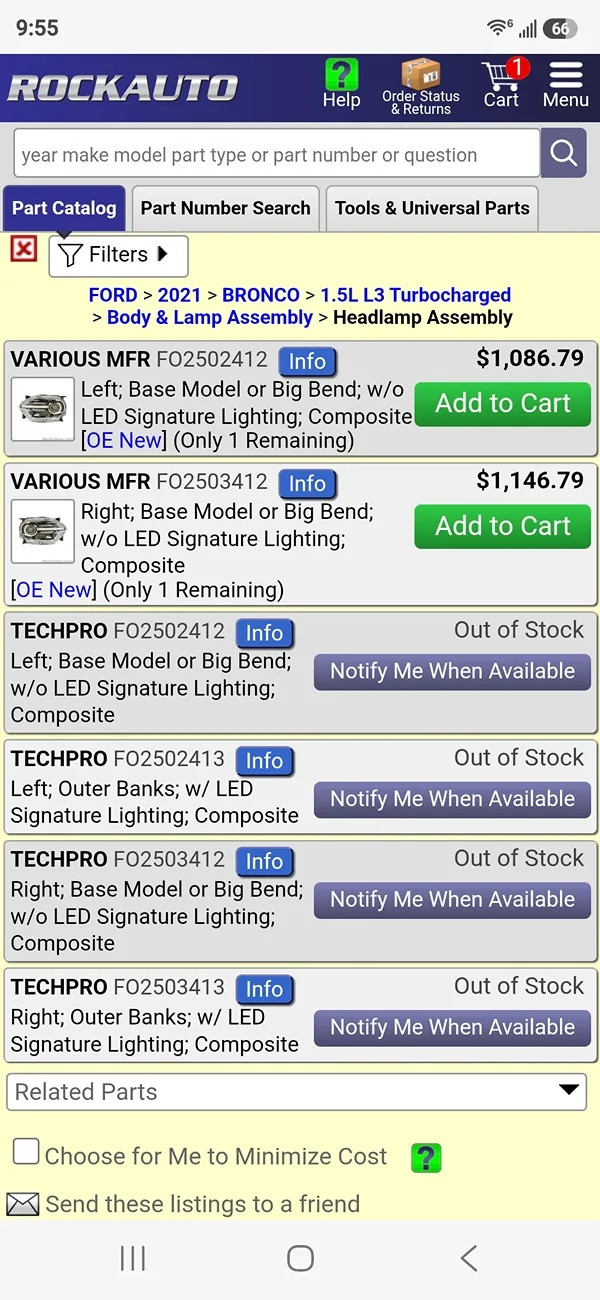

Rockauto buddy
Ford Bronco Sport Lighting Processor and Headlight Failure Screenshot_20260706_095520_Samsung Browser

Oh dang. Thats much better than rockauto

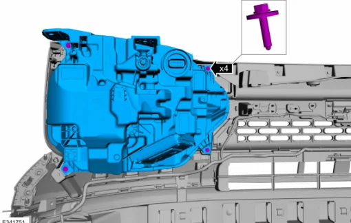

I agree with @RSH. I would explore aftermarket options. Or, you can find some on ebay from a wrecked vehicle. If you guys want to try and DIY, this is how you remove the front bumper. Once you expose the headlamp assemply, the 4 screws to remove it are here:
Ford Bronco Sport Lighting Processor and Headlight Failure 1783365149711-my

If the LED control module attached the headlight needs to be replaced, all you need to do to program it is to run the "LIN New Module Initialization" rotuine in the BCM using FORScan. No other programming is required in this case.
