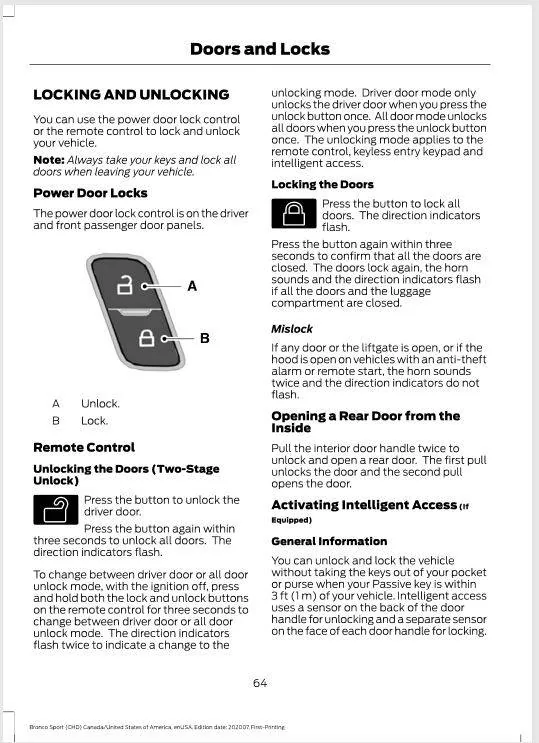

Seems like a fairly technical issue. Do your door locks work in all other instances? (access pad, FOB, handles, etc?) Do you have a MyKey programmed? Do the other methods unlatch the glass or only the app? Do you have two stage unlocking? Try changing the preference and see if that makes a difference. Sorry, no solution other than to monkey with the various components and see if it shakes something the right way. Otherwise you're into a dealer service visit.
Some people have an issue with the intelligent access on the liftgate not working when they mis-press the remote start and then they have to use the FOB to "reset" the lock brain and resolve the condition. Maybe that could fix your issue?

I think the locking system on these vehicles is a complicated software mess, and it sometimes gets confused. Some have had luck resetting the system by simply using the fob. Try this:
  1. Get out of the car with the fob and lock it (push door lock before exiting, keypad, fob).
  2. Use the fob to unlock the liftgate (push the liftgate button twice).
  3. Relock the car.
  4. Unlock the liftgate with the fob.
If the liftgate glass unlocks instead of the liftgate then I would take it to a dealer.
