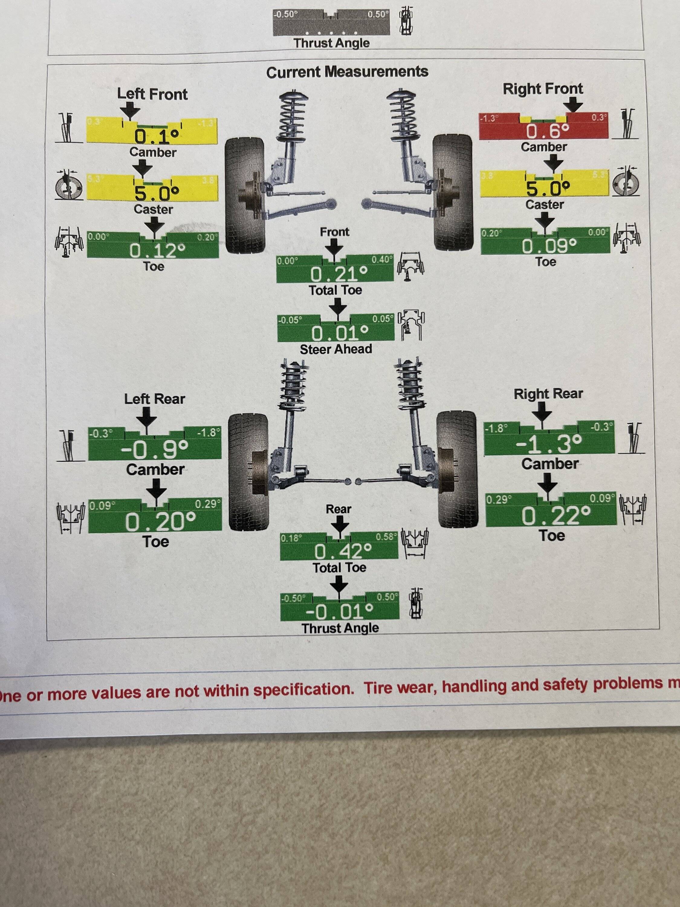

Hello. I just installed the FRL 1.75” lift on my Badlands myself. I did it right as far as I know. No strut rattle, everything tightened down, etc.. Very happy with it aside from one issue.
Went to get an alignment. The techs said they couldn’t get the camber properly aligned and was an issue they’re having with all broncos, big and small, lifted and stock. I had not heard of this before. What’s the solution?
I know I’m setting y’all up to say uninstall the kit, but there is no way there isn’t another answer.
I suspect I should head to a dedicated Ford dealership and/or buy camber bolts(?) I am handy with cars but don’t know much about the nuances of Ford suspension specifically.

I'd try another shop. This is the first I've heard where you can't align a Bronco big or small with a lift.

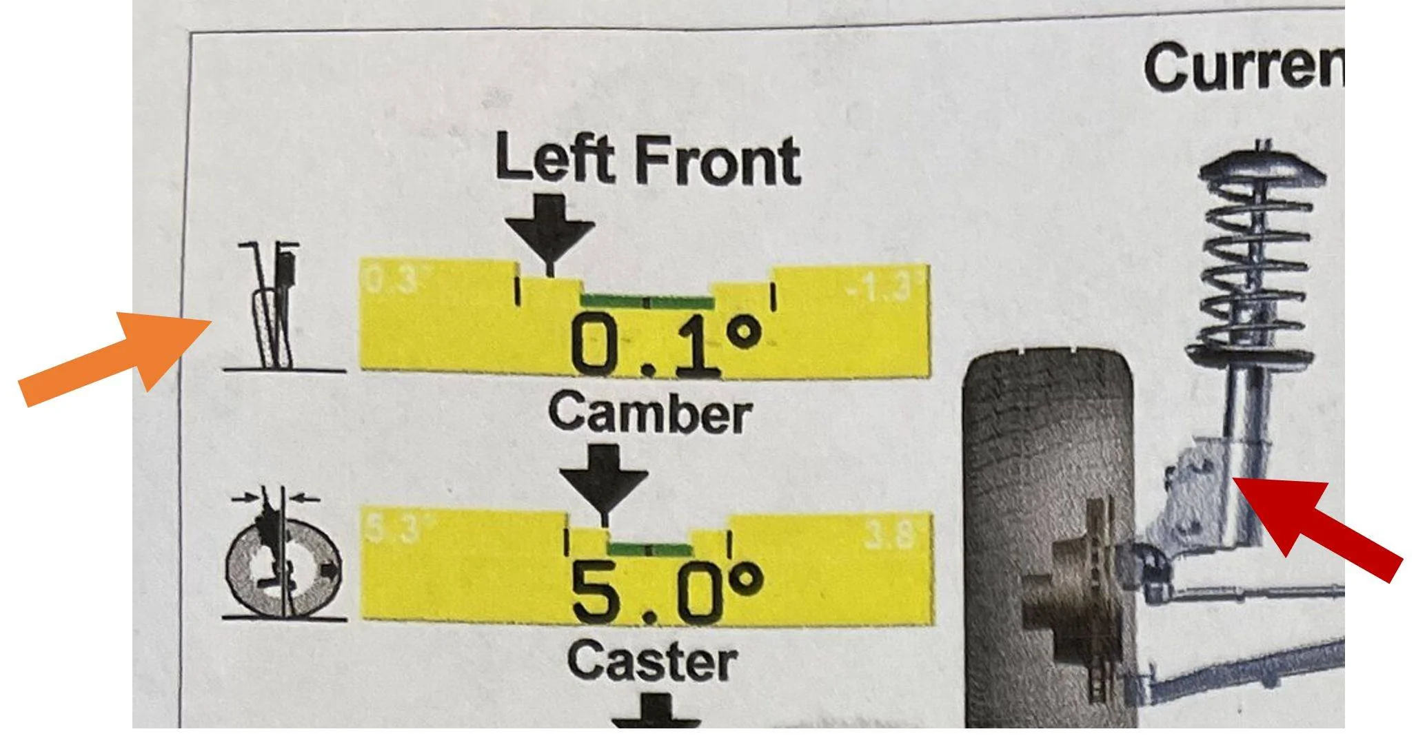

No worries. The image below is cropped from the tech report OP posted:
Ford Bronco Sport Lift and Camber — Help please :) CamberAdjustment
The red arrow points to where the camber adjustment bolt goes. Turning the camber bolt forces the wheel assembly to rotate around the bolt underneath it, resulting in a change in wheel camber. The orange arrow points to a pictogram illustrating wheel camber, which is the vertical angle of the wheel as seen from in front or behind.
