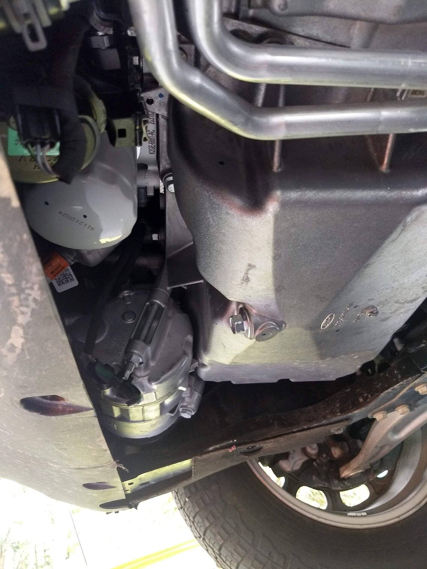

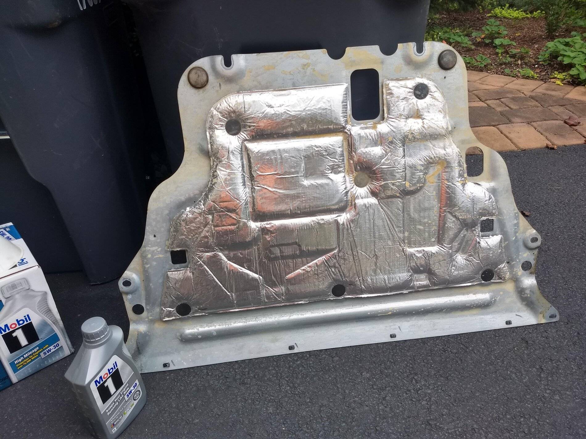

Not sure if there's much information for BL. I finally did my first oil change at 7000 miles. The bash plate was a pain to remove because of its heft and needed a socket wrench to remove. I also need to remove 4 torx screws that attached the bash plate to the lower edge of the front bumper. I think the oil filter itself needed a 72 mm Oil Filter Cup-Style Wrench to remove. I didn't have the exact size (I had a 74 mm cup style wrench) but managed by putting a rubber glove to tighten the grip.
I was worried at first that oil from the oil filter might drip onto the plastic bumper, but it didn't (see photo below). I saw a video in youtube that showed the oil drain plug pointing to the back of the car. For the BL, it points to the front.

Yeah, changed the oil on my Badlands this week (along with another upgrade project that is still ongoing) and my experience was pretty much the same. While I didn't really find it that hard to remove the plate I was surprised at the heft of the thing. Clearly it isn't cosmetic. ?
The only difference for me is that the 2.0L Badlands uses the same oil filter and oil (5-30 synthetic) as my Fiesta ST so I already had what I needed to change everything out.
One thing that did bother me a little was that it was already showing signs of light rust and corrosion. Given that the other protective plates are painted chassis-black and I had it off anyway, I painted mine ahead of bolting it back on. A little dab of anti-seize on the bolts probably is a good idea as well.

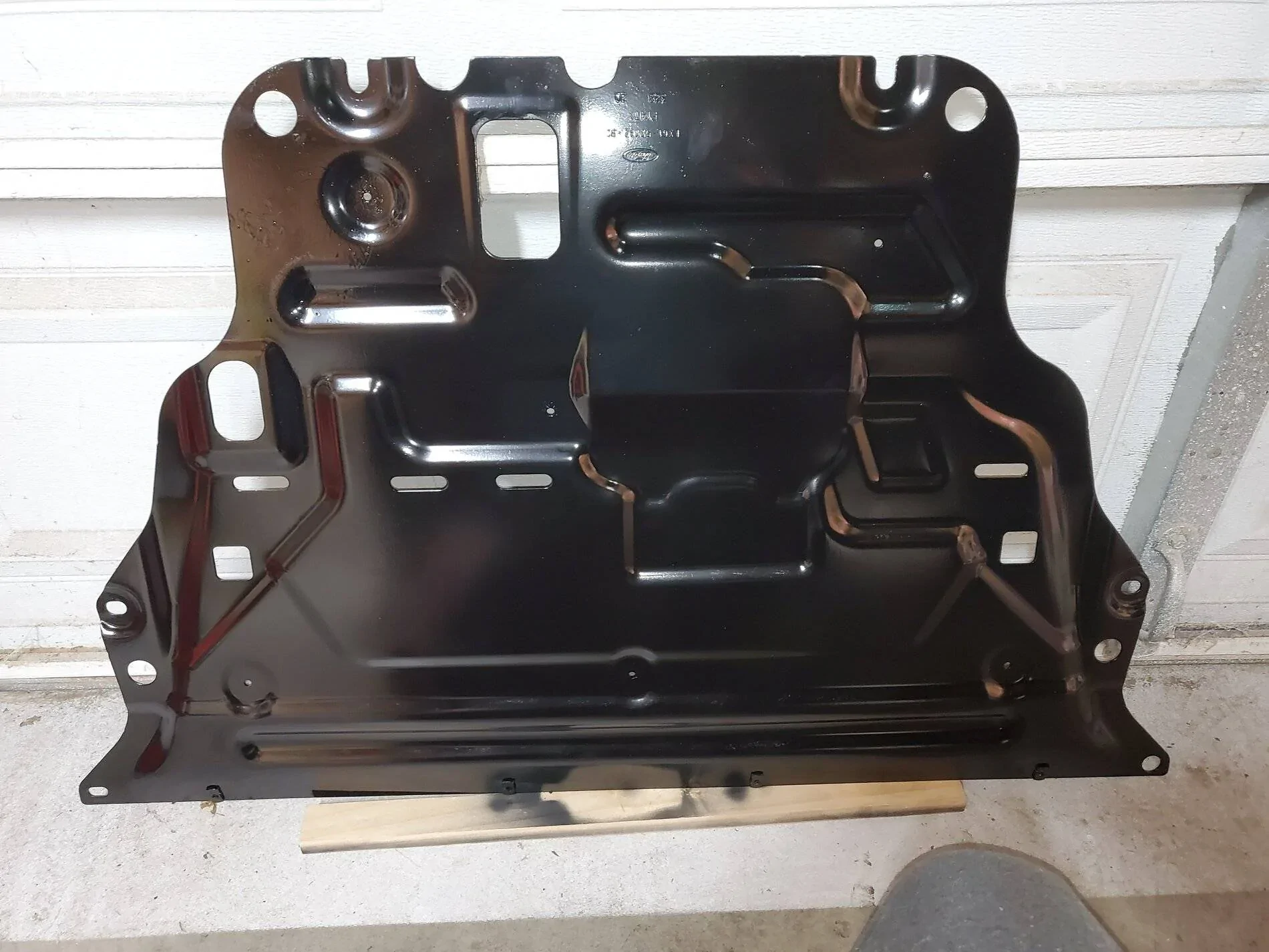

Were you using passivation paint (rust-converting / rust-preventing), or just normal black paint?
Rust Oleum satin black heat-resistant enamel. I've used it as an under-body paint in the past with pretty good results and it's easy to find/inexpensive. Doesn't really need to be gorgeous, but I tend to keep my vehicles and even if I have to paint it again in a few years it should slow the rust way down.
Quick pic (paint is till drying):

@MKohlman the black paint looks great on the bash plate. I hope that ends up holding up to getting chipped from rocks and such. I’ll probably try some krylon fusion high heat.​

Nice helpful post. I have a filter strap wrench. Is there just no space to get it in there? I'm undecided if I prefer vertical mounted filters or horizontal. I'm glad to see and read that it drips clear of the body though. My last vehicle was a GM with the filter right above the frame crossmember. I used to wrap it in aluminum foil just to have a drip shield, or else it went into the holes on the frame!
I am also a little daunted about doing the first change because of the plate. What did you do to get the last bolts out and drop it? A floor jack, or blocks, or? I'm betting it is over 50 and maybe 100lbs?

I only have the cup-style oil filter wrench (and also felt that there wasn't much space to use strap wrench).
It wasn't pretty when I took the bash plate out, but it worked. I just loosened all the bolts simultaneously, and for the final release, I used my knee to prop it up while lying on a under-car roller. Don't think it's much heavier than 50 lbs - it was just awkward.
