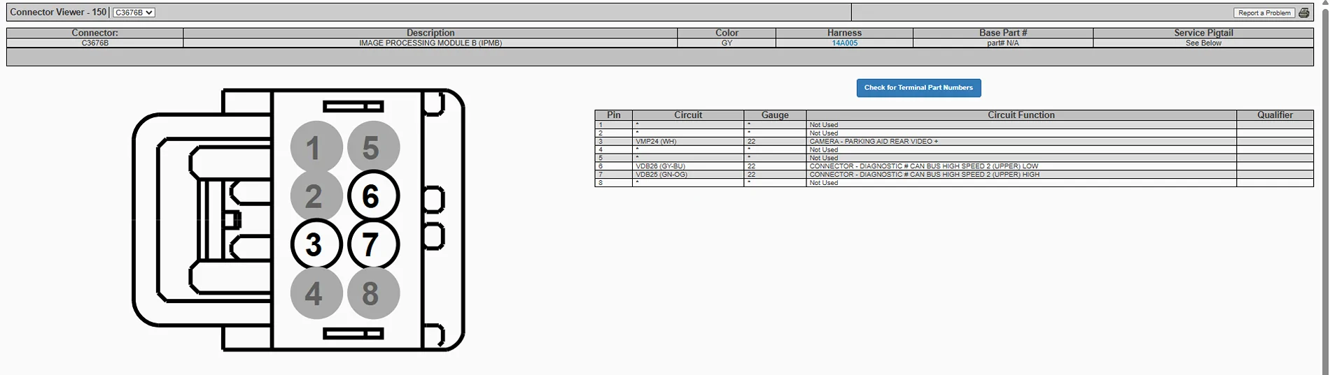

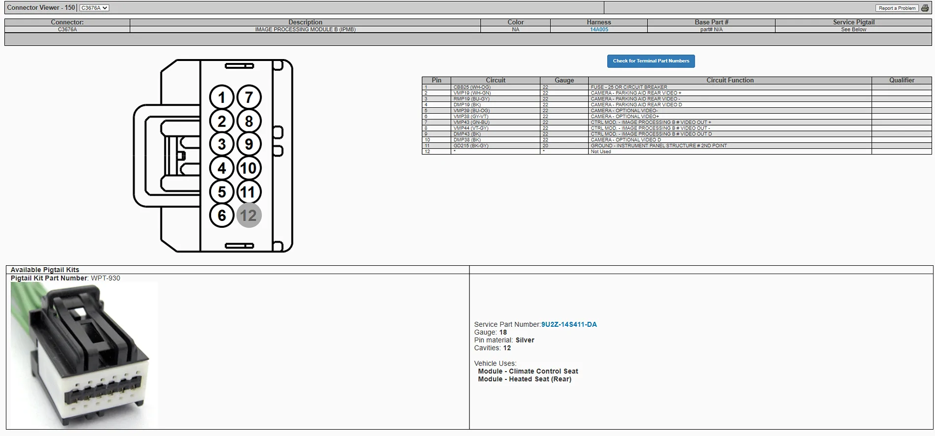

Question about the block IPMB. Does anyone have a block pinout?

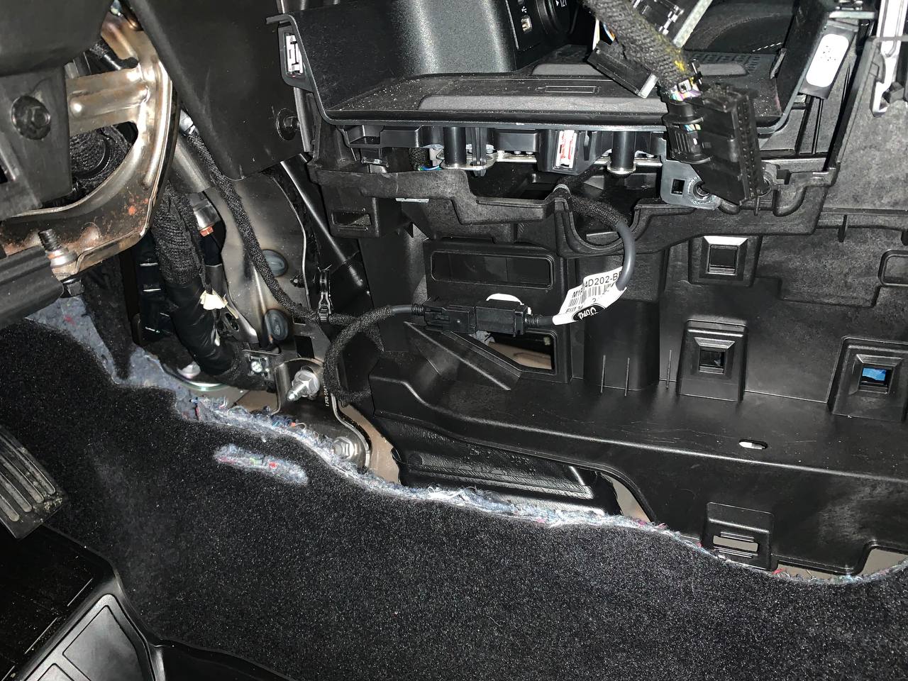

Could you please tell me where the block itself is located?
Instructions to get to it are attached. This is what it looks like once you get there. Seems to be under the console. PITA.

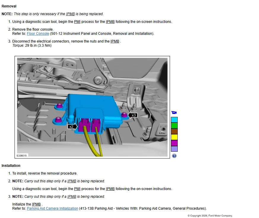

Based on the diagram Ford shows in PTS, it looks like it's mounted to the floor between both front seats under the console.
