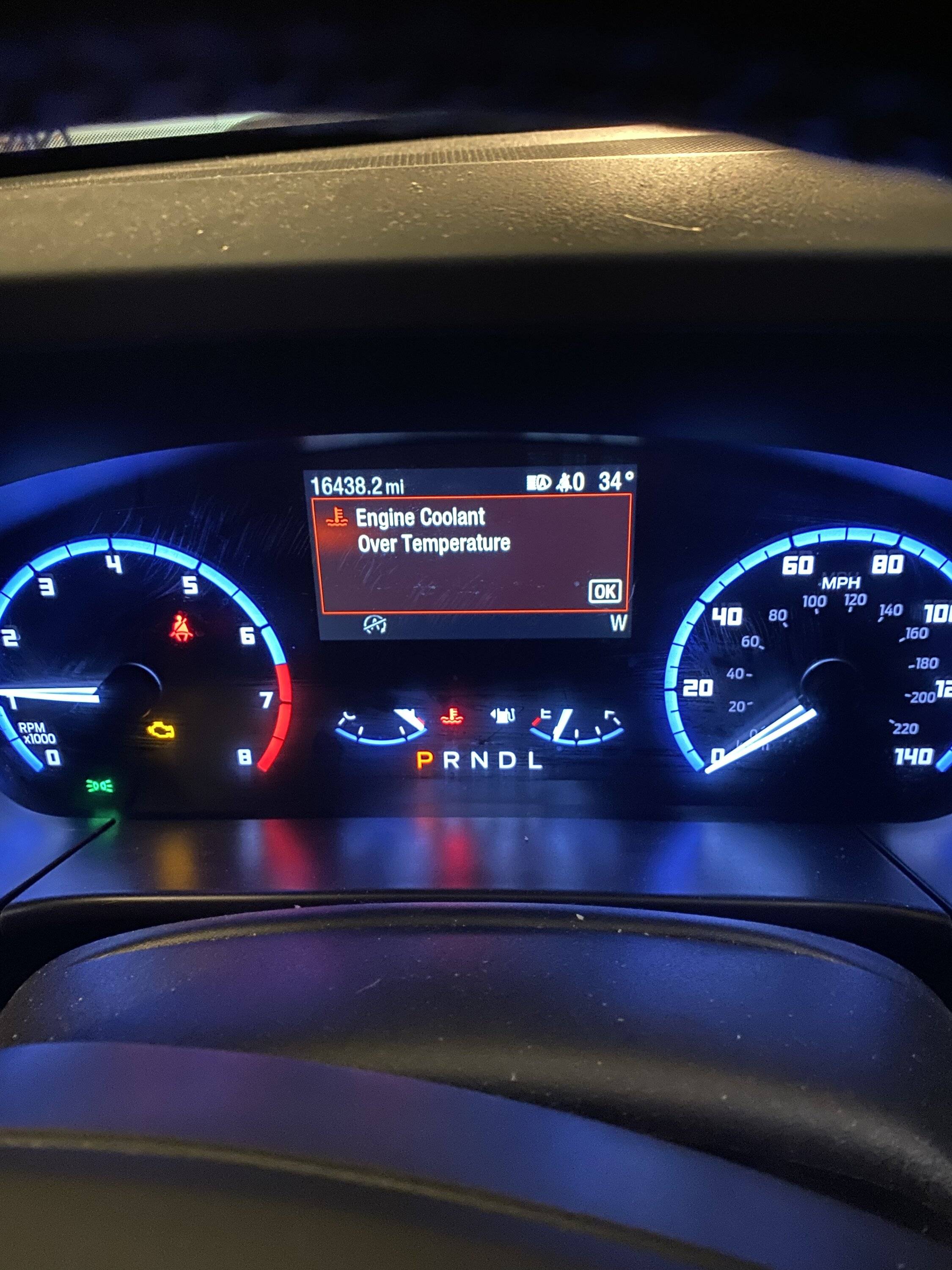

16k miles on a 2022 BS Big Bend. The only warning I had was cold air blowing with the heat on. Noticed no coolant in the reservoir, so I filled it up and started the car which then blew the head gasket and finally gave me an overheat coolant error. Had it towed to dealership and negotiating now to get a new engine put in, but honestly am having second thoughts about the 1.5 engine now and am considering selling it when I get it back.
Cannot believe how common coolant problems seems to be with the engine. It’s beyond a recall issue, and Ford needs to address how they’re going to help those folks that are just past their warranty and shouldn’t have to be totaling a 3 year old car out because of poor design/construction.

Update: they sold my courtesy vehicle (2023 BS Badlands), so swapped me for a 2024 F150 extended with 24 miles in it. No update on how long they expect to have my car. Researching to see how I confirm my warranty will be reset and Carfax won’t ding my resale price when they’re finished. Dealer is also seeing what he can do to stop the reverse whale call it’s done since day 1. Last oil change they told me “it is what it is” when I inquired.

I just experienced the same problem this weekend. Cold air blowing with the heat on and when I turned the fan to high, my temp gauge shot to H and I got the same warning light. Pulled over and coolant overflow was bone dry. Had oil change and fluid top off in October.
I have the 2021 Bronco Sport with only 22k miles. It went into the dealership today and my service advisor said they just had a meeting about this issue this morning. I think this should be a recall at this point, after reading hours of complaints on leaking coolant.
