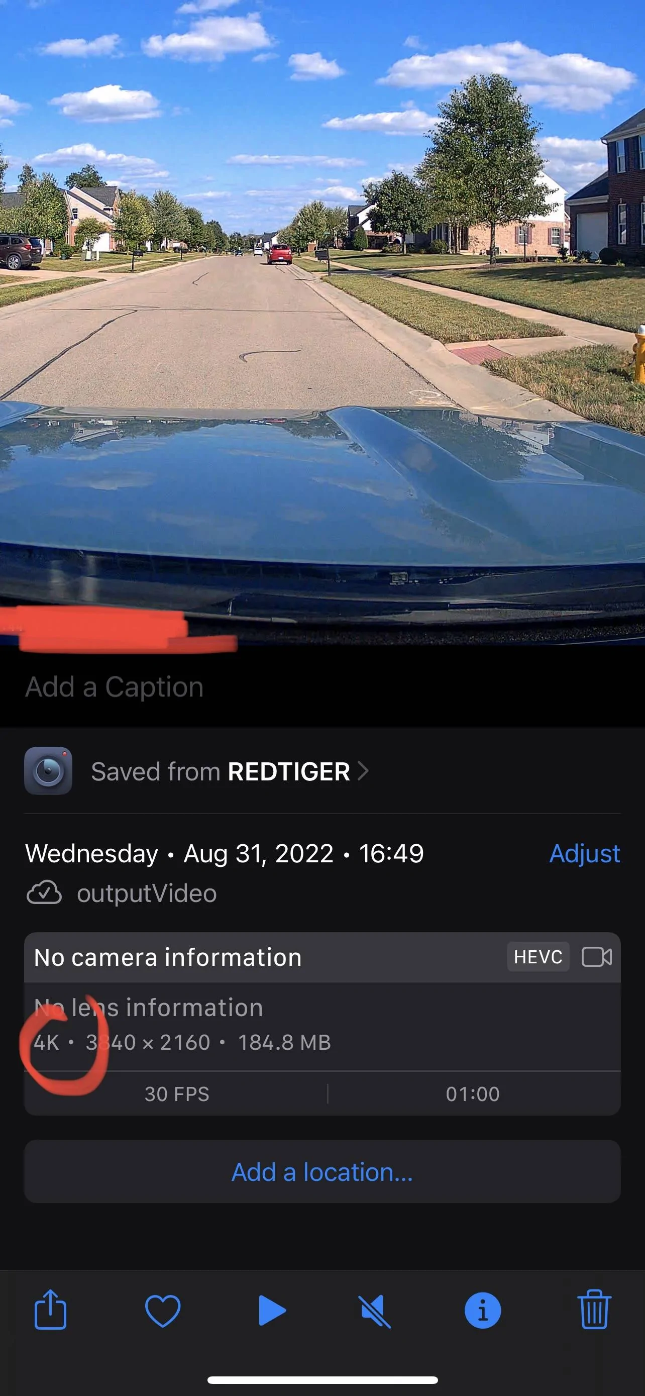

Thanks to Mark’s great write up I was able to get mine installed this afternoon. Hardest part was getting the rear camera mounted. Rest of the cable runs were surprisingly easy on the BS compared to most other cars I have owned.
One point of clarification on the RedTiger camera (I ordered the same one). The front camera is in fact 4K. Resolution, verified when I downloaded an image and video to my iPhone, is 3840x2160 (aka 2160P or double 1080P). A purist might argue you need the 4096x2160 aspect ratio to be 4K (hence the name) but with the 2160 is the key indicator. Phone even marked it as 4K. Rear camera is definitely 1080P also.
So far very impressed with the image quality. I haven’t tested it out at night or on 60 fps mode (reduced resolution but double frames per second)
