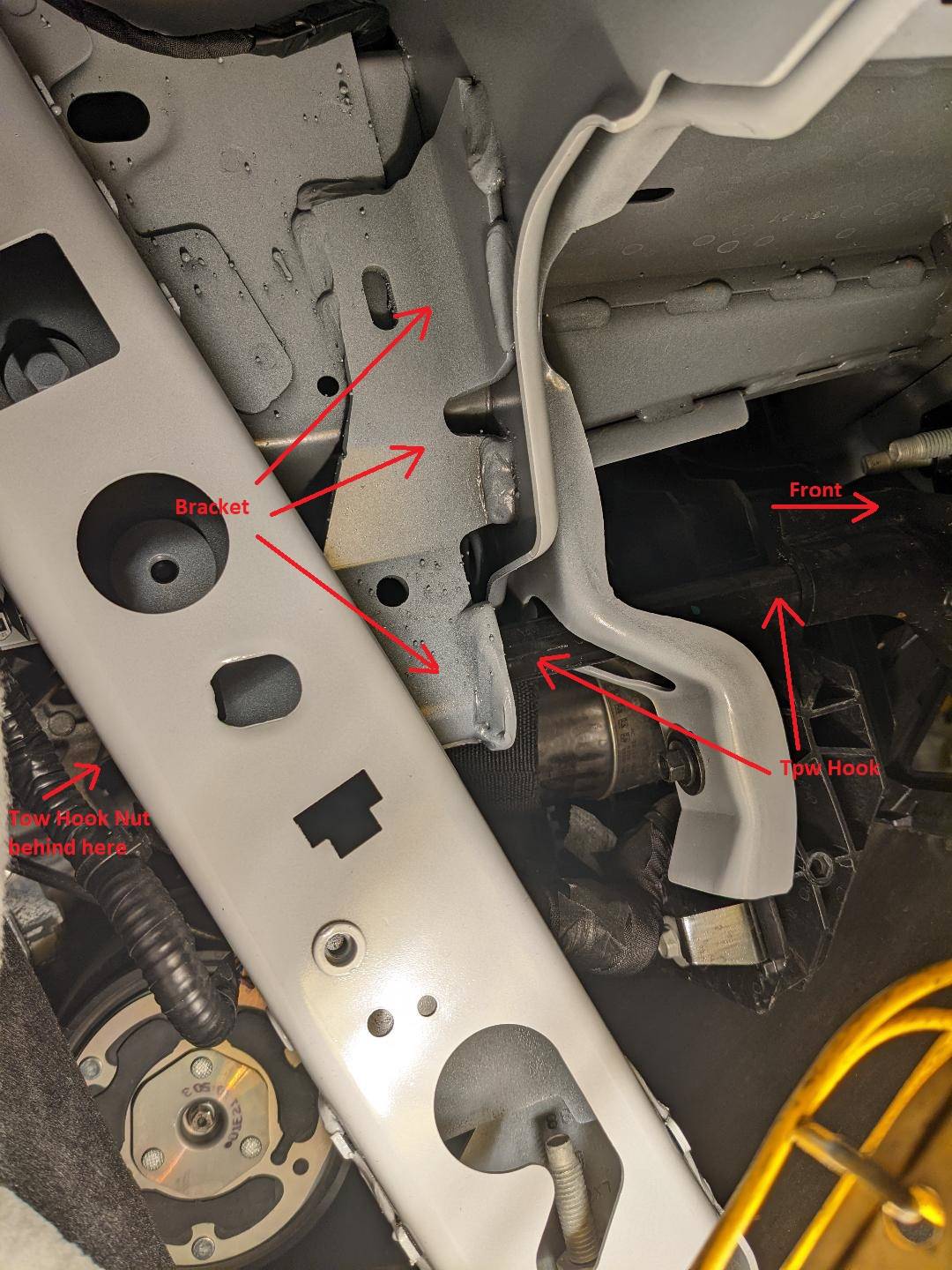

These are intended for use during an off-road recovery, so they should be able to hold some multiple of the vehicle's weight. I'm not aware of any weight limits published by Ford.
NOTE: The above would apply only to a Badlands or First Edition with factory-installed tow hooks. A portion of the tow hook bracketry for BL & FE trims is welded to the unibody structure. Other trims do not come with factory-installed tow hooks. Tow hooks can be installed, but the factory-welded bracketry is not included, so weight limits on those would be anyone's guess.

The tow hooks have substantial structure attaching rear of hook to the front frame rail on Badlands. So I would have confidence they can with stand a hard yank.
Ford Bronco Sport How much weight/torque do the tow hooks sustain on the frame? Tow Hook Bracket Annotated
