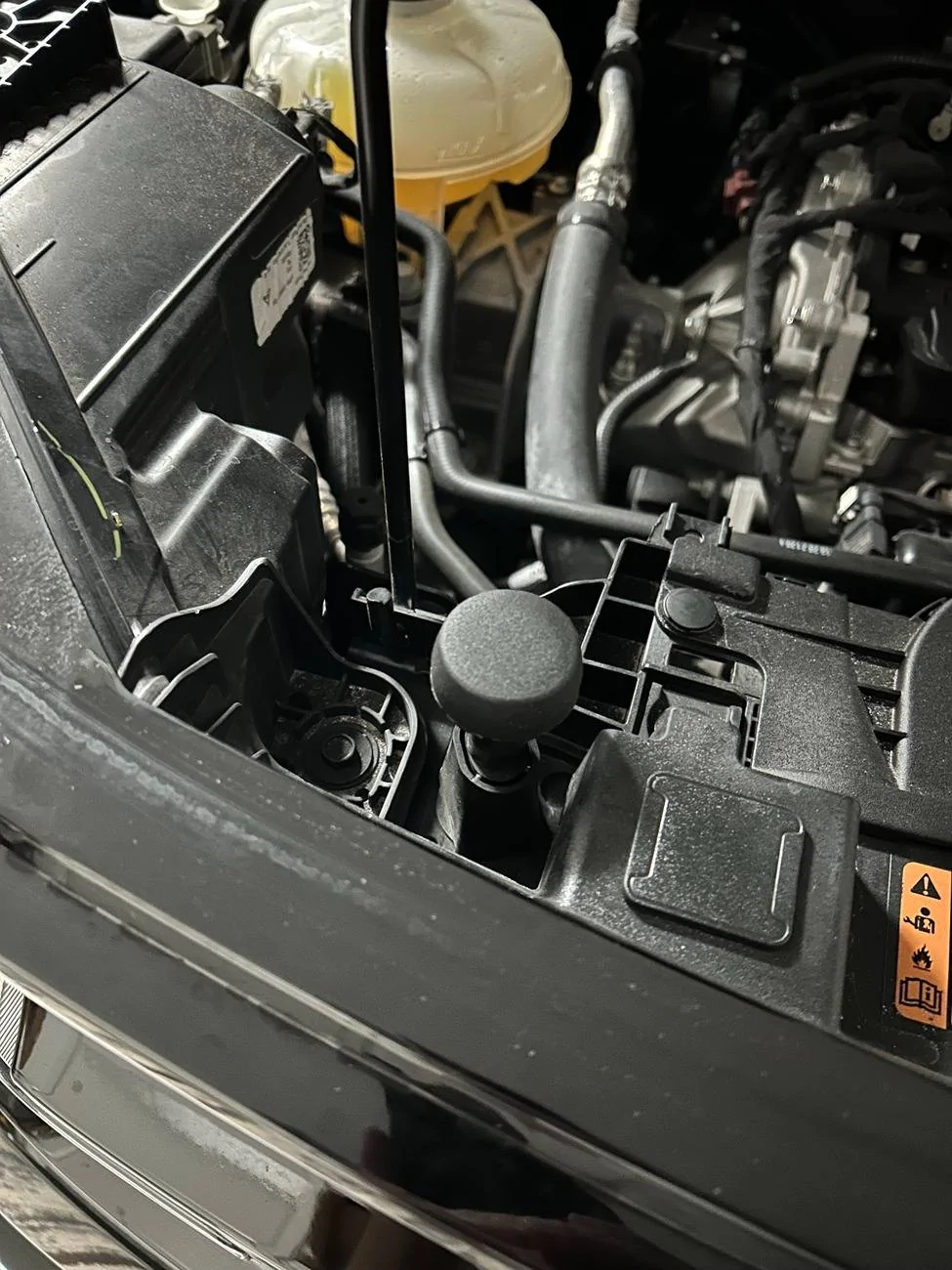

I tried the 1/4" fuel line, and adjusting the 4 bumpers, it did help a little bit. I'm going to order 5/16" on Amazon as a final try.
What 4 bumpers?! I don't see any under my hood, 2023 BS BL, do you mind to post a picture?! #TY

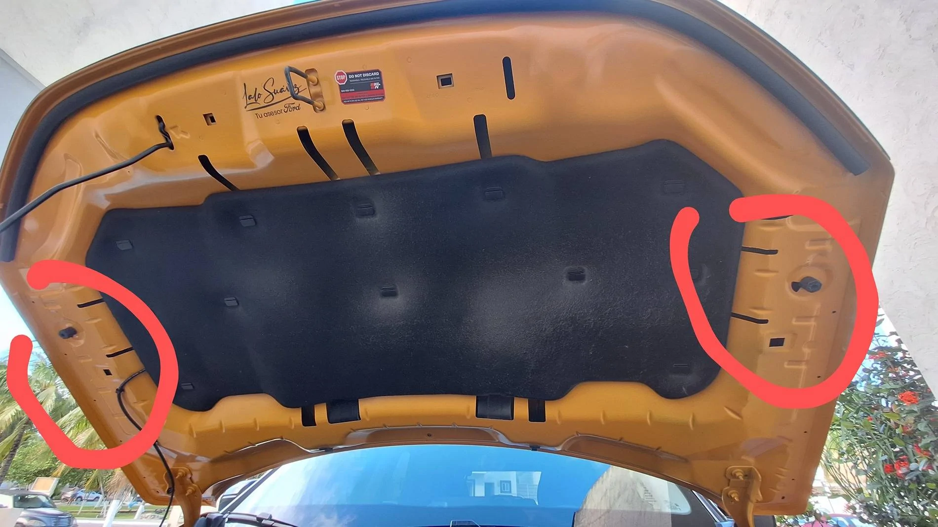

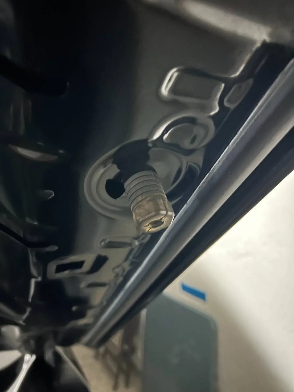

2 next to the radiator and 2 attached to the hood.

TY pal! I just went outside and open the hood! I see what you're talking about!
