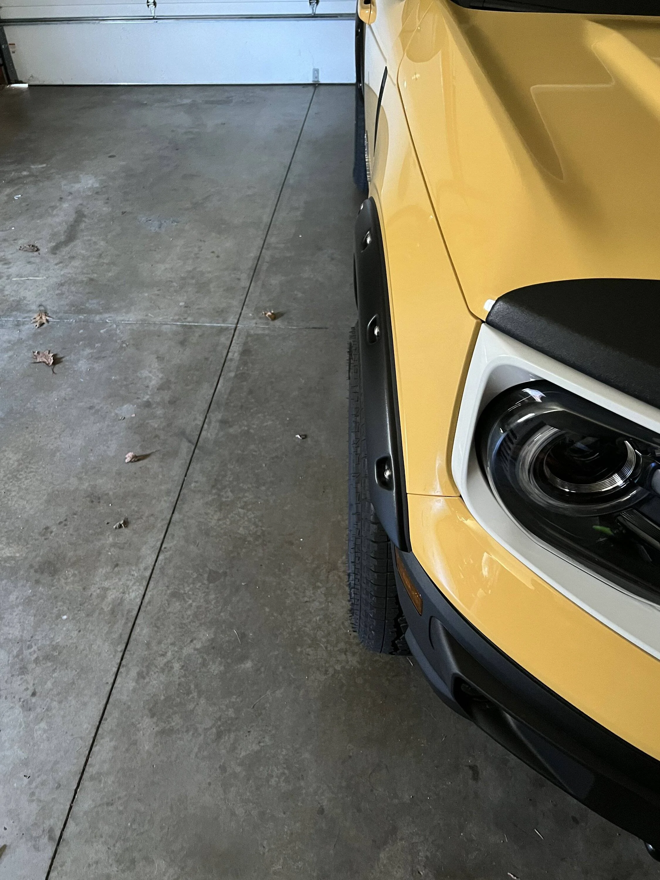

I just put in the caveat of 245’s because I have not tried it. But with the 1.25” and 235’s, it lines up with the outside of my bushwacker flairs, which is what I wanted. As for ride quality, I’d say it is a definite improvement. The stance is only slightly wider but it feels more grounded too me.
I suck at pictures but here you go.
Ford Bronco Sport Help me understand 245/65 17s on stock wheel. EEA209C9-0BF2-4484-91CA-5F052675A949
