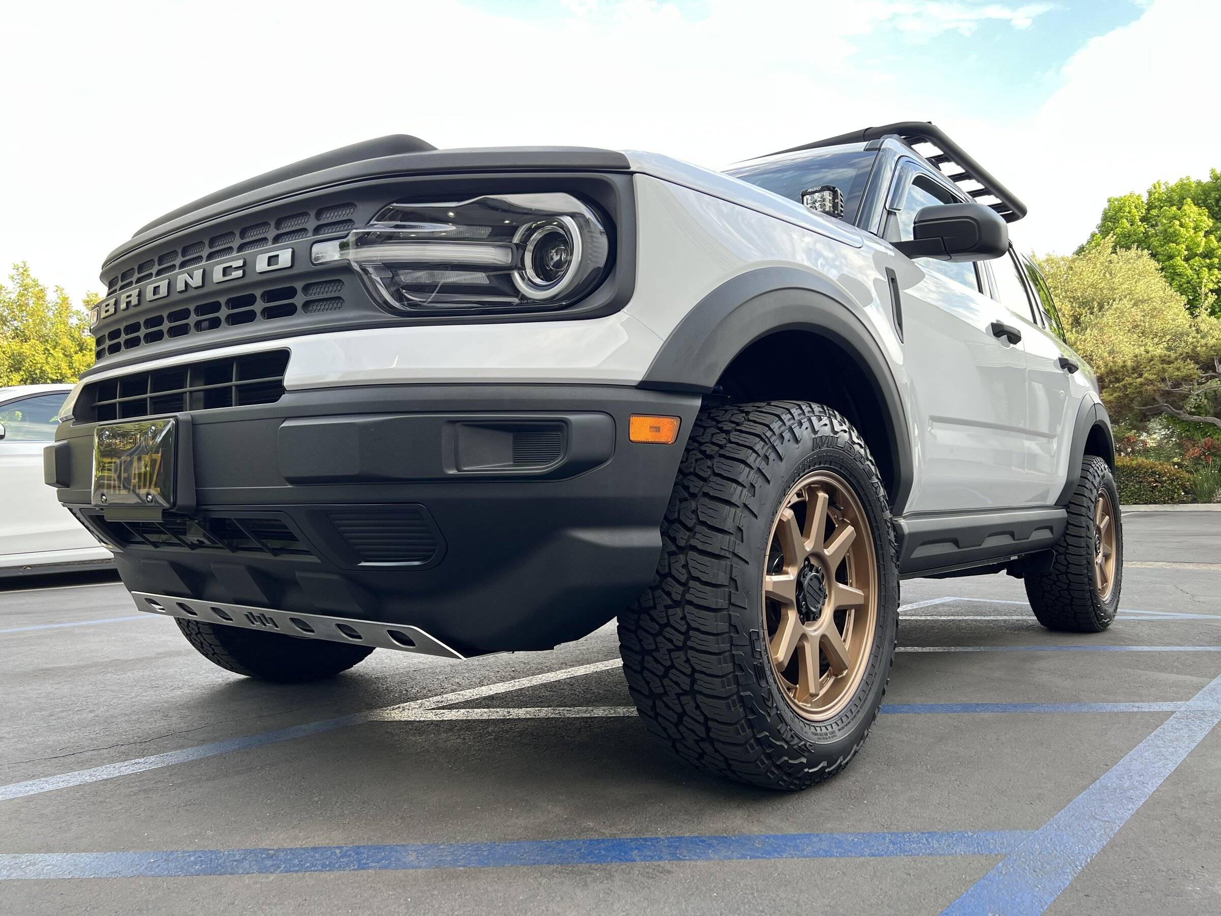

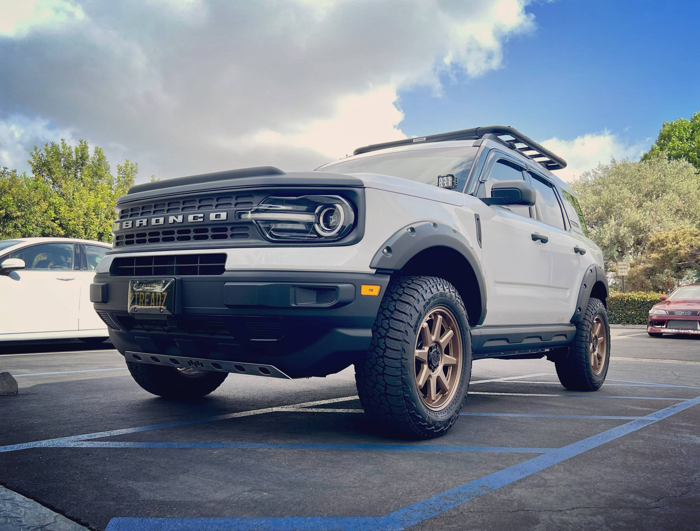

Love the springs. No clunk anymor.
I switched out my flares over the weekend.
Ford Bronco Sport H&R springs? 2E9423B3-5259-4B26-BD68-C4B32163A0B7
What skidplate is that? I found it. Rally Innovations.
