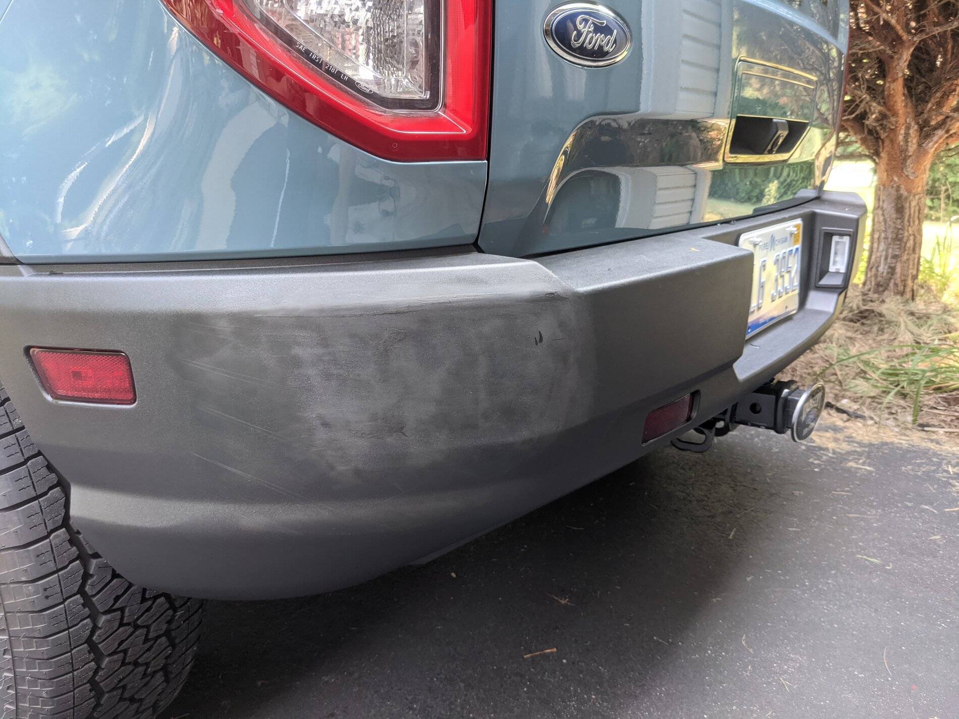

Ok so I went 320grit wet sand to cut the rough edges and get a smooth surface after a thorough wash to ensure I wasn't grinding dirt into the plastic.

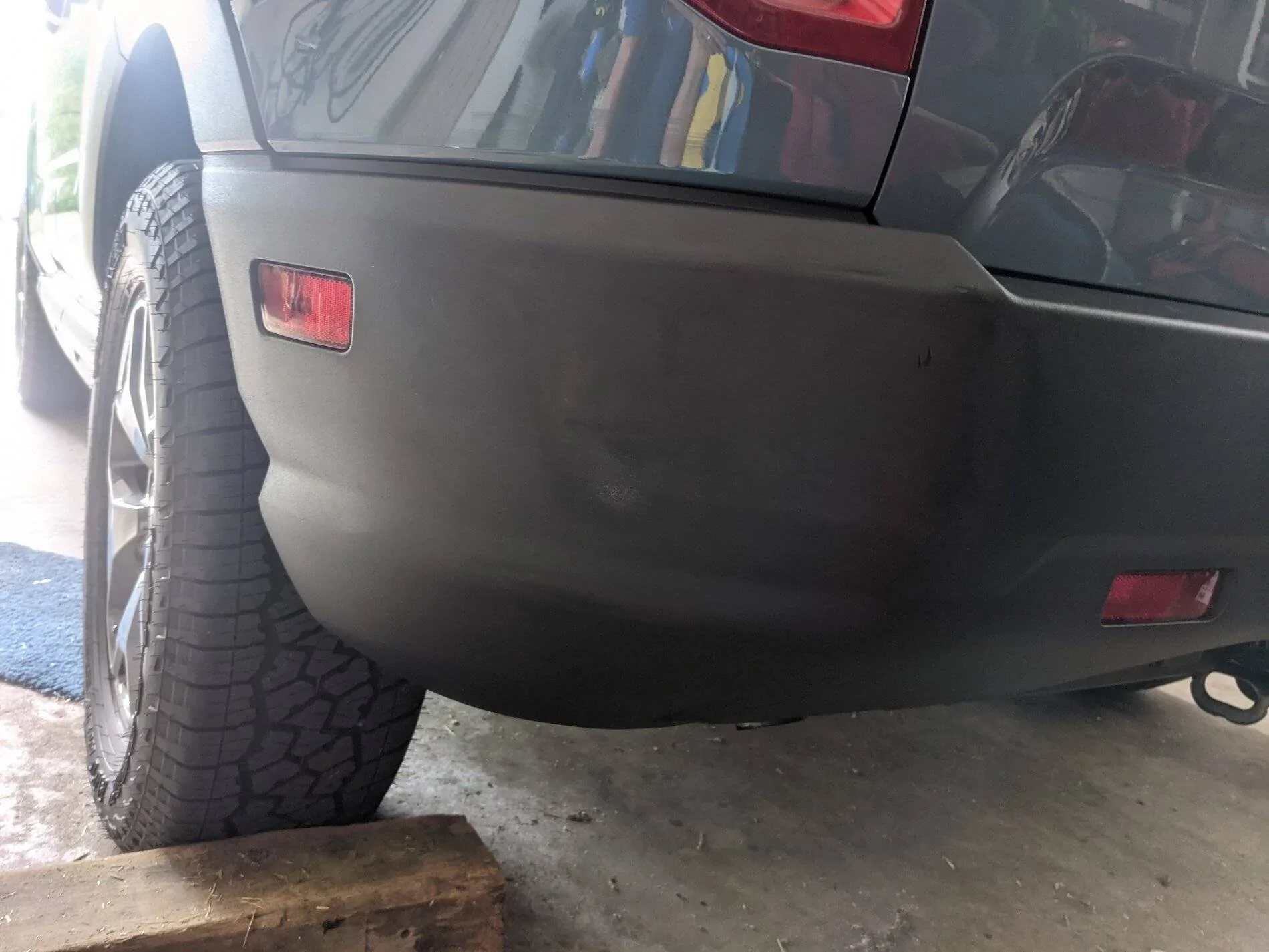

Used the heat gun had to set it to the high temp and it quicky started to smooth and draw out the oil and darken the plastic. Also took some time to smooth some rough patches.

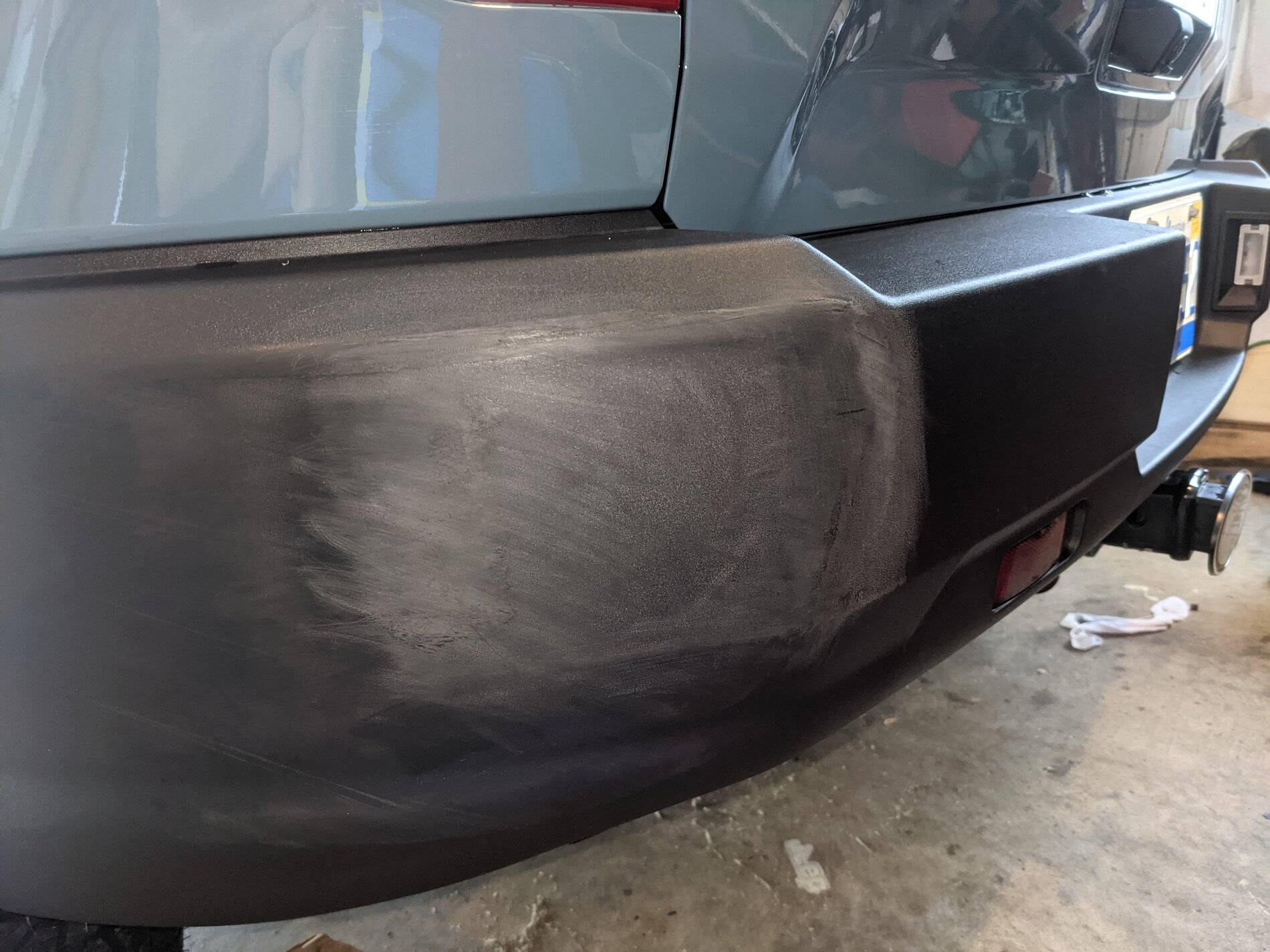

Continued heat gun and applied ceramic
Ford Bronco Sport Got past the dreaded 1st scratch ! PXL_20210808_203258359
Plastic was getting hot so I stopped for today, going to try more heat later and some plastic restore. It will be better than it was and....it's a bronco now.

Keep in mind I'm not a car guy... would you need to do that to the entire bumper or just to the scratched up area? Asking from the stand point of blending in whatever you plan on applying next.
2,730
4,455
Well from my perspective it was a huge area and some deep scratches. I'm trying to blend it and not looking for perfection...is what it is. Sucks but it's an off-road vehicle. I want it to look nice but someone decided to &$#@ me instead. Frustrating. I go out of my way to park as far from anyone as I can. Always someone who goes out of their way to be an A-hole.
