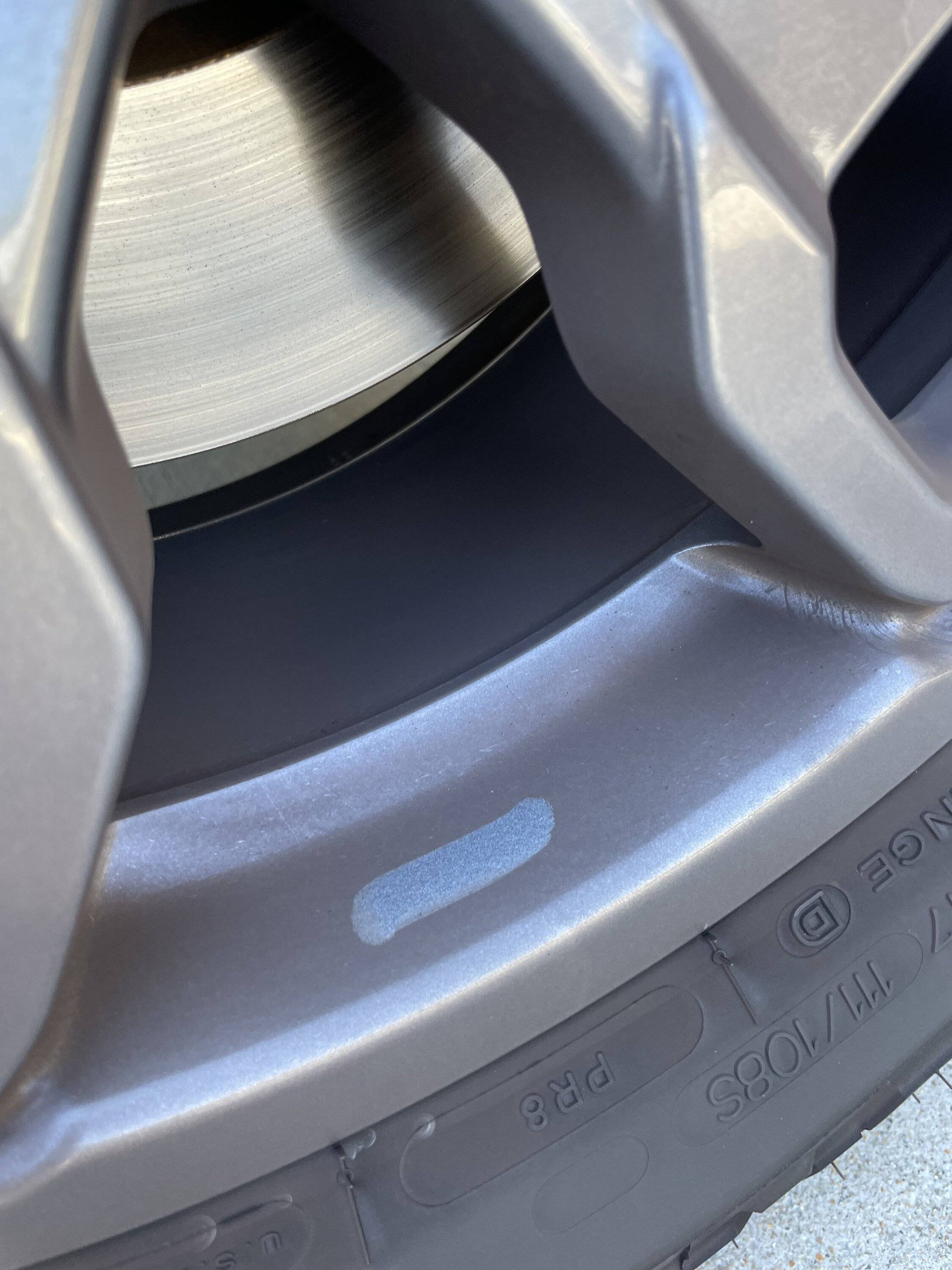

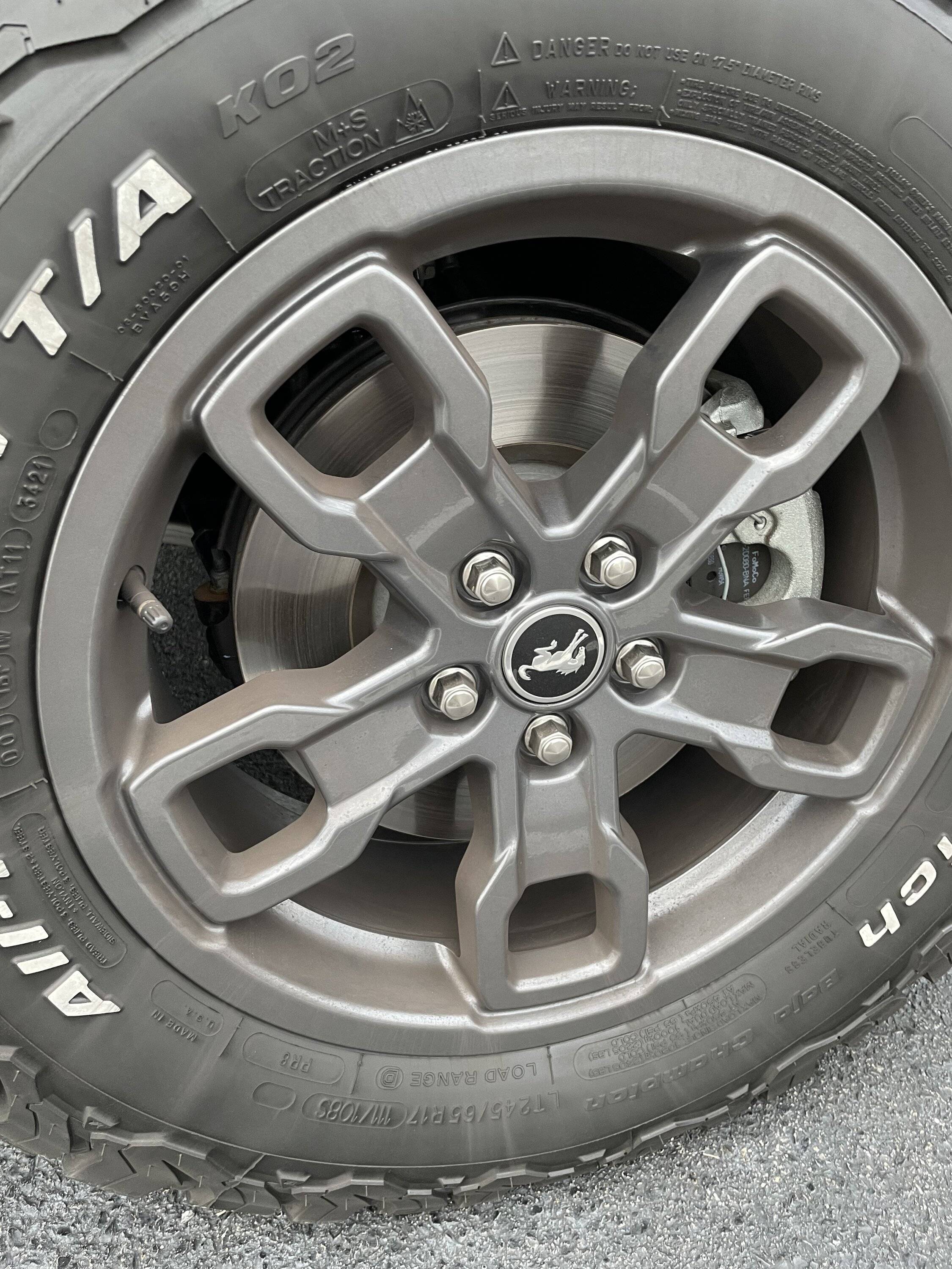

I had my recall on the brakes completed as well. My Lord the amount of brake dust they throw is nuts. Miss the factory pads. Never had an issue with the factory pads and wheels were hardly dirty by the end of the week. The new pads make my wheels look 20 shades darker lol.

I had my recall on the brakes completed as well. My Lord the amount of brake dust they throw is nuts. Miss the factory pads. Never had an issue with the factory pads and wheels were hardly dirty by the end of the week. The new pads make my wheels look 20 shades darker lol. [
It’s your car; put whatever pads you want on it. Replacing the pads is a fairly easy job. A local shop should be able to do it for less than $100.
