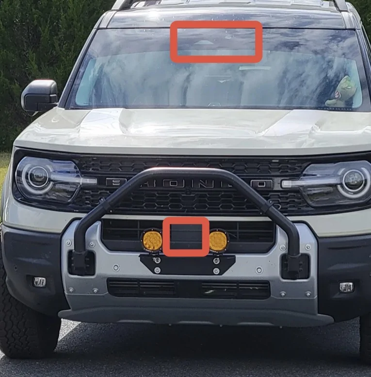

The Google AI description:
“The Ford Bronco Sport uses a front collision sensor system called
Pre-Collision Assist with Automatic Emergency Braking (AEB), which uses radar and camera technology to detect potential frontal collisions with vehicles and pedestrians. If a collision is likely, the system provides audible and visual warnings and can automatically pre-charge the brakes or even apply them if a collision is imminent to help avoid or mitigate impact. The sensor is located behind the grille in the front bumper, while the camera is mounted near the rearview mirror
And showing how to clean them:
Thanks, I will check around the front again to see if I can see anything. Otherwise I might just leave it, the beeping is annoying but its just another feature i didn't even want anyway.
